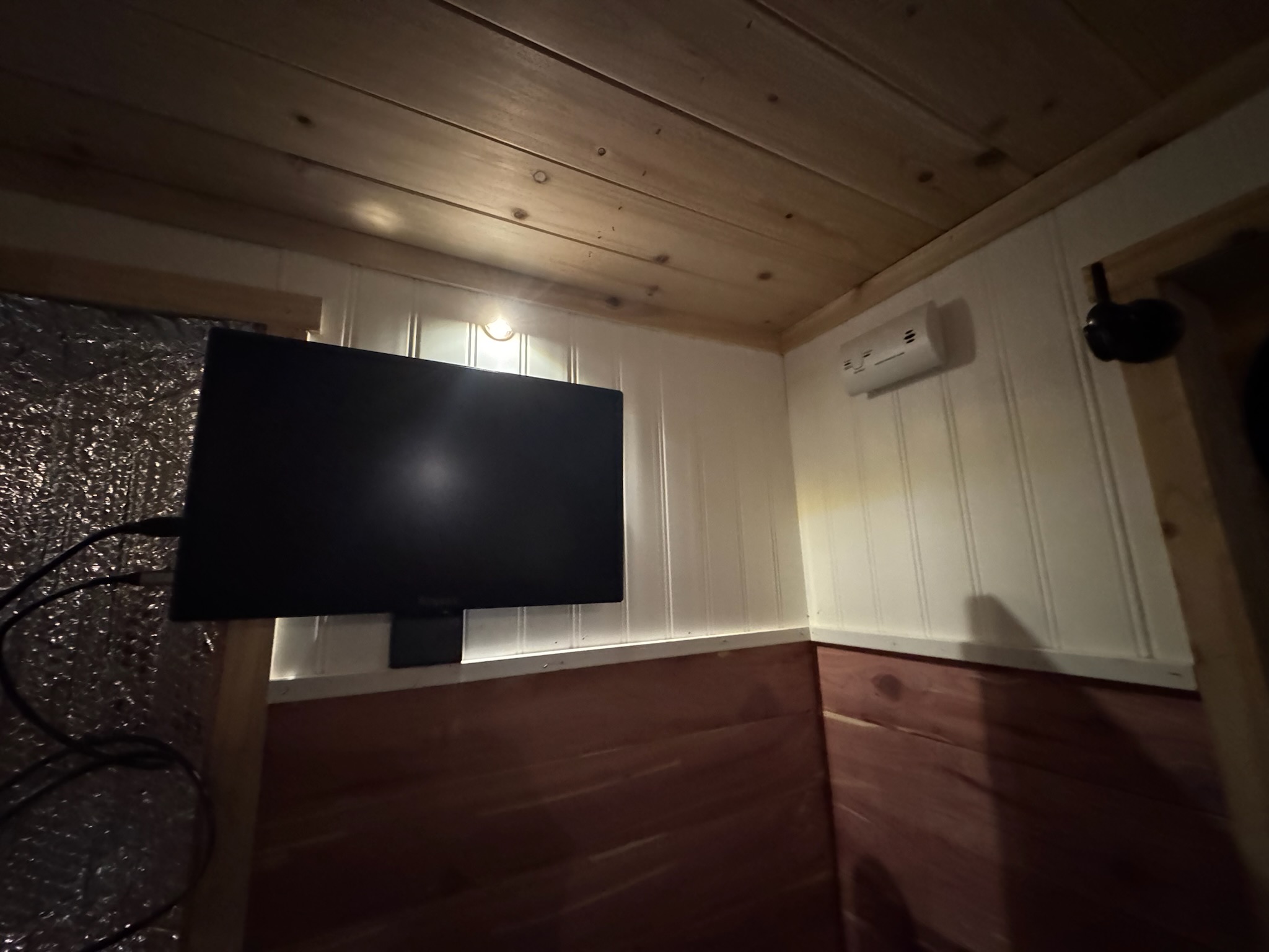

Thanks to Reaver, I picked up a USB-C powered monitor. I got this on Black Friday for less than $50. Since this is after I ran wires, I decided to employ a backpacking battery. I velcro'ed the battery behind the TV, and while working yesterday I let it run for an hour, running a movie from my phone (using an Acer USB-C to mini HDMI adaptor from my phone to the TV). It only took the battery down 5%. The volume is quite low so I ordered a USB-C powered soundbar, that will also use the battery and connect to the TV via the headphones port.
In this pic you can also see the carbon monoxide detector, and one of the two coat hooks we put up.
Monitor

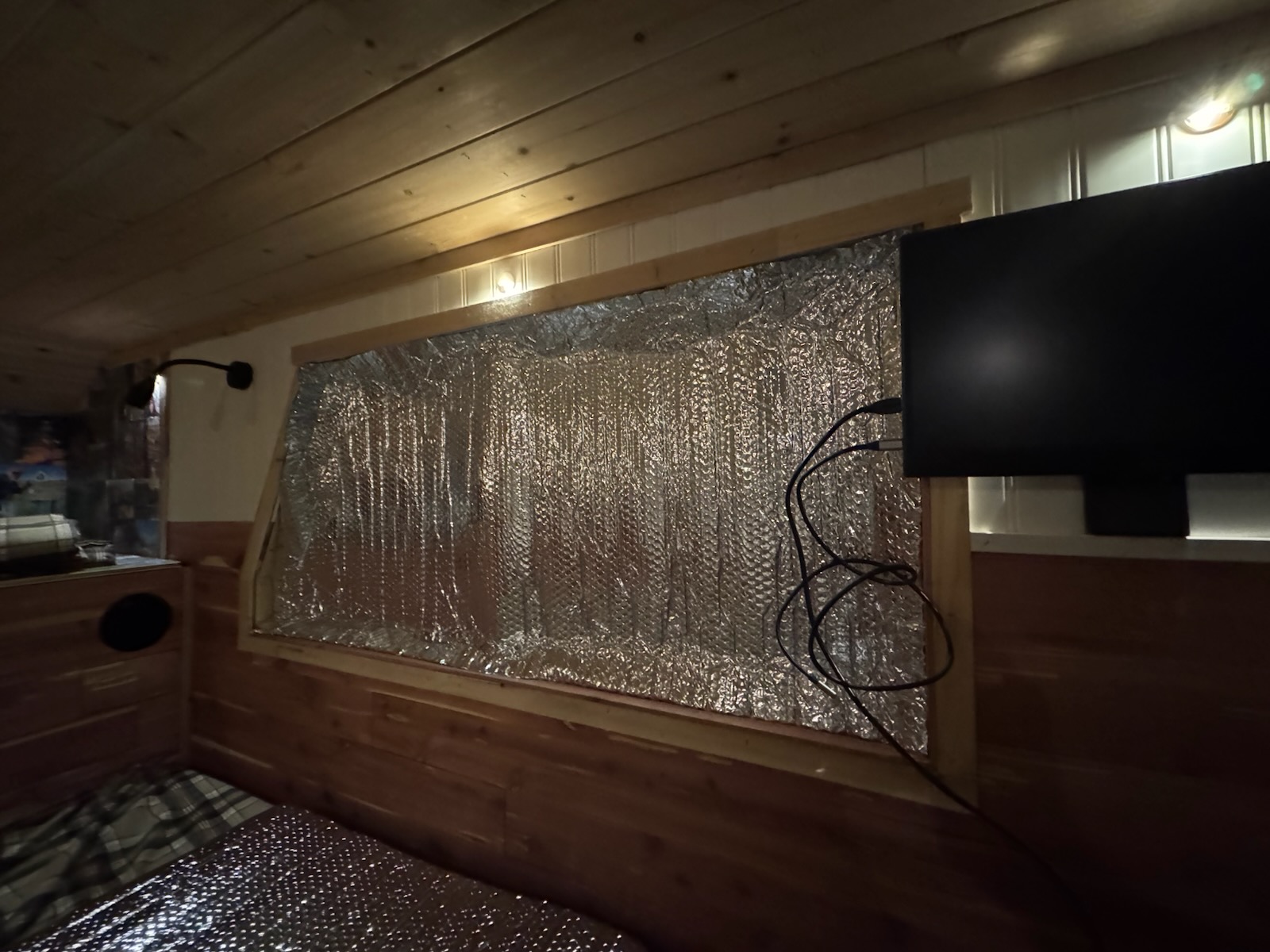

Cut some Reflectix for winter camping for the windows and door. Still working on getting some curtains.
Reflectix
