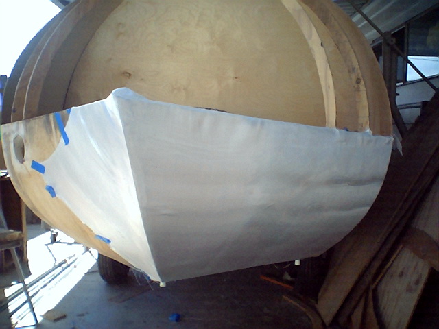

Thank you, but the fun begins when I finish this fiberglass. Mornings progress;
After lunch I need to pull th cloth tight, and add epoxy.

asianflava wrote:Oooo applying the epoxy upside-down looks like fun.
Good luck.
Not as bad as I thought it would be. Used blue painters tape just beyond the resin (trim later) and stretched the wrinkles out. Used a paint roller (thanks doug) to spread the resin.
