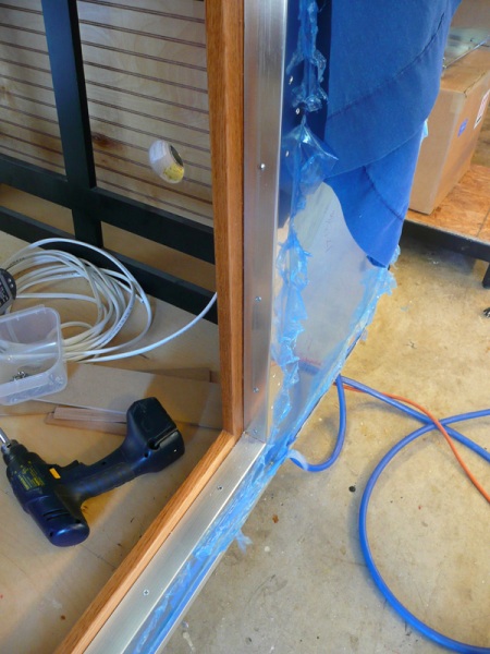

I'm using double seals on my doors. I've built some oak surrounds for the interior and will be installing them soon. The door and door opening edges will have aluminum trim. I am also using t-molding around the doors. I'll add weatherstripping on the door surrounds and on the t-molding.

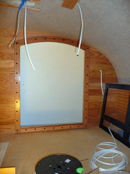

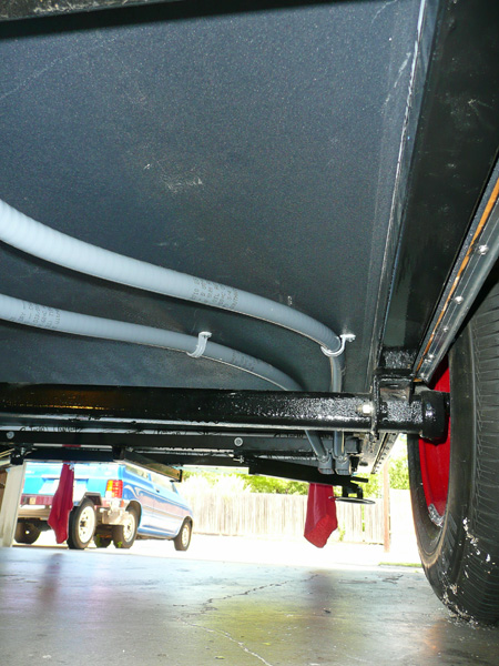

Some of my electrical wiring is in the roof and sidewalls. I did need to run 12v and 120v from the headboard cabinet to the power center that will be located in the galley. Conduit was run underneath the teadrop for this purpose.
I had already built the interior door surrounds, but needed to install them. The surrounds are a mid-build design change. I originally was going to go with t-molding only around the doors. However, I didn't trust my construction skills, and thought that t-molding only would leak. I decided to have double seals - at the door surrounds and at the t-molding. Because my interior walls were pre-finished, I didn't think I could get epoxy to "stick". So I decided to use 3M 4200 sealant between the walls and surrounds and mechanically fasten the surrounds to the walls with exposed fasteners.

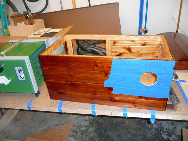

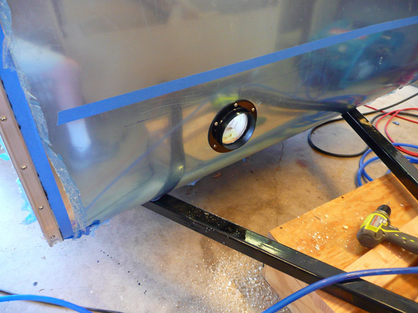

My Petcool air conditioner will be located on the tongue in a cedar tongue box. The supply air will be piped through the tongue box and front of the teardrop into the headboard cabinet. This meant that I had to cut a hole in the back of the tongue box and in the front of the teardrop.
I really didn't like the idea of cutting a hole in the front of the teardrop but it came out okay.

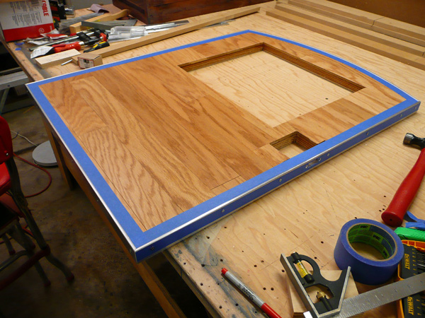

The rest of the time, I spent fitting trim. It was the same procedure - cut and fit in place, remove trim, add sealant, and re-fit in place. I added trim to the galley sidewalls, door jambs, and doors.
I still have a little more trim to install. Then I can re-install the doors, and install the seals and windows, and the Silver Beatle will be campable - sort of. Oh - I guess I better get the trailer lighting installed too.

Looking real good, Tom. I think that you win the "Excessive use of Blue Tape Award" :lol:

starleen2 wrote:I think that you win the "Excessive use of Blue Tape Award" :lol:
Scott,
I'm thinking of renaming her to the "Blue Tape Special".

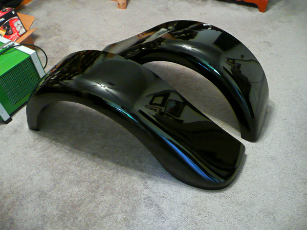

Oh, BTW...Look what I picked up from the paint shop on my way home from work today.
:thumbsup: Gig'em!
Postby 2bits » Wed Sep 08, 2010 6:34 pm
Hey Tom, I love the fenders!!! They are gonna look great on the teardrop! What do you need cabinets for?? LOL
