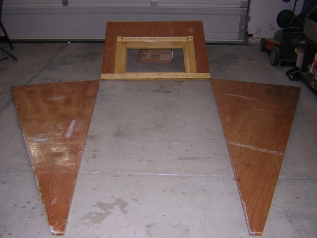

I’m not certain what you mean/are looking for, Shadow Catcher, but I’ll attempt to give you some idea of how it will become a whole.
Below is a picture of the folding sides and folding front, together:
(Sorry, they look kind mangy right now. They were the first pieces I built & I used the cheap orange box stuff on them. Those dark wood parts will be painted to match the ceiling, later.)
All of the above pieces attach to the docking lip via piano hinges and then fold inward for storage or upward to hold up the lifted roof. A picture of the docking lip from before attachment to the stationary roof is shown below.
You’ll note that the front board on the lip is not as tall as the others. That’s because the folding front attaches to that short board via a hinge and folds in first and then the folding sides fold in on their hinges and lay on top of the folded front wall.
In the above docking lip picture, you can see some rather large holes drilled into the back board, in the foreground. Fence bolts go through those holes and attach to another board that the lifting roof’s hinge is attached to. That is so the lifting roof can be easily removed for maintenance.
Does that answer your questions or did I totally misinterpret what you were looking for?
