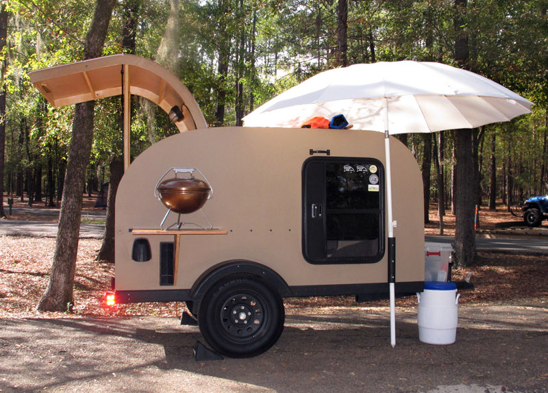

Here is a photo from LCG6 with my new umbrella holder. It gives my some cover getting in and out of the TD.
It is a piece of PVC pipe with three holes drilled in it on one side, allowing me to poke a screwdriver through to screw the pipe to the side of the TD. I painted it black to match the trailer frame. I got the umbrella from IKEA, but any umbrella will work.
I use a bungie cord to hold it down on a breezy day.

I like the umbrella mount/stand. I bet it came in handy during the rain on Thursday at LCG. That umbrella is the perfect size and height.
