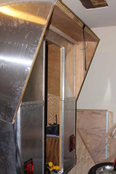

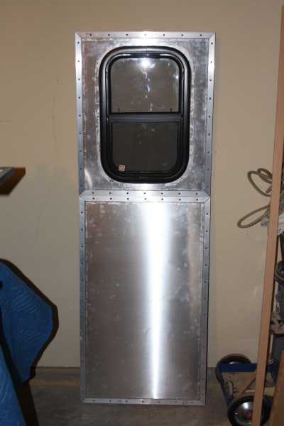

I've gotten quite a bit done this week. Here are the pics...
I skinned both the upper and lower half of the door and installed the window.
I skinned the upper half of the rear wall. It's just posing for the pic...

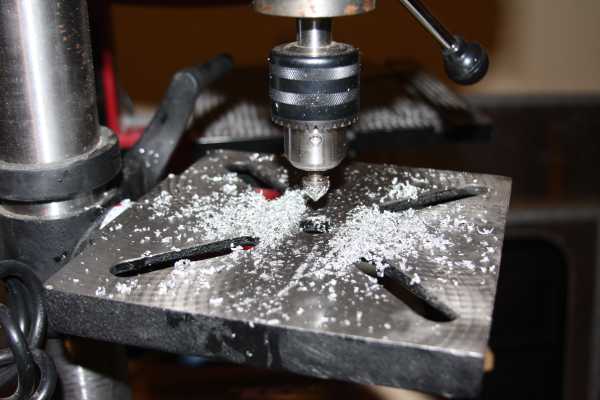

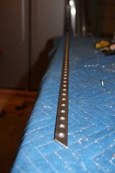

I made a couple pieces of trim to hold down my weather stripping. Each one is about 36 inches long and has a counter sunk hole every inch. I'm pretty happy with how these turned out. Not too bad for just using a $99 drill press.
It was kind of messy work...

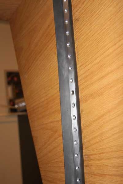

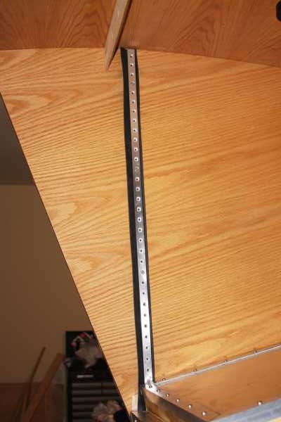

Here is the trim paritally installed. When the rear wall folds up, the edge of the wall presses against the rubber weather stipping to form a nice tight seal.
I still need to install aluminum skin of the over the wood that is on the exterior (left) side of the trim. Anything to the left of the trim will be exposed to the elements.
