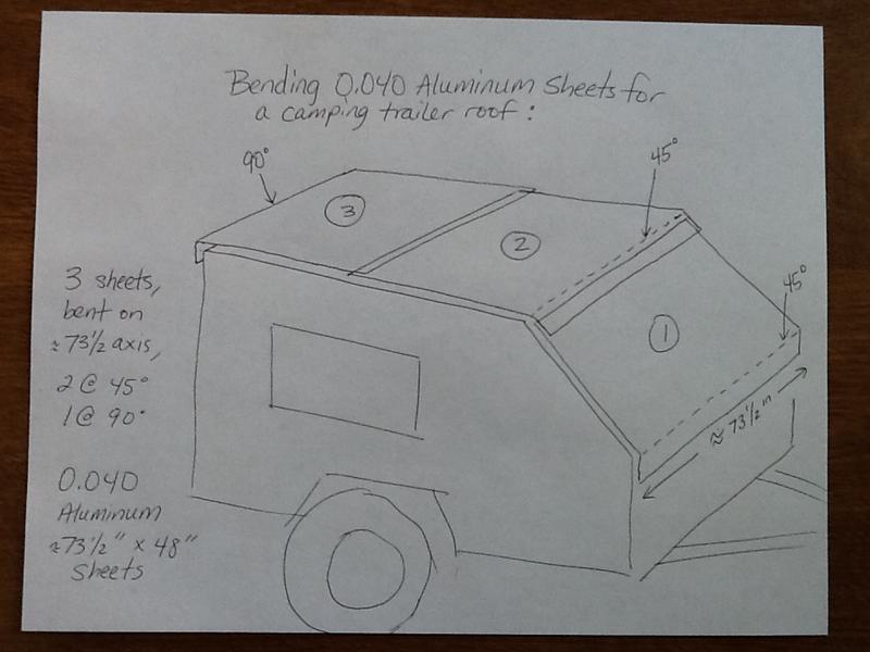

Am at a bit of a bump in the road. I need to bend three sheets of 0.040 aluminum to make the roof. The roofing brake I borrowed from a neighbor was not beefy enough to bend the sheets I have, because they are thicker than aluminum roofing material. So I called around to machine shops in the area to get an estimate for how much it would cost to make these three bends. Anyone want to guess how much I was quoted?
I'll save you the trouble. $50 a bend, for $150 total, plus tax. Does this sound crazy to anyone else? It's only 2 minutes in the bending machine for each bend. What is a reasonable price for this work? I am going to continue to call metal shops, in hope of getting a lower price quote.
In the meantime, does anyone have any suggestions for bending these sheets myself? I tried a rubber mallet on a piece of scrap and it doesn't look good at all.
EDIT: I created a separate thread for this question in the Skinning Secrets section.
