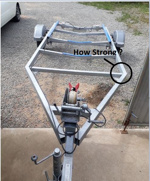

I've always had a little niggling doubt about the drawbar attachment. Its a boat trailer, so two side rails run forward and take a bend to form the drawbar.
Trouble is, the bend is formed by cutting out a wedge of material and bending the rail and welding it. It wasn't me who did it, and I wasn't there when the unknown (allegedly qualified) welder did the job.
I've marked a couple of spots on the corners of the front box, where I monitor the gap between the box and the front of the cabin. I wrote the initial measurement on the box, so any time I like I can check whether the draw bar is bending up. If the bends fail and the drawbar starts bending, the top of the box will naturally move closer to the cabin.
After 435 miles of outback roads, most sealed, some corrugated gravel, hitting the cattle grids at 60 miles an hour and doing my best to take it easy on the washboard stuff, nothing appears to have moved. The gap measurement is unchanged.

Those angle cuts are fine. There is also a small cross brace installed across the angle. For no more weight than it is carrying your good.
