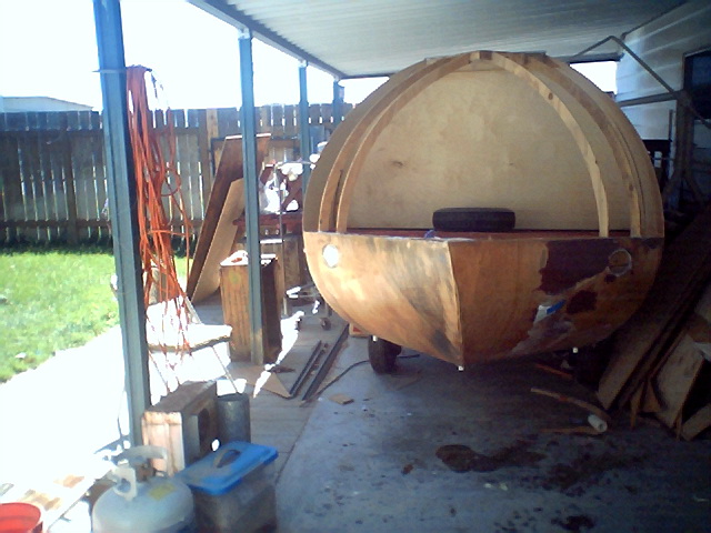

Went out and removed the tape, well most of it.
This one is under the cloth so it will be a challenge to get. Do I wait for the resin to cure and sand it out, or do I just ignore it, and bury it?
del

Postby Steve Frederick » Mon Aug 06, 2007 6:49 am
del wrote:Went out and removed the tape, well most of it.
....or do I just ignore it, and bury it?
del
Bury it!
This has been a very interesting build so far!
You're doing a terrific job!! :thumbsup: :thumbsup:

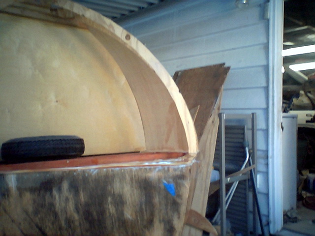

Postby del » Fri Aug 10, 2007 12:10 pm
del
Bury it!
Did that, it now has another layer of glass over it. Each side overlays the other, I did not end on the corner. It was easier to overlap. Pics to come later, seams the camera ate last nights. :x

Postby del » Fri Aug 10, 2007 3:15 pm
Here is the photo that should have been in the last post.

Postby del » Sat Aug 11, 2007 7:55 pm
doug hodder wrote:Looks great Del!! and you were wise to overlap the cloth on the rear joint...Doug
Doug I would think ending them both on one line would create a week point. Seeing words of encourage from builders who build trailers, that I think belong in a exhibit somewhere behind glass (and famous), I am honored.

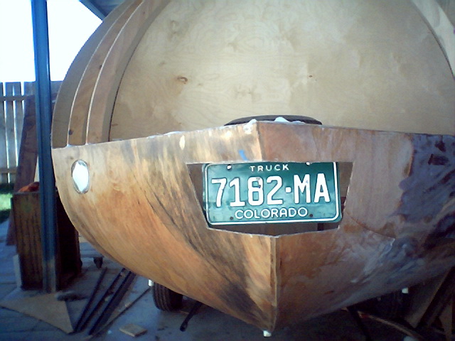

Postby del » Tue Aug 14, 2007 8:09 pm
Micro469 wrote:
Your tear is unique.. :thumbsup:
It is indeed.
Today I cut out the spot for a tag.
The sides are square with the counter, and I do not like it. Now I have to make it appear strait when you stand behind it. Ideas would be a blessing, and I would be most thankful.

Postby Bobgorilla » Tue Aug 14, 2007 8:52 pm
:thinking: Del, the only thing I can think of is most states will allow an offset of tags on trailers (think boat trailer always on 1 side) maybe you could move it to one side and keep the shape? :thinking:

Postby doug hodder » Tue Aug 14, 2007 9:02 pm
Del...I'm sure you thought of this...now just make up a cardboard template for the pieces of the license plate inset, and tape them together...see how it fits...then cut the pieces out of thin ply and glass/epoxy away, If you want to get it looking more to your liking...get a felt pen and start drawing lines and view from behind. Only one chance to cut it without a lot of extra work...I really like the depth to the recess you have, really a nice touch!!! Doug
Postby del » Tue Aug 14, 2007 9:59 pm
Bobgorilla wrote::thinking: Del, the only thing I can think of is most states will allow an offset of tags on trailers (think boat trailer always on 1 side) maybe you could move it to one side and keep the shape? :thinking:
The latch for the hatch will be tucked up in there, so it needs to be centered. :shhh: The latch is a secret.
