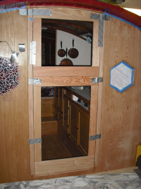

I started making the door this morning. The plan (I've got no plan :lol:) is to build a dutch door with a cross-buck lower door and the upper door will have a 2 pane awning window.

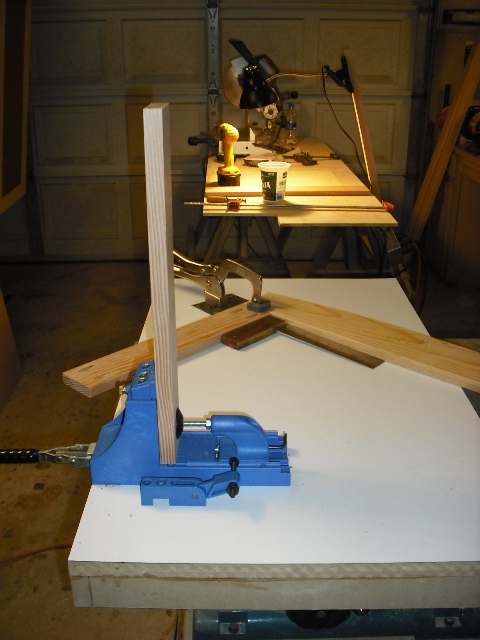

Oh boy! I get to use my pocket hole jig.
I found a new use for duct tape.

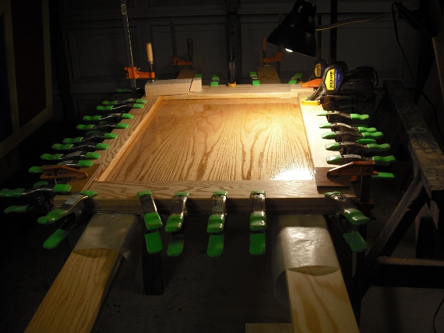

The lower door; 2 layers of 5.2mm red oak plywood epoxied back to back with the frame on the outside, cross-buck pieces will go in next.
Steve

The dutch door looks nice so far. You don't plan on towing that in a driving rain do you? :?

mikeschn wrote:The dutch door looks nice so far. You don't plan on towing that in a driving rain do you? :?
I prefer not to tow my little campers in the rain, but in the event that it does, I hope my efforts make it somewhat moisture resistant. I figure the faster I go the more pressure on the door and gaskets surrounding it. Whatayathink? I think it'll be a leaker for sure. Now you know what the duct tape was for. :lol:

Never had to flee, :worship: hope I don't. Boarded up the house 3 times in 2004 and watched 4 hurricanes pass by.
I fit the door last night. The side opposite the hinge has a clearance of about 0.025 - 0.035 of an inch, will have a foam seal behind that. That might slow water ingress a little.

Now that's what I call Precision work.............. :lol:

Thanks John, on some things I try to work to close tolerance, and sometimes it works out. Amazing what you can accomplish with dial calipers and a pair of reading glasses :lol:

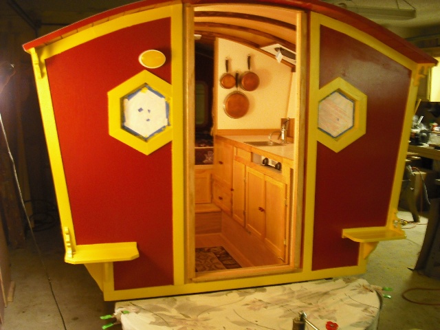

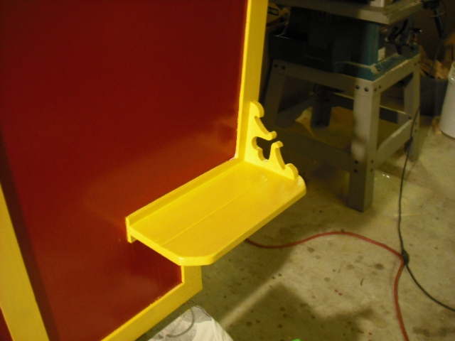

Here's a couple of pictures from tonight.
