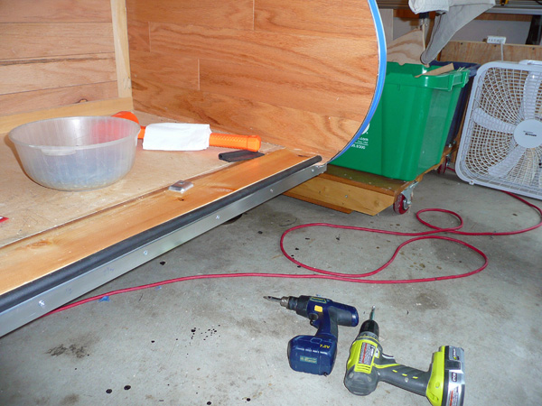

My mantra lately has been trim work, sealing, trim work, sealing, etc. Where my hatch abuts the lower edge of my galley floor, I installed "P" shaped weatherseal.
I then capped the lower leg of the seal with some aluminum trim to give it a finished look.

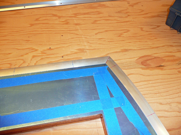

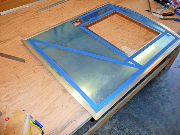

Then it was time to finish up the door trim. I'm using double seals at the doors - interior door surround and seal to for the inside weatherseal and t-molding and seal on the outside of the door for the outside weatherseal.
I was dreading trying to fit the t-molding, but the first and second pieces went on okay.
The first cuts were simple 45-degree miters. After that it was time to figure out how to fit the miters where the arched top part of the door met the two vertical sides. After a lot of trial and error, inspired utterances, and teeth-knashing, I got it done.
One door down - one more to go.

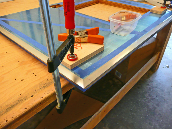

Today I finished fitting the t-molding on the second door. I then removed the trim from both doors, applied sealant, and reinstalled the trim.

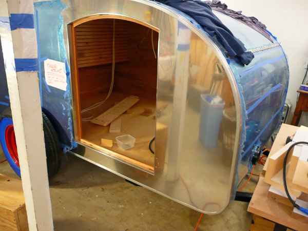

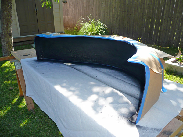

Next up were the fenders. They had been painted, but I wanted to apply undercoating on the bottom side. I masked off the fenders and then sprayed the rubberized undercoating.
By then it was late afternoon. Thomas (2-bits) came by to check on my progress and help motivate me to get this thing done. :beer:
After some contemplation, we decided to pull off the protective plastic on the aluminum at the front of the teardrop to get an idea what it's going to look like.
:thumbsup: I'm happy with the way it looks. Thanks for coming by Thomas!

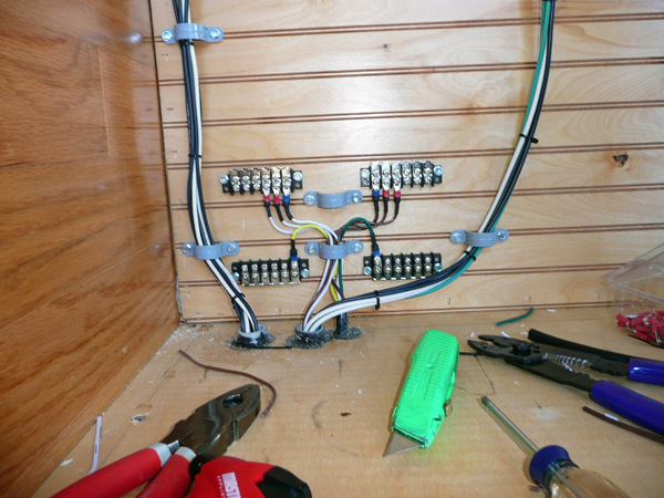

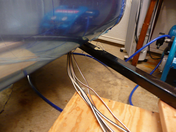

I'm still making the push to be campable by LCG V even though the date is fast approaching. Can't make the trip without trailer lighting, so I started my electrical work. Previously, I had installed conduit below the teardrop from the front bulkhead to the galley. So, I started pulling wires, and pulling wires, and...
I've not had good luck with trailer wiring in the past, so I am going overkill on the teardrop trailer wiring. A separate power and ground is run to each light. All the trailer lighting "meets up" at the galley bulkhead. I'm using terminal blocks for each leg of the trailer wiring.

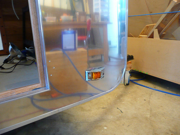

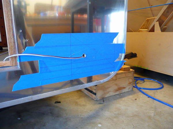

Next up, it was time to start drilling holes for the trailer lighting.

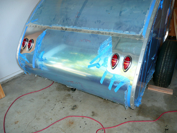

I finished the side marker lights at the front and the rear tailights.
Once I get the clearance lights and rear side marker lights installed, I'll try everything to see if it works.
