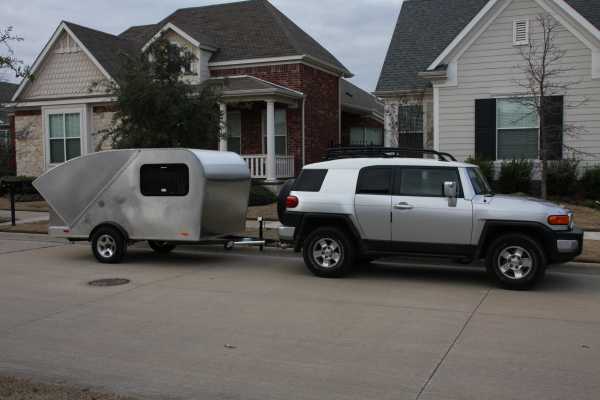

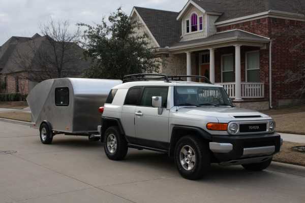

Postby wlivesey » Sat Mar 06, 2010 7:00 pm

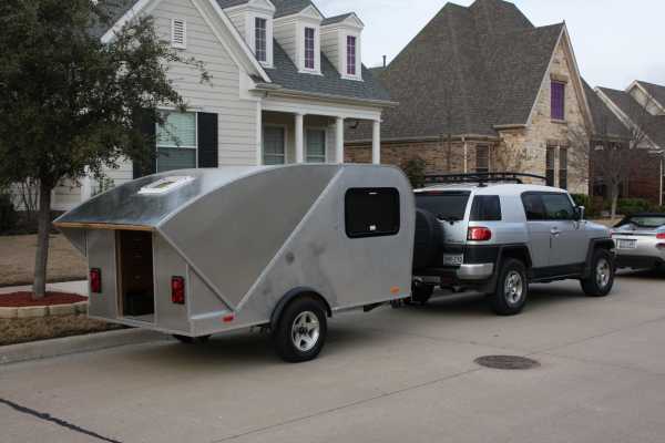

Finally more progress!!! The hatch is on and sealed. Once I get the door, roof vent and top hinge sealed it will be water tight.
We took it for a spin around the neighborhood to see how it tows. I couldn't be happier!

Postby S. Heisley » Sat Mar 06, 2010 8:44 pm
:envious: I want the trailer and the tow vehicle! Nice combo. :thumbsup: :applause:
Posts: 8866
Postby starleen2 » Sat Mar 06, 2010 8:50 pm
Guess we'll be seeing ya' at Beavers bend - looking good 8)

Postby bve » Sat Mar 06, 2010 9:18 pm
What a great looking combo. Those two pictures really show the scale of the WW well, I thought it was huge in the other pictures inside and in front of the garage, now not so much.

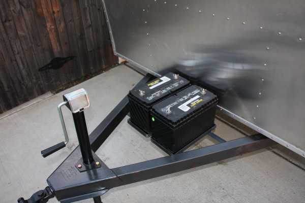

Postby wlivesey » Wed Mar 17, 2010 8:22 pm

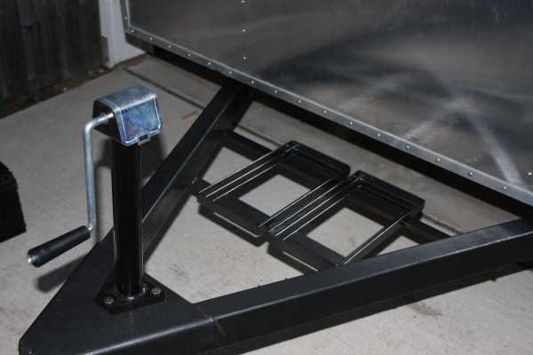

Time for an update... Some of you might remember my battery issue that I postponed dealing with. Well, the issue has been addressed. I welded up a rack to mount the batteries low on the tongue. I plan to build a tongue box to hide them.

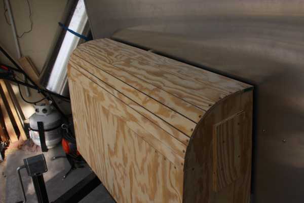

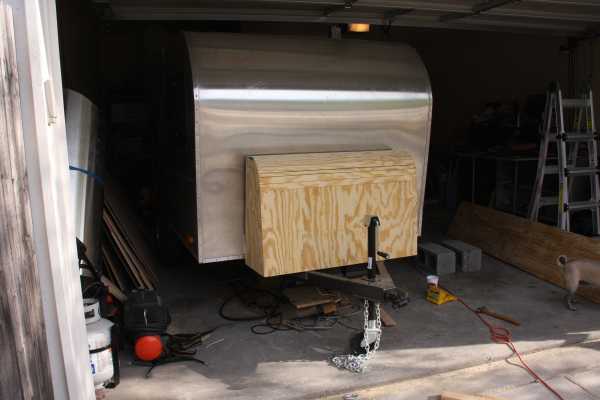

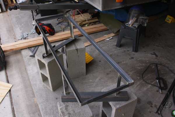

Postby wlivesey » Sun Apr 11, 2010 6:43 pm
It's been a while since my last post, but believe me, I've been working. I've been doing tons of little stuff that hardly warrant updates.

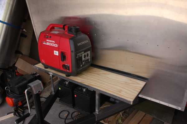

This weekend, I got started on my tongue box...
Here is the frame of the tongue box. It's puts a shelf several inches above the battery bank.
It's big enough to hold my generator and a few other odds and ends.
I also built the "shroud" that hides everything. It's open on the back, and is really just intended to hide the generator and offer a little protection from the elements.
I think I'll do a quick fiberglass job to tie the lid pieces together a bit.

Postby mikeschn » Sun Apr 11, 2010 6:55 pm
Bill,
That's coming along so nice!
How do you secure the "tongue box" to the frame, and how do you access the generator when you want to use it? Do you have to remove a couple bolts? or is it hinged?
Postby wlivesey » Sun Apr 11, 2010 7:00 pm
mikeschn wrote:Bill,
Thanks, Mike... Like I did on the chassis, I'm going to weld a few tabs onto the frame and just use carriage bolts to secure the shroud to it. As for access to the inside, the curved part is a lid that will either come completely off or hinge forward.
