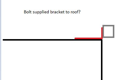

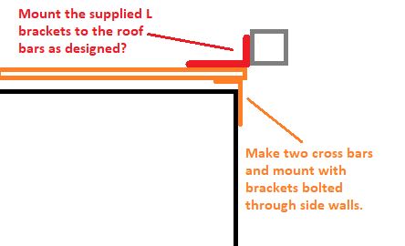

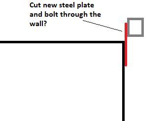

Exploring ways to mount my new awning. There are three options I can see:
Mounting option one.JPG (14.37 KiB) Viewed 2366 times
Mounting option two.JPG (14.22 KiB) Viewed 2366 times
Mounting option three.JPG (21.54 KiB) Viewed 2366 times
Leaning towards three - lots more work, but it will also spread the forces over the entire roof, and the two cross bars would make a good mount for my big solar panel.

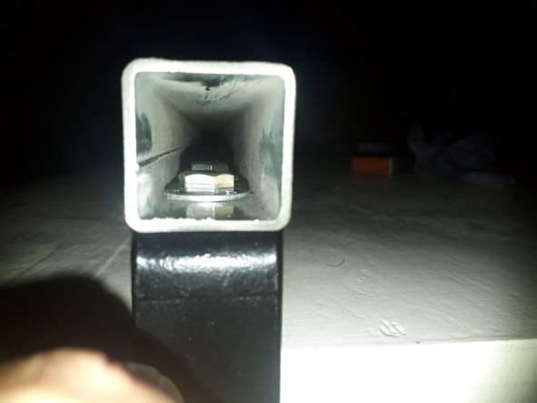

So I bolted the L brackets to the side walls, with nice flash whacko 8mm stainless steel bolts and nyloc nuts. Sealed the bolt holes with some 2 part JB weld polyurethane marine sealer I bought for my little catamaran.

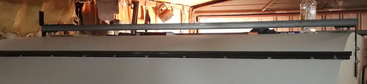

Rearmost of the two rails
Closeup of rear rail
Closeup of rear rail, awning bracket on port end

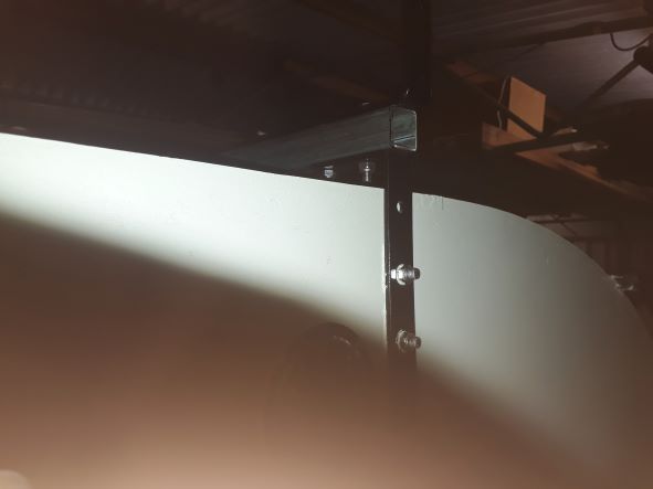

Postby MickinOz » Tue Dec 06, 2022 7:48 am
Rail attachment starboard side. Short bolts through bottom face of tube.
Short bolts with washers and nyloc nuts

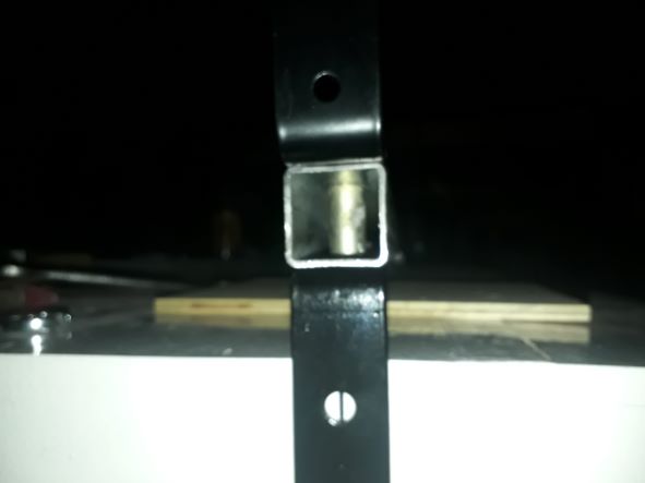

Rail attachment port side.
This side also has the bracket that came with the awning. Refer drawing three a couple posts back.
Since this required through bolting, I cut "anti-crush" tubes to go inside the tube. With these in place, the nuts can be tightened with a spanner without crushing the square tube.
Port side. Tube is bolted to lower bracket, with the bracket supplied with the awning bolted on top

Postby MickinOz » Tue Dec 06, 2022 8:02 am

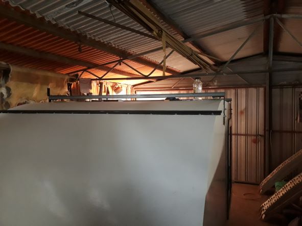

Port Side showing the bracket bolted to the trailer wall, and the awning bracket mounted on top of the crossbar.
Port end of rear crossbar. Bolted to the bracket mounted to the side wall. One long bolt is also fastening the L bracket that came with the awning.

Got the crossbars finished and mounted the awning. Pretty happy with how it all panned out.
I took the opportunity to touch up a few spots on the paint where there is a surprising amount of wear and tear for about 2 years use.

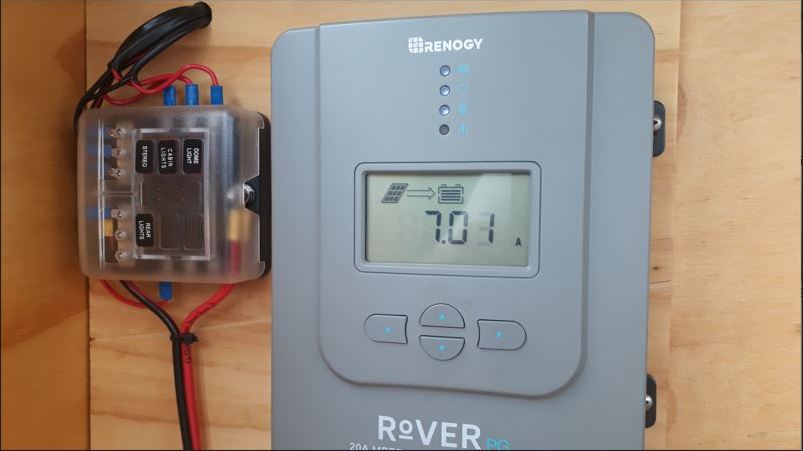

Got 7 amps from that gloomy low ceiling. At 14V, so under this very overcast sky still charging 98 watts.
Amps from overcast sky.JPG (44.24 KiB) Viewed 2039 times

So I've got a power station currently cranking in boost mode at nearly 7 amps on a very overcast day.
Short circuit current from this panel is 8.55 amps. So the MPPT controller seems to be doing its job, extracting nearly 100 watts from a 250 watt panel on a day like today is pretty impressive.
