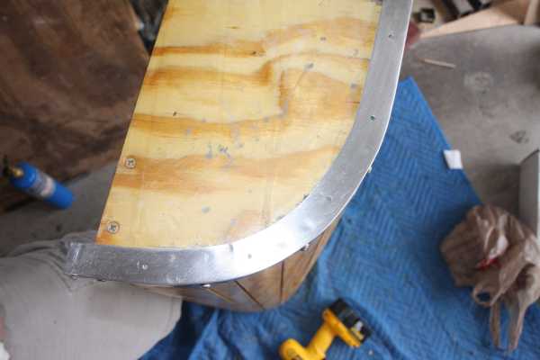

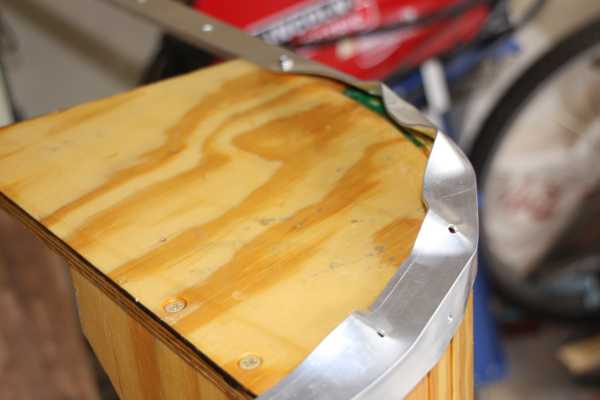

We started working on skinning the tongue box today. My wife cut all the skin pieces while I started working on the trim. I was really concerned about bending the trim around the 8 inch radius of the lid.
This is pretty much where I started. It looked hopeless.
About 45 minutes later, it looked like this. It's not perfect, but it will look great once it's all polished up.
Tip for the day: Don't let molten butyl tape drip on your skin. It might as well be napalm.

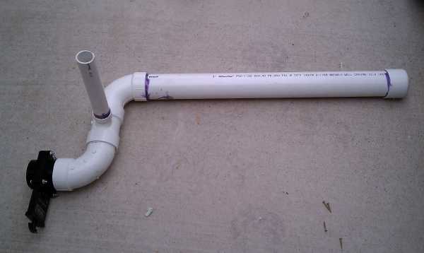

This weekend I finished up the propane lines. No leaks, no explosions so I'm happy.
I also installed my gray water plumbing. I decided to go with a hybrid - internal/external system. Even though I've got 10 gallons fresh water capacity, I don't really have room for a 10 gallon gray water tank. So instead of going with JUST an external tank, I decided to add a small 1.5 (estimated) gallon gray water tank made out of 3 inch PVC. The only time we will use this tank is at rest stops while traveling to our next destination. This way, I don't have to hook up our external tank every time we want to rinse off a plate. When we get to camp, I can just hook up the external tank and open the waste valve to empty the internal tank.
The waste valve is pretty well hidden behind the shore side tire.
Internal/External 1.5 Gallon (Estimated) gray water tank.
