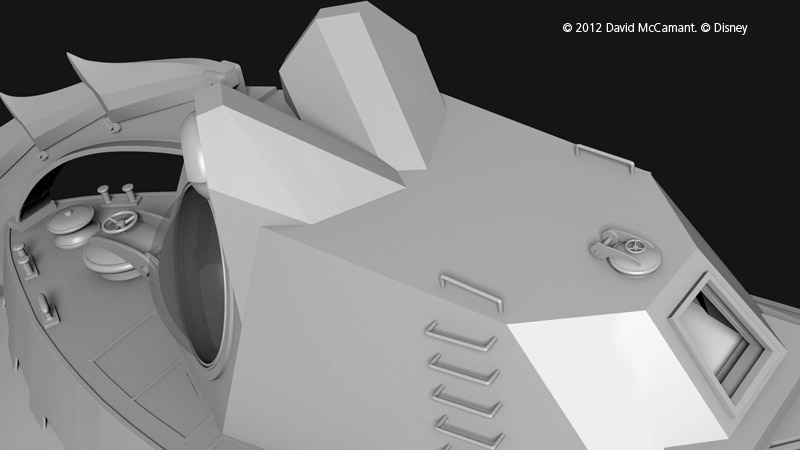

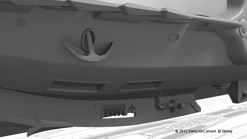

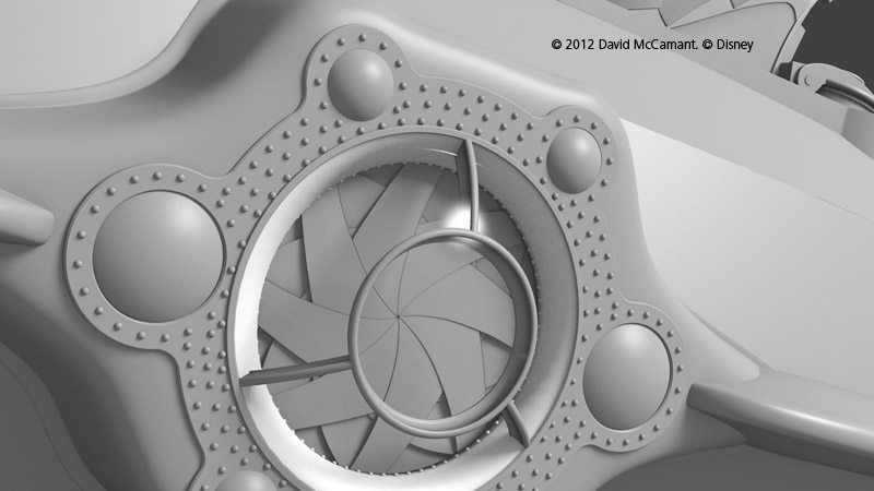

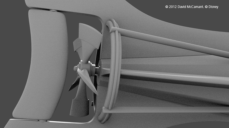

I finally got back to the build after 6 weeks of crunch work for Comic Con in San Diego. I'm now a Licensed Disney artist with ACME Archives in LA. Here are a few pics of what I've been up to, building the Nautilus from 20,000 Leagues Under the Sea as a 3D model. This is for a Nautilus Spec Plate and for a series of oil paintings I'm starting preproduction on.
This is the lower forward section.
Above the Wheelhouse.
The tail and screw.
Outside the port Salon View Loge.
