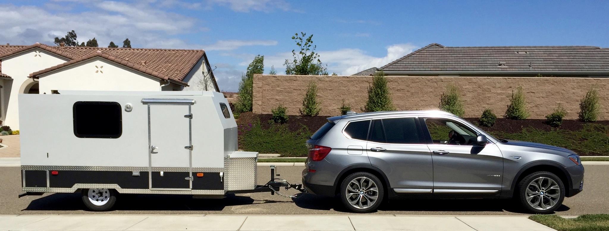

It's been a while since I posted anything about my little trailer. Last year, we left AZ for the Central Coast of California. I finally got around to painting an accent stripe around the bottom below the diamond plate belt line. I think it makes the trailer look a bit lower.
A month ago, we replaced our Dodge Durango 5.7 liter Hemi tow vehicle with a BMW X3 xdrive 28D. That little turbocharged 2 liter engine pulls the trailer much more easily owing to 1,000 pounds less weight and especially 280 ft-lbs of torque at 1,750 rpm versus 370 ft-lbs in the Dodge but at 4,200 rpm, revs I never approached.
The 8-speed transmission of the BMW vs. the 5-speed of the Dodge probably helps too. In the Dodge I got 15-16 mpg and I expect something north of 25 mpg in the BMW. We get 34 around town and on the highway when not towing. BTW, diesel costs about 50-60 cents a gallon less than regular unleaded gasoline in CA.
Perhaps most surprising change is the minimal amount of drop at the hitch when the trailer is attached. I have a lot of weight on the tongue so that I don't need jacks in the rear. On the Dodge, the hitch dropped about 5 inches when loaded. On the BMW the drop is only 2 inches.
Looking forward to my first trip with the new combo.

mike , why did you choose 22 degrees for the slant in front on your build?? thanks
tearjerker
Posts: 4
Joined: Fri Sep 15, 2006 9:41 pm
Location: Labadie Missouri
Re: Where or When Jr. --Paint & New Tow Vehicle--update 5/17
Postby myoung » Sun Oct 18, 2015 12:49 pm
tearjerker wrote:mike , why did you choose 22 degrees for the slant in front on your build?? thanks
22.5 degrees is conveniently half of 45 degrees, but i believe that my first consideration was the angle of the linear actuator at full extension. I played with the location of th pop top hinges and the headroom over the galley too. Nothing magical, it just turned out that way.

I am building a TTT with pop top. Mine is very heavy. What is the weight of your top? What are the sides made of? How do you hold it down when traveling on the highway? :thinking:
Chris
saltywalty18
Posts: 5
Joined: Sat Jan 02, 2016 6:40 am
Re: Re:
Postby myoung » Tue Aug 09, 2016 11:36 pm
saltywalty18 wrote:I am building a TTT with pop top. Mine is very heavy. What is the weight of your top? What are the sides made of? How do you hold it down when traveling on the highway? :thinking:
All the design, construction, and materials are described in the various posts to this thread. The total weight of the trailer with about half fluids is 1,400 pounds. The sides are 5mm ply over ¾-inch by 1.5-inch poplar with closed cell foam insulation. Very light and strong. The pop top has two hinges on the rear and one linear actuator centered on the front edge. The size is 4x8 and 1.5 inches (plus 2x5mm) thick with foam insulation. When the top is closed, the weight itself holds it down with probably a small assist from the linear actuator. I never gave much thought to holding it down and its never been an issue.
