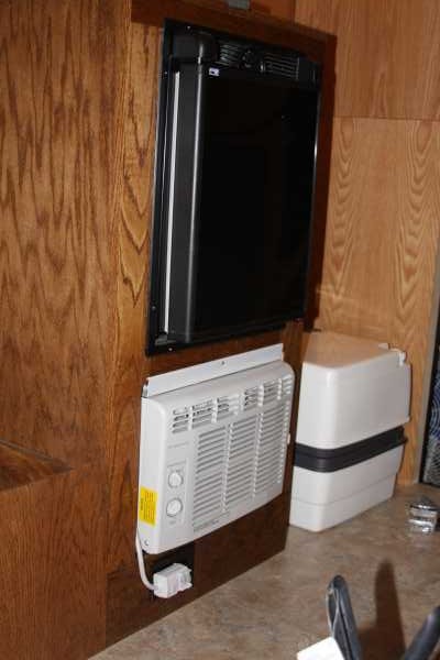

The AC problem is solved. It blows cold and does a nice job cooling off the interior.

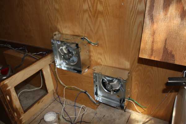

I built up a wall to separate the AC intake vents from the exhaust vents. I sealed this area with caulking and then insulated with the foil/bubble wrap insulation. Sorry, no pics of that...
I don't have much room in my AC cabinet but I managed to add a second exhaust fan which gives me a little over 100CFM of exhaust. Yes, its a little loud, but it works perfectly. It's also very well insulated (with the bubble wrap foil stuff) so the noise doesn't seem to bad inside the camper. The fans blow the hot exhaust air out over the wheel well. They are both wired to a to a switch that the AC plugs into. This prevents the AC from running without the fans being on.

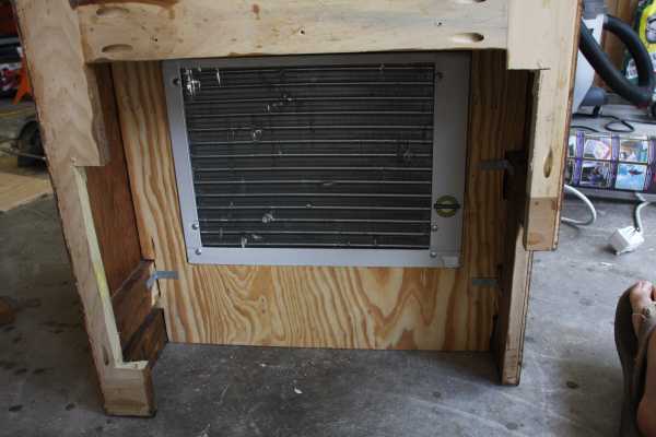

So the finished AC install looks like this...

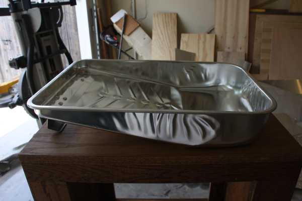

Also, to cover/protect the intake vent holes in the floor - I spotted this paint pan at Home Depot. With a few large holes drilled in the bottom of the pan, I think it will make a great vent cover for under the trailer. No body will ever see it...

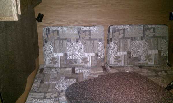

The upholstery is DONE!!! It's not the best picture - the color is kind of washed out- but I think you'll get the idea.
The backrests shown in the picture go over the table top when the dinette is converted into the bed.
We order the upholstery from http://www.slipcovershop.com. They did a fantastic job, used very high quality material, and shipped the completely custom cushions, to my specifications very quickly. I order the cushions at 9PM, and they shipped the next morning. I don't know how they made them so fast. Incredible... All for just $300 - shipping included.
: If you order anything from them, don't forget to enter coupon code SLSH for a nice discount. It saved me $50.
