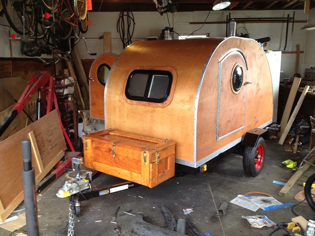

I was going to buy that Tounge box but I ended up building one instead. Here is a pic.

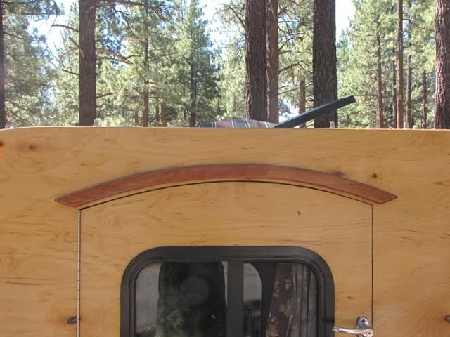

Becky, that all dounds just fabulous! Grat thme. So here s my arguement for the rsin gutters-- take it ourin the rain just once. Our first big trip out to zion park, we ad a lot of rain. Without the eyebrows, the water jst rolled in the door whenever it was openned, plus, it was forced in the top when we drove. First we put on aluminum ones, and hated the look, do randy made cherry ones to match the tail lights and inside trim. We, like you, didn't want to mess with the clean look, but decided function, as always, trumped fashion. We just had to find the right ones that idn't look ugly. The poc in the avatar doesn't have the eyebrows.

'm with Debbie and Randy. Take it out in the rain or spray the door area with a hose and see what happens. (Put some plastic over your mattress, just in case.) If the water sits up there and hits your head/mattress when you open the door, you know what to do. If the water/door is 'kind' to you, you can let it go.

Thanks for the perspective on the eyebrows. And I agree, function always comes first. So, I guess this weekend, on they go. Debbie, your eyebrows are very classy and suit your teardrop perfectly.

FWIW - I have the same doors and I sprayed the heck out of them while cleaning up after our second camping trip this past weekend. I had not previously given the trailer a good waterproofing check. During construction, I simply installed the doors with the seals against the painted side walls and no additional caulking or anything. I sprayed the water all over with a lot of force and directly into the windows with absolutely no leaks. Those doors are really well built for water tightness.

Becky, there is something to be said for what les said. Our doors were homebuilt and smooth, so when they opened, there was nowhere for the water to go but around the edge and into the door. Your doors have, as i can see, a little lip around them as it is. That may be enough to keep the water from streaming in when the door is opened.
Nothing to be lost with a wait and see plan. They can always be added, as we did.
