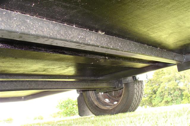

I did have one issue that I nice upon arriving home.... Looks like the tire hit the fender on a big pothole and ripped out (partially) 2 of my fender screws. We took off my fender and raised then about 1" because any higher and I wouldn't have the skeleton 3/4" ply to screw into. I obviously did not leave enough interior ply to raise my fenders high enough on bumpy roads. I only have about 2" of clearance at the moment and am looking into moving the axle below the leaf springs, but will have a large gap above the tires as a result or I can install bump stops/axle snubbers to stop upward movement. So, I am looking for advice and wondering if anyone suggests one fix over another. I already contact the RV guy who installed my leaf springs and he said he could move the axle for me if needed. Spend 200 bucks to lower the axle or can anyone recommend good snubbers? I have searched but haven't really found what I need.

I did have one issue that I noticed upon arriving home.... Looks like the tire hit the fender on a big pothole and ripped out (partially) 2 of my fender screws. We took off my fender and raised then about 1" because any higher and I wouldn't have the 3/4" ply skeleton to screw into. I obviously did not leave enough interior ply to raise my fenders high enough for bumpy roads. I only have about 2" of clearance at the moment and am looking into moving the axle below the leaf springs, but will have a large gap above the tires as a result or I can install bump stops/axle snubbers to stop upward movement. So, I am looking for advice and wondering if anyone suggests one fix over another. I already contact the RV guy who installed my leaf springs and he said he could move the axle for me if needed. Spend 200 bucks to lower the axle or can anyone recommend good snubbers? I have searched but haven't really found what I need.

I went back through your build thread to find a photo of your suspension. I probably wouldn't recommend using the bump stops to restrict the movement, as what I can see from the photo, you would be left with not much movement at all. You could end up with it thumping on the stops most of the time. Apart from a hard ride it could, in time, cause fractures to the axle or the frame where the stops are mounted. Placing the axle under the springs would be the better option as long as you don't mind having the TD sitting higher from the ground. You will be lifting it by the diameter of the axle plus the thickness of the springs. Another option to lift it, by a greater or smaller amount, would be to fit longer spring shackle plates.

A spring over would certainly help with the clearance issue....but raising the center of gravity can also cause handling changes. Do you have shocks on the current setup? If you do the SOA (spring over axle) install, you could add shocks that would help to dampen things a bit, and improve ride performance.

Assuming that you don't want to raise your floor and galley counter height too much, I'm with Sheddie on this one. A 1 inch longer shackle will add about 1/2 inch more lift.
Beyond that, you could change how the fenders are mounted. Instead of bolting/screwing them to the side wall, you could have fender brackets welded on to the under side of the frame that extend out to the lower leading and trailing edges of the fenders.

Raising the fender an inch and a longer shackle would probably be enough. Personally I would be ok with putting a bump stop above the spring between the axle and the frame. But it should be compressible like this. http://www.4wheelparts.com/Lift-Kits-Su ... YKU09006BK. and it should give you maximum travel ( have it touch the spring about 1/2 an inch before it bottoms out.

Yes KC that was also a solution I was thinking of. That is the way my guards (fenders) are mounted. I think I used 35mm x 6mm flat bar welded on its edge to the bottom of the box section trailer frame. I made sure to spread the bots well apart to give the best support when mounting the guards to the brackets. The guards sit about 3 to 4 mm away from the walls and are rigid enough not to touch the walls while traveling. They are also strong enough to hold my 90kg standing on them.

I still haven't fixed the fender issue yet. I am still considering my options.... Not sure which route I want to take yet. I am still leaning towards bump stops to stop the axle from hitting the fender. I don't want to stop al movement, but just prevent the tire from hitting the fender on big bumps. They are few and far between, but may be an issue. I know someone mentioned above about a strut, but I don't have any other suspension besides the leaf springs. I can see how it might damper a bounce if I do hit a bump though.

I don't know how the roads are up near Saranac now, but some of the roads leading up to Fish Creek were a little rough the last time I went up. Just take your time on them and hopefully the bumps won't be too bad on your fenders.
