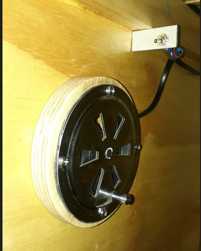

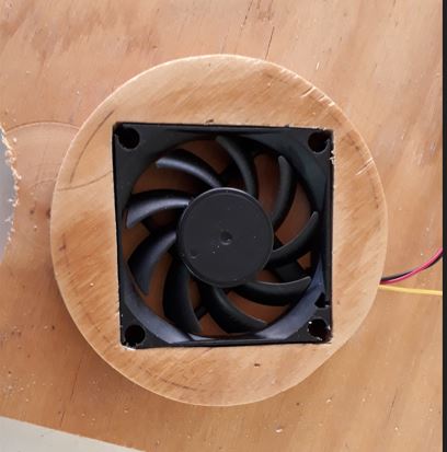

I've begun to take steps to address the condensation issue that showed up a couple trips ago.
I built the trailer with framing in place for a fantastic fan, but after a couple years of use, I'm not in favour of cutting a hole in my roof.
So I thought about it for a while and decided that, for those nights when you just have to shut the doors and keep the weather out, I would fit exhaust fans where my existing vents are.
Starting out with just one, a ball bearing computer fan.
I chose one with mounting hole spacing close to the spacing of the screw holes on the vents.
12V DC, naturally.
I cut out a circle of plywood just bigger than the vent, and the right thickness for the fan.
Mounted it so that it i blowing air out, not in. It's not my best work, but it's functional. Still have to get some clips to secure the cable.
It pumps air, though not completely silently. Current draw is ridiculously low - 0.16 amps.
I'll have to do an overnight trip to see how I like it.

MickinOz wrote:I cut out a circle of plywood just bigger than the vent, and the right thickness for the fan.
Great idea! :thumbsup:

Nice solution. New or old fan? Once the bearings go they get noisy but easy to change the whole fan out the way you have done it.

New fan. I searched for one that specified a ball bearing, many are "sleeve bearing", whatever that is.
It is mounted in the front lower vent on my side, so it's the closest vent to my head. If it pumps anywhere near the rated 54 cubic feet per minute, it should simply draw my exhaled moisture away.
I think it will last a while.
I run a computer fan on my biltong box, typically non-stop for a week, so I expect this will last long enough to justify the couple hours of messing about to design and fabricate.
