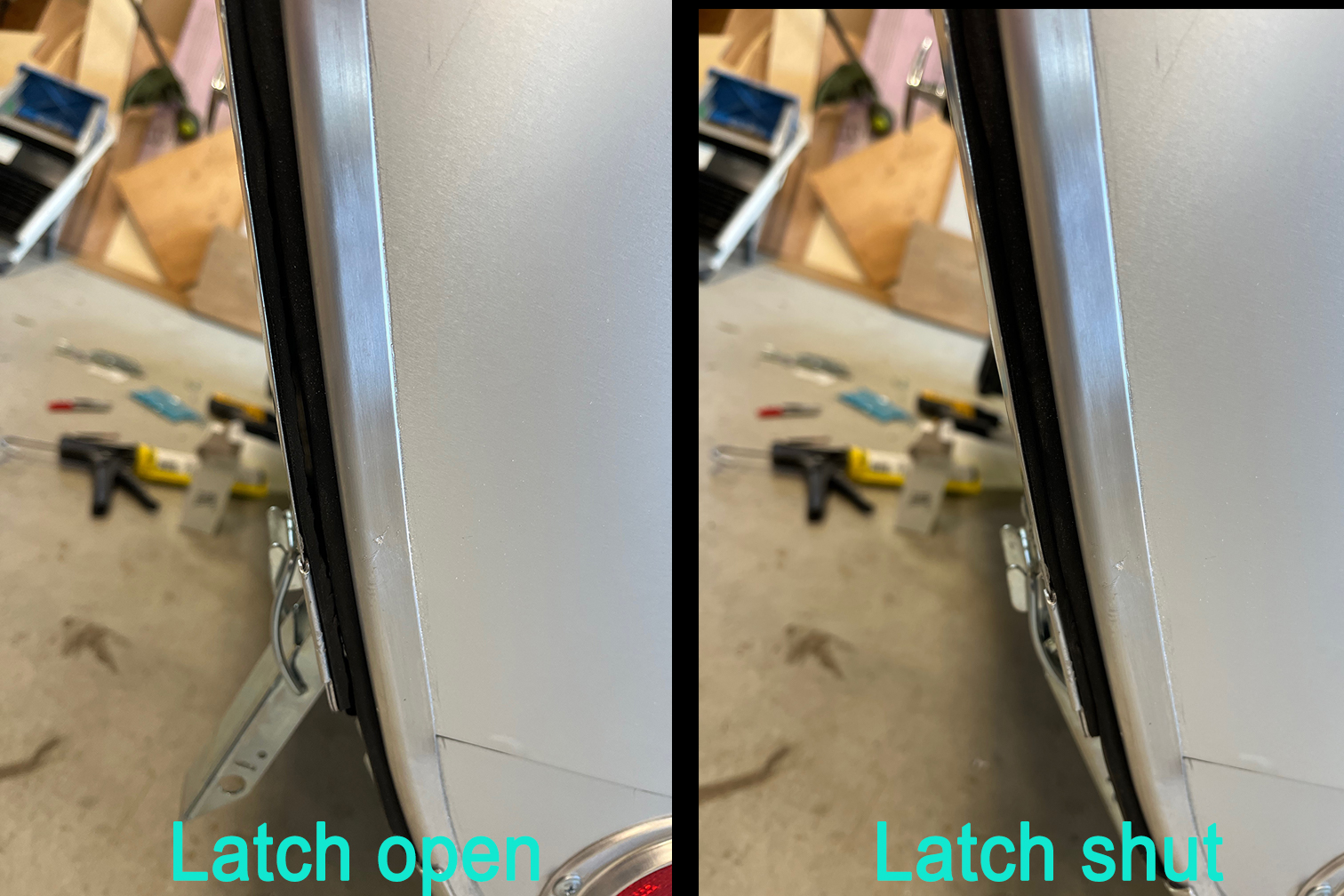

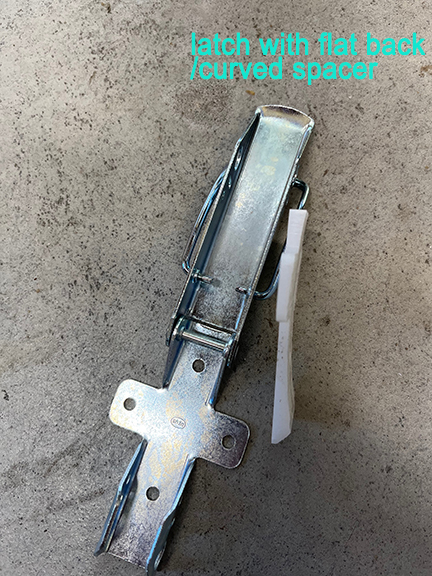

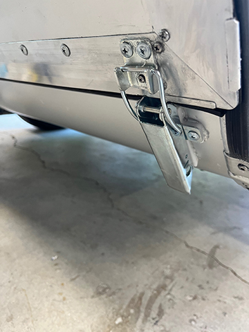

One thing I wanted to share regarding latches to secure the hatch. My hatch did not close perfectly.... leaving a bit of open space starting in the mid zone and increasing as your eye traveled down to the bottom. It wasn't a lot. I could just see the T molding was not making contact with the seal as it got on towards the bottom of the hatch door. At first I was going to remove all the screws holding the hurricane hinge and put a shim under the hinge to raise the entire hatch door upwards a bit. I really didn't want to do that. What I did was take some extra seal I had, slip a piece of aluminum inside, all the way through the opening of it, and run an exact blade along the aluminum to leave about 3/16 of an inch of seal left (using the aluminum as a stop or guide for the exacto blade). I adhered that seal on the underside of the T molding so it contacted the original seal when the hatch was closed. Worked fairly well but left the space I referred to earlier.
I had ordered some latches from a vendor. They were about 3 inches long. When I received them I could see they were way too small. Sent them back.
So the main purpose of my writing all this...... These new latches I ordered worked great. The are the perfect size for working with the hatch (I imagine most people's hatches are probably similar sizes). They are manufactured by Southco. The model number is TL-60-102-07. The catch is model #TL-17-601-07. Because where I mounted the latches is on a curved area, I machined a couple of shims. The curved side matches the curve on the trailer leaving the other side flat to mount the latch. It's kind of difficult to tell in the photo but when the latches are closed they just pull the hatch closed a bit more to create an effective contact between the two seals. I'm just so happy with the way they worked, I wanted to give them a shout out in case anyone was looking for a good latch product.
