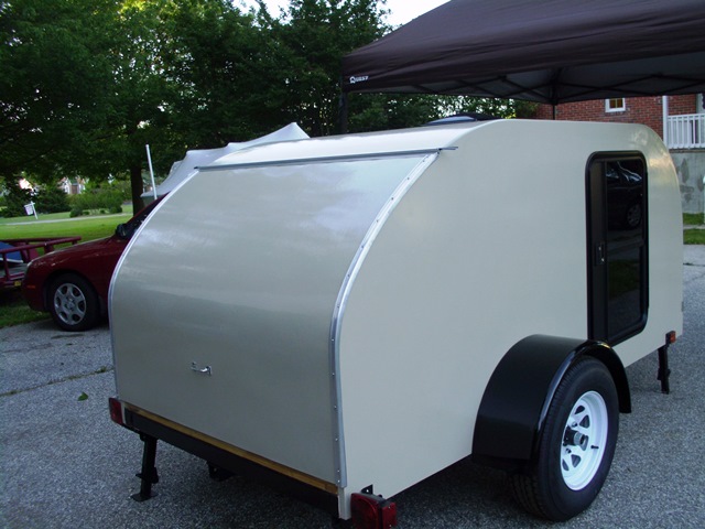

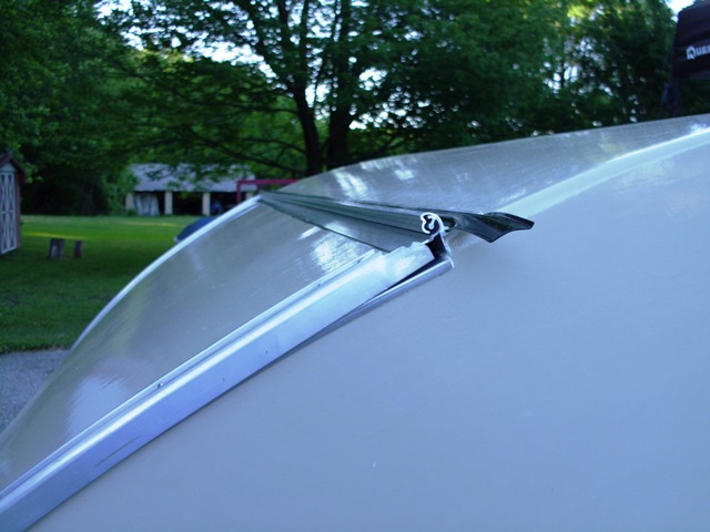

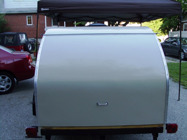

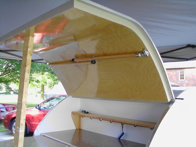

My primary goal today was to get the hatch installed, and strictly speaking I got that done. Some things still didn't work out like I thought they would, but I decided it was time to just push through, modify what I could and make it work. The end caps for the hatch side trim didn't work for me. Some little problem with rivets and placement. I think I'm going to do without them. (Still haven't figured out exactly how I will close up the ends and I'm open to suggestions) However, because I had already drilled holes through my vinyl insert to accommodate those end caps I need to order new vinyl now. This isn't the end of the world. I'll call Grant on Tuesday.
I can't say it is a great fit. I can't say I am thrilled with it. I still have big gaps at the top, bigger on one side than the other. All I can say is that with enough caulk and gasketing, and a good pair of draw down latches I will get it to work. And after all that if I can't get it watertight, I will make a canvas snap on cover and head on down the road. Next item is to trim up the floor and the bottom of the hatch so I can get those latches on, draw it down and see where and how much gasketing I'll need to use.
(Sorry the pictures are so dark, it was getting late when I finally started cleaning up.)
This is my biggest issue. Grrrrr.....
This hatch has completely worn me out and I have no confidence whatsoever that doing it over would yield any different result, so one way or another, whatever I have to do, we will make this one work, go camping and have ourselves a blast.

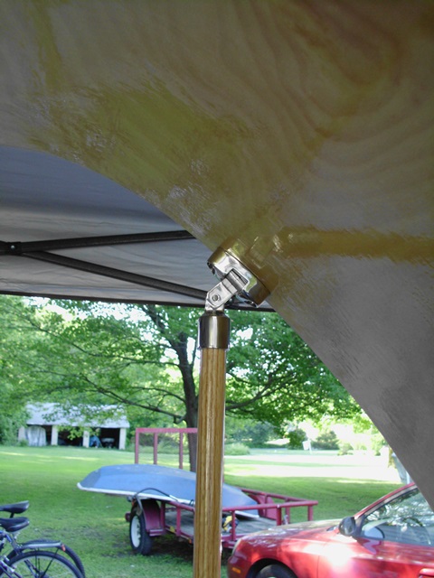

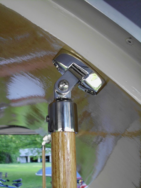

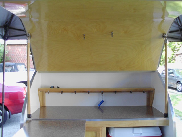

The prop poles came out great and I am very happy with those. I used boat bimini hardware. I had to mount them on a pretty severe curve to get them to come down onto the counter where I needed them to be, and I also wanted them to fold in so I could store them in the hatch in clips. I found deck fittings with an articulation point and everything worked perfectly. Just open up and drop them down. They're pretty too. The poles are 1" oak dowel. The hardware came from Sailrite.

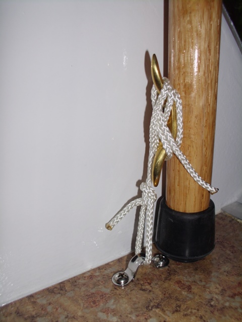

And how will I keep the hatch from blowing up in the wind? I'm so glad you asked. Since I started with boat hardware, I thought I'd just carry the theme through and use cleats and little eyes. A bowline, a couple wraps around the cleat and the hatch is going nowhere. The cleats are on the back of the poles and aren't even visible looking straight on at the hatch.

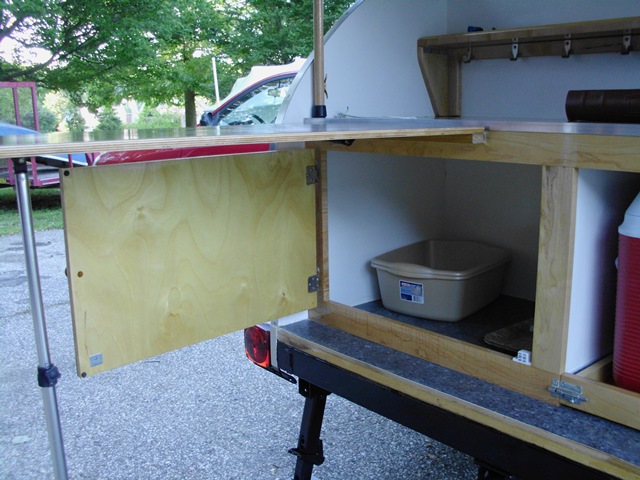

I got the extension table mounted using the hardware I got from Compact Camping Concepts. A nice adjustable leg that folds up under the table and is held in place with a little permanently mounted bungee cord, and a mounting rail.
Nice, lightweight, easy to take on and off and gives me lots of extra room. The table top is covered with the same Formica as the counter.
The leg is out far enough to allow the cabinet door underneath to be opened completely for easy access when the table is in place.

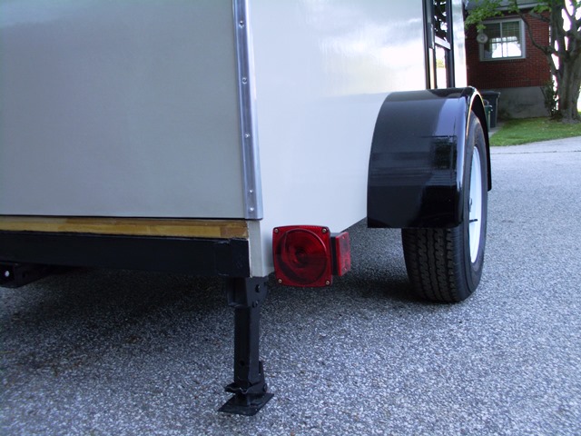

We used the inexpensive Haulmaster light set from Harbor Freight with one of our many discount coupons and it fits the look of the teardrop perfectly. I may add some reflectors at some point.....or not.

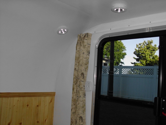

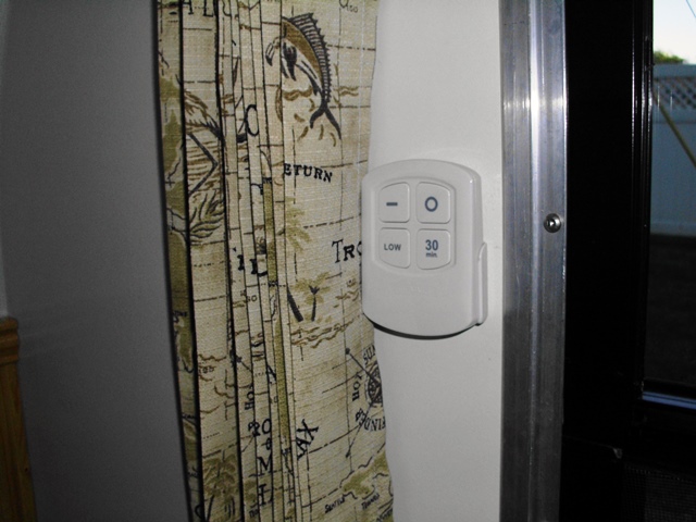

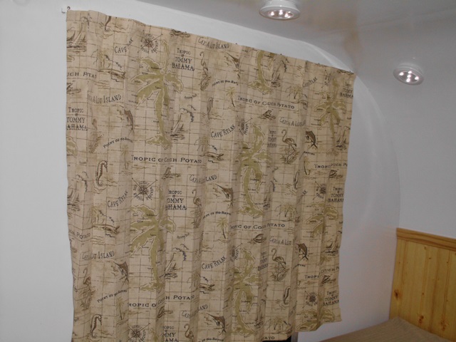

Inside the cabin I have installed my led lights. These are simple wireless stick up lights that came six to a pack at Costco and have a neat little remote control that has a holder which I mounted by the door. The remote turns all six of them on or off at once but you can use them individually by pushing on them. They put off a lot of light. I just hope they have decent battery life.
The curtains came out good. We are very happy with the interior. The bed is comfy, the fan puts out a nice breeze, it's light and airy and seems plenty roomy to us.

I was wondering how you held the prop rods in place and teh cleats and eyelet is perfect. its nice for sure.
I'm sure others will copy on this idea. Good job Becky! :thumbsup:

Those side hatch gaps can be dealt with. Once you get it totally
trimmed down they probably won't be as large and you can weather-strip
them "away".
Here's a novel solution I ran across on an Australian Vintage Caravan
forum I belong to. One of their members bought an in-progress large
TD and is finishing it out as a small toyhauler/TD combo. He wanted
to use some vintage car tail lights on it that he had, but needed a very
large gasket to fit it to the rear curved body. Such a gasket didn't exist.
[It is, after all, a one-off custom build - as is yours !] So he fabricated
a couple out of a pair if flip-flops ! Think of it - flip-flop soles are after
all, just a very dense foam. Maybe you could adapt this idea and make
a custom wedge out of some flip-flops to use as the topmost parts of the
side's weather stripping, if you still need to close in a larger gap. Just
fabricate the needed pieces to size and glue in place with the appropriate
glue and then continue the rest of the weather stripping with the usual
types you'd planned to use.
Here's a link to the Aussie Vintage Caravans forum thread page showing
what he did. Look for reply #169 on the page.
http://vintagecaravans.proboards.com/in ... 745&page=7
Maybe his idea could help you out. Your hatch looks so nicely done, that
I think you're right to decide to just deal with what problems there may be
and not rebuild it or build another.
Norm/mezmo
P.S. Just happened to think... If the flip-flop sole foam thickness doesn't
completely fill a gap, maybe it'd be enough as a base that you could still
use it and then run the 'regular' types of weather stripping on top of that.
Also, another source of an even thicker dense foam would be those foam
weeding kneelers you can buy for a couple-few bucks at a garden store or
garden section in a larger big box store.

When I saw those oak legs to support the hatch, the first thing I thought was... "what happens when a big wind comes along and blows the hatch door upwards" but you got it covered in a very creative way....WELL DONE!!! :applause:
