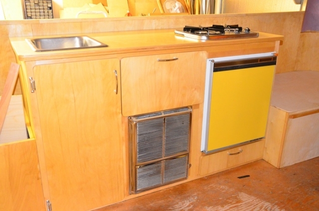

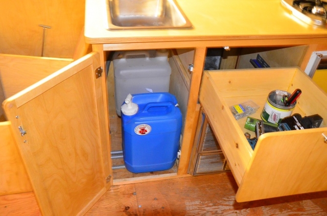

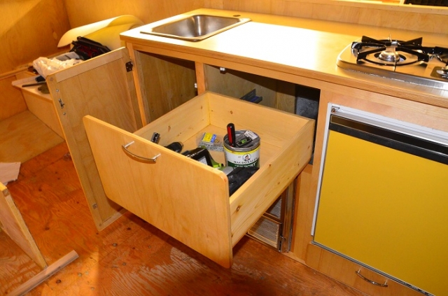

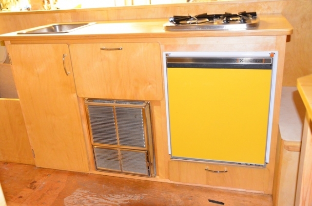

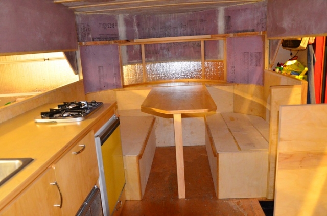

Time for update. Worked on kitchen cabinets and finishing dinette table.
Made one deeper drawer on full extension "blum" slides for a kitchen organizer in the middle that would have pots, dishes, cups, utensils and maybe more in one place.
Next will be working on the sofa/bed in the back.
