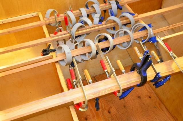

Here I am gluing the rails(birch) for expandable bed frame:
Then I cut all the slats for needed length and placed them on the rails. Need to screw them down later:

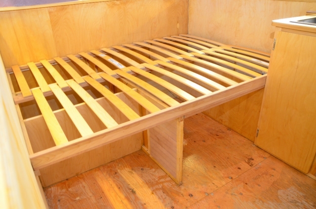

Just some pictures of the bed base finished today.

Nice job. Looks great. :thumbsup:

Postby dales133 » Tue Apr 18, 2017 6:14 am
Ye sir
Looks great

OP your craftsmanship is stunning! All that birch looks beautiful! Very well done and super impressive. :applause:

Atomic77 wrote:OP your craftsmanship is stunning! All that birch looks beautiful! Very well done and super impressive. :applause:
Thank you very much Michael, I take it as a huge credit from a great Craftsman you are, indeed.
To my eye, a somewhat darker yellow birch hardwood and a lighter white birch look nice in a work piece together. This is my first such long woodwork (and of course, foam) project. Without much experience, I am trying to do a decent job so you my friend, and all here would have a good feeling while watching how this build comes to life.
