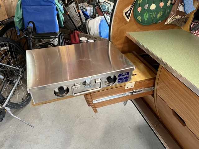

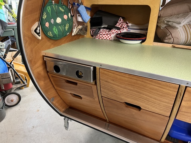

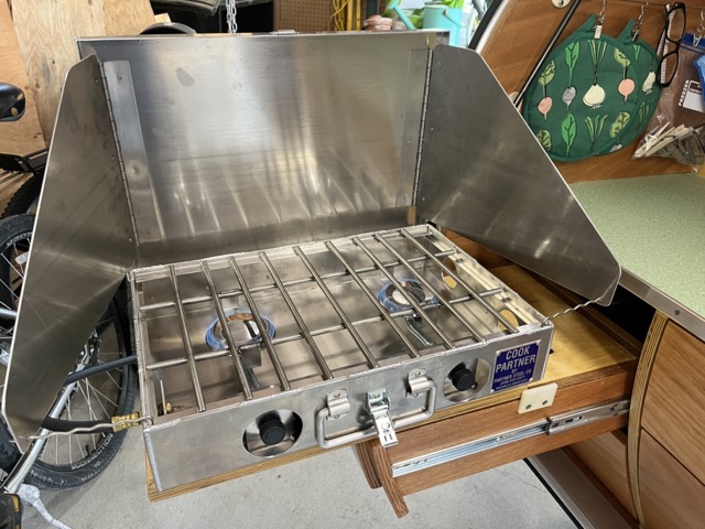

Aug 9, 2022
Received my long awaited Partner Stove. Works great, lid closes nicely and I can say it's really a beautiful piece of equipment.... very nicely crafted.
Looking forward to putting it to use and cooking some nice gourmet meals :R
John

Postby TallGuy7 » Tue Aug 09, 2022 4:04 pm
Beautiful and a perfect fit!
How did you position the gas container and gas line? I am having a similar setup but have not figured that out yet… because as the stove moves the gas line also has to be able to move with the stove.

Postby tony.latham » Tue Aug 09, 2022 4:30 pm
So it's working fine now???
Re: CapeBuild Build Journal
Postby tony.latham » Tue Aug 09, 2022 4:38 pm
I ordered my Partner with the gas inlet on the right side. When the stove is pushed in, there's a U-shaped line that hangs down. That line connects to a rubber propane line attached to the chassis frame.
You can kinda see it here at about 3:30:
The propane lines (one for the stove and one for the heater) run to the tank on the tongue box.
:thinking:
Postby Capebuild » Tue Aug 09, 2022 4:56 pm
tony.latham wrote:So it's working fine now???
Yes.... burners light soon as torch is contacted to burner (before only half lit up) and the lid closes without binding. I had sent it back to Partner and had many discussions with Jaime (president if Partner). Great guy and was very helpful in making things "right". Good company and nice product.
TallGuy7 wrote:How did you position the gas container and gas line?
I'm not sure I designed the hose to stove in the most efficient manner, but time will tell. Unlike Tony and the way he set his up (which I think is the more efficient way to do it) I have the inlet on the left side and will run the hose to the propane on the outside of the trailer. The downside is I'll need to disconnect all when I want to close the hatch. I did not have the room at the rear of the stove to have the inlet on the right side and accordion the hose when it was in the closed position. I'm looking into quick connect/disconnect fittings which may make things a little more efficient .... but I want to use it for a while and see how things work out.

Postby JasenC » Tue Aug 09, 2022 6:07 pm
And your TD is now officially complete, for now ;)
As far as plumbing the stove, my Flame King is plumbed out the back but there is room to put a 90 on there so I can take it out the left side.
My plan is to run the line diagonally, floor up to stove, then it is more of a leaning motion on the hose instead of a push/pull/kink/pinch, I may also add a bungee cord to hold up/retract the line if need be.

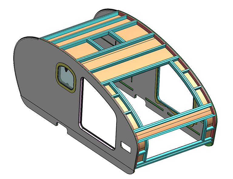

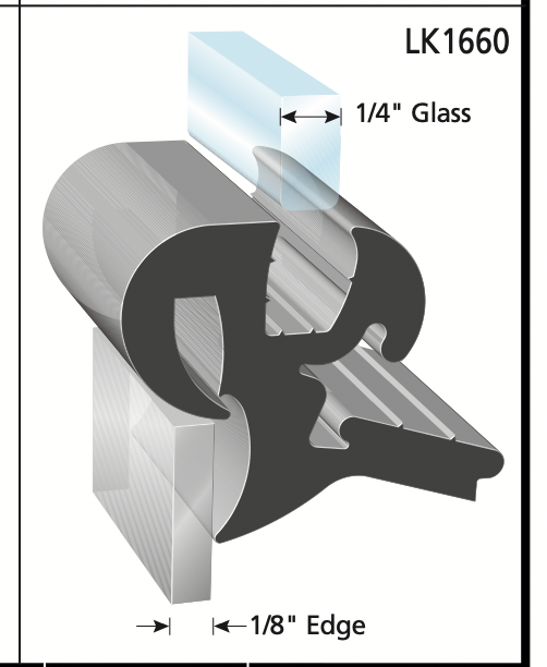

Hey John- I find myself coming back and referencing your amazing build. I am framing up the roof and have a question regarding the window. My plan is to frame the opening around 1.5 larger than the window. Then make a 1.5 insert template to router cut both ceiling and roof, Then uninstall the template to install trimlok and glass. Is that similar to what you did? I guess yours passed the water test...
Chris
Onajourney
Posts: 259
Images: 181
Joined: Mon Sep 06, 2021 2:16 am
Location: Central North Carolina
Postby Capebuild » Tue Aug 23, 2022 7:28 pm
Onajourney wrote:Hey John- I find myself coming back and referencing your amazing build. I am framing up the roof and have a question regarding the window. My plan is to frame the opening around 1.5 larger than the window. Then make a 1.5 insert template to router cut both ceiling and roof, Then uninstall the template to install trimlok and glass. Is that similar to what you did? I guess yours passed the water test...
Hi Chris..... I'm not sure I'm understanding your question. I can go out and look at the trailer in the morning (and maybe look at the CAD)... but are you asking about how I made the opening for the window? Just want to make sure I understand what you're asking so I don't pass on wrong info. I did make the window a bit larger than the opening, but you have to base your window size once you figure out what gasket you're using. So the window actually sits slightly proud of the opening within the gasket.
Regarding the "water test".... I did have a few areas where water was making its way in. I had gotten some butyl caulk (which, from my understanding, is really the only caulk that will work with the EDPM gasket material).... and kind of worked the caulk into the seam between the acrylic and gasket. I did this in a few spots and it seems to have resolved the issue. My original plan was to lay a bead of the butyl caulk in the gasket before I inserted the window.... which may have been a good idea, however that stuff is so gooey and sticky it's really tough to work with and probably would have made a frustrating mess.
EDIT: Attached is a picture of the gasket I used. You'll notice where the glass is placed kind of overlaps the space where the gasket fits onto the vehicle, thus allowing the glass to be actually a bit larger than the opening in the vehicle. When you're driving down the highway you don't want the gasket rolling and the glass rolling into the opening and kind of collapsing..... making the glass larger than the opening (hopefully) would prevent this.

Postby Onajourney » Wed Aug 24, 2022 9:00 am
Thanks John. I have been worrying about possible leaks. The butyl chalk definitely sounds like the way to go especially where the ends meet. I figured out how to cut the roof and ceiling. I was overthinking it,
Onajourney
Posts: 259
Images: 181
Postby Capebuild » Wed Aug 24, 2022 10:03 am
If it's any help (and for what it's worth) once I had the 2 walls up I then installed the inner sheet (the ceiling). Then framed everything out (see attached image), then used the framing as the router guide to cut out the opening for the window. For the outer wall piece (the roof) I remember cutting the window opening out prior to installing it... and using some registration marks, then installed that in place. You may decide on another way to do it.... but that's how I did it.
Your build is looking good. Chassis frame looks great.......
John
