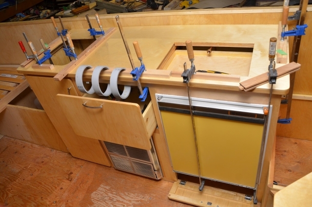

I glued up the "bathroom" area and then permanently glued the counter top today:

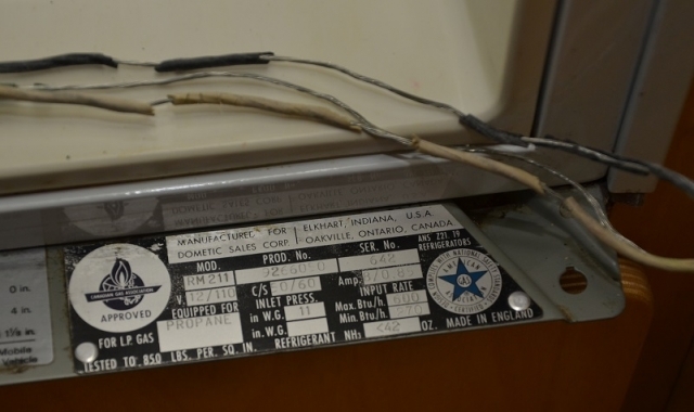

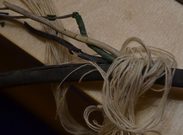

While connecting 3-way dometic fridge today, I've discovered that its (seems to be) original 110V power cord wires inside have isolation that is completely dried out and cracked for the whole length, especially green earth wire which just was falling apart. Never seen such material defect in power cords before, seems to be not related to any overcharge and overheating, it only draws 0.85A from 110V, and the wires inside are all shiny. Good thing it had a little damage in a cover that drawn my attention to it. Would have a time bomb fire potential, clearly. From outside the black rubber cord jacket looked completely normal and flexible. Seems like some chemical composition defect. Beware. Now I have to check my old Boler trailer's fridge that has dometic next size bigger model.

Postby KCStudly » Mon Apr 24, 2017 6:02 am
:frightened: :o :shock:
Good catch.

That fridge wiring is scarey
