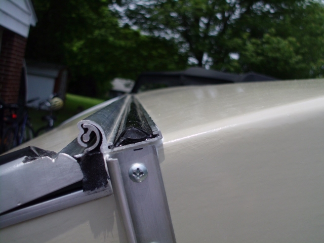

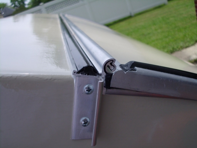

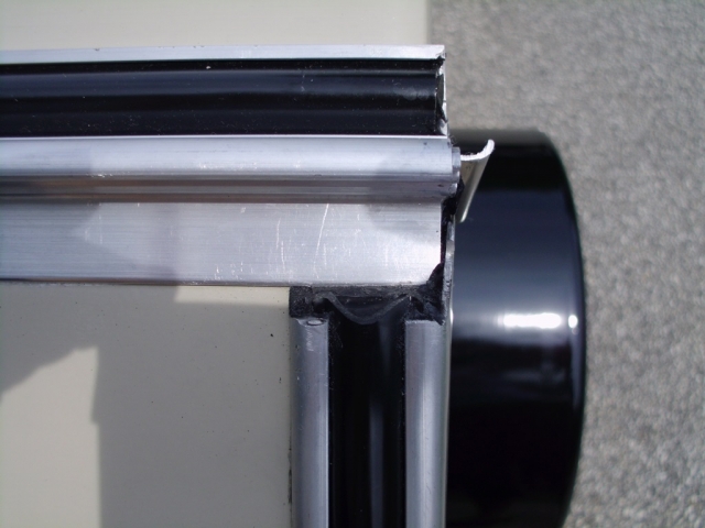

I've spent some time tweaking my hatch and I think I have got everything sealed up tight. Only time will tell, but I've caulked, sealed, tweaked gasketing, tightened drawdown latches and peeked all around with my flashlight looking for areas where I can see gaps and it's looking pretty good.
My placement of rivets and errors in cutting my hatch edge trim made it difficult to come up with a good way to use the end caps for the trim, so I came up with a different solution. I had a gap at the top of the trim on the passenger side because I had started attaching it from the top but when I got to the bottom it was 1/4" too short. So I removed it, filled all the rivet holes with epoxy, moved it down, and reattached it. The problem is, that left me with a 1/4" gap at the top between the trim and the hinge. I had some hard black sheet rubber so I cut a little piece to fill that gap (did it on the other side too just so it would look consistent). Turns out that also closed up the bottom nicely under the vinyl insert to make it easier to fill with caulk and get a good seal. So then I extended the vinyl insert over this piece of rubber, filled it with black silicone caulk and after it had hardened I took a razor knife and cut it off at an angle just make it look a little bit more finished and to deflect water better.
The one big gap I had has been filled very well with gasketing and a piece of closed cell foam from an old boat cockpit cushion. (Same on the other side) I closed up all the ends of the vinyl insert with black silicone caulk.
I didn't leave as much of an overhang with my hurricane hinge as I should have, and even if I had I am definitely going for overkill here, so I got a small piece of rain gutter from Grant Whipp and put a 2" piece on each side aligned with the hinge. (And if it happens that you also forgot to leave an overhang with your hinge I might suggest this as a solution before you spend the money to buy a whole new hinge.)
There is a lot of silicone caulk in all the gaps and cracks. We shall see the first time we travel down the highway in the rain how well it all worked out, but I am hopeful. :)
