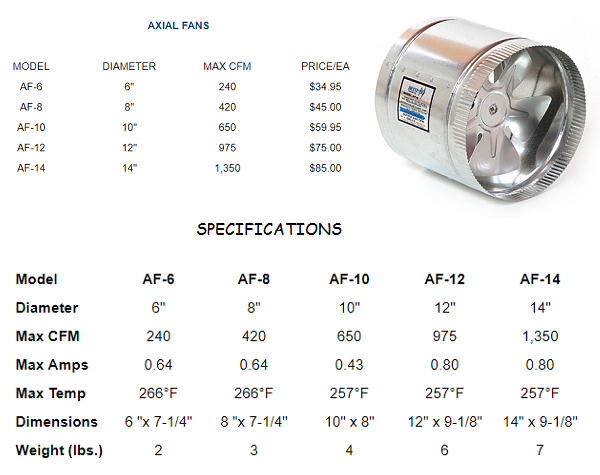

  • My A/C system also failed, at first (actually, several times), due to thermal overload, like yours. I was trying to capture the A/C exhaust in a metal vent boot (used in hvac), directing it thru insulated ducting to exit thru a wall vent on the other side of my galley, so I could run it at night, with the hatch closed. The problem I faced was that the hot exhaust air wasn't exiting fast enough, but building up in the ducting. After several re-builds of my ducting, I finally enlarged the exit hole to 6" (from 5"), eliminated any internal restrictions (straightened the ducting), and installed an axial duct fan inside the duct. http://www.tnttt.com/viewtopic.php?f=21&t=54945&hilit=+solved#p999038
  • I used a 6' diameter axial fan, chosen because it was the right size for my ducting, had a high flow rating, and was rated for high heat tolerance.I'm not quite sure of the exact configuration of your A/C system, or of any size restraints for adding a larger, more powerful fan (except that the outlet must match your already mounted exterior vent cover), but I have two alternatives that may work for you, by removing the hot air faster.
  • 1) follow my build's example, using an axial fan: it will have to be mounted directly to your wall, so using a different type of Speedi-boot is suggested, placed over the wall opening, with the fan screwed into the collar, using sheet metal screws.
    centered over the wall opening, with fan attached to the rear
    axial fans hi-flow, hi-heat.PNG (149.34 KiB) Viewed 3571 times
    I used the 6" fan in my system

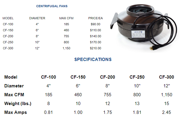

  • 2) directly mount a centrifugal fan to the wall: would be a more direct approach, with higher air flow, but with less thermal resistance to overload. 140 degrees will shut these fans off (compared to 250+ degrees of the axial fans), but you've only seen 120 degrees, and I only saw 140 once (with major restrictions to the flow), but only once, so the 140 degree rating would probably work for you.
    centrifugal fans higher-flow, more heat sensitive.PNG (115.61 KiB) Viewed 3571 times
    easier install, maybe better for the open (unducted) system
  • I bought my axial fan on e-bay, but later found the manufacturer's website http://www.aero-flo.com/. I like the fact that their products are made in the USA, and my fan solved my A/C situation, and might solve yours, so it's a suggestion you might want to consider. Good luck!
173193172890148599

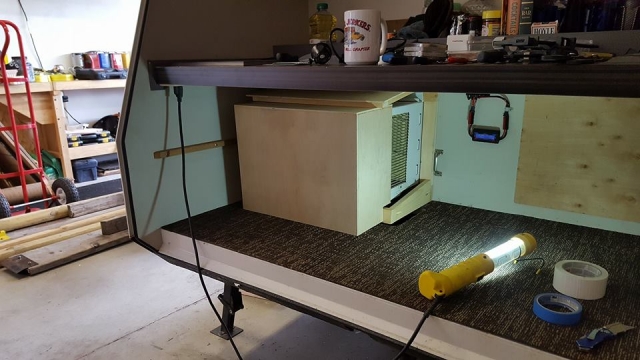

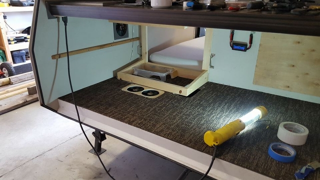

Wish I had seen your posts before now... This is what I should have done from the beginning! Friday night I was out in the garage and put a cardboard box on the back of the AC to direct the air out the bottom, rather than in. And it seemed to work. My new fans arrived Friday, so all weekend I've been working on the final solution! I've been testing it since yesterday and I'm good to go!!
Just needs some paint. :twisted:

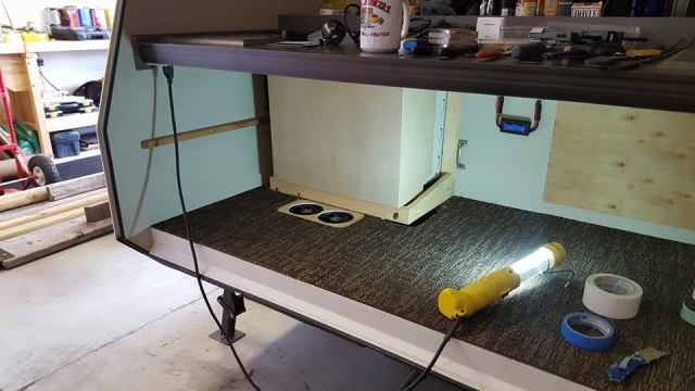

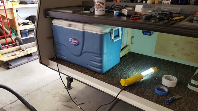

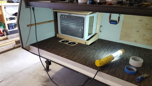

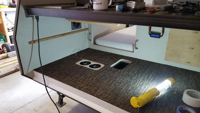

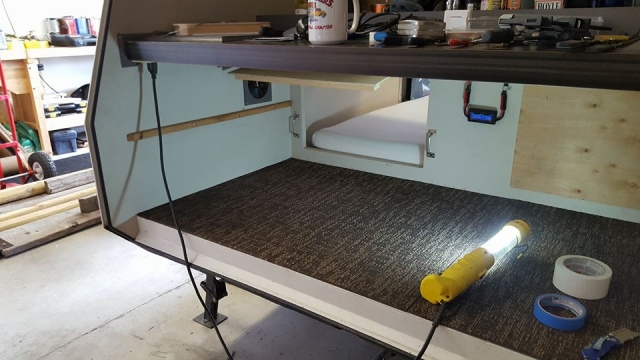

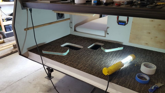

As I've mentioned, when camping in cooler weather the air conditioner stays at home. So I made filler plugs for the vent openings in the floor. And they blend in so well. :D
To install the air conditioner, the plugs come out of both floor openings and my new dual exhaust fan assembly (two 120mm, 100cfm computer case fans) fits in the larger floor opening. Then the air conditioner cradle fits in the bulkhead opening, and the air conditioner rests on that. To collect the hot exhaust from air conditioner, a box cover fits over the back of the unit, directing air out the bottom of the trailer. Fresh air is drawn in through the vents in each side of the camper.
While traveling with the air conditioner, the exhaust box cover slides up onto the air conditioning unit, leaving enough room for a cooler.
The "exhaust" holes and covers on each side wall of the camper are now "intake vents", and I don't have and power running to those fans right now. The force of the two fans out the bottom of the galley floor draws enough air through the air conditioner that there is actually air flow in the side vents. Galley temps hang right around ambient air temperature and the air conditioner cools the camper well. Woohoo!
