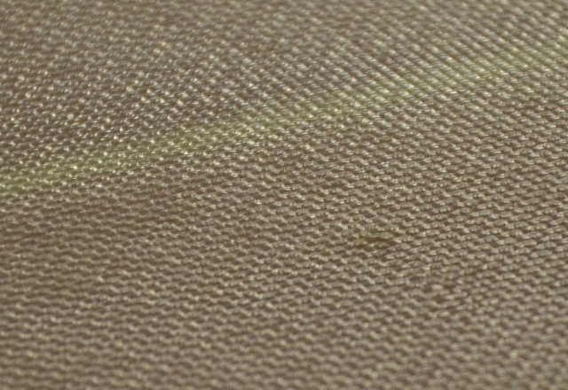

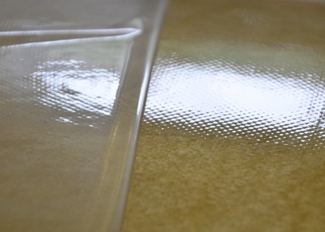

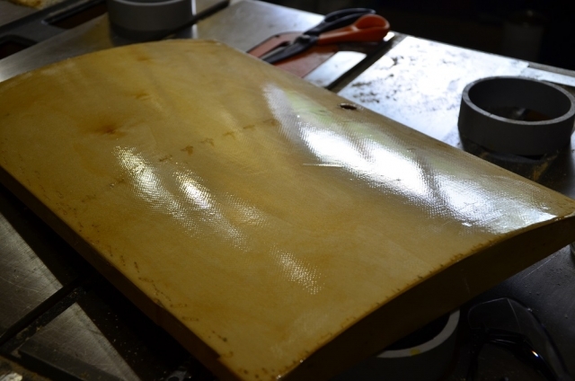

Some photos of finished access doors:
Worked much better in one step than when previously I had to fill the cloth weave of fiberglass with two more epoxy coats after lamination (old photo) ..:

Hi everyone. Time to do some update. My progress is quite slow, but I finally figured our how to make the door's transition, lower and upper parts and mostly done with that. Upper door half will have some window cut out after glue is set. Then I'll laminate the upper folding walls with fiberglass. Lower door got laminated with glass using gift wrap to save epoxy and time. Did some pictures of the RV lock install, it was unusual comparing to normal door lock, but doable. Still lots to do, but it feels like the finish is not too far anymore. There will be some fairing and sanding and more minor lamination in the back, but hopefully it will not be holding me up with "thinking" of how to make things.. cheers and all the best.

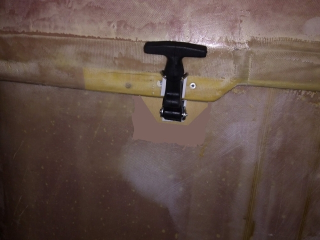

What do you think of such of tie-down latch design ? This is a dry fit of the wedged plywood piece that will be anchored to the lower part wall and laminated with fiberglass. It will have rounded edges, of course, once I figured out the best looking shape.. Thanks for your input.

Tried to mock up the other type of hook today and it looks a little better to me, looks like less of impact or footprint.
Another positive point is that rubber will not damage fiberglass like rattling metal parts and no need for a locking/safety pin or a paddle lock like in the previous version above..
Anybody did something like this and can share experience with the holding hooks here?
