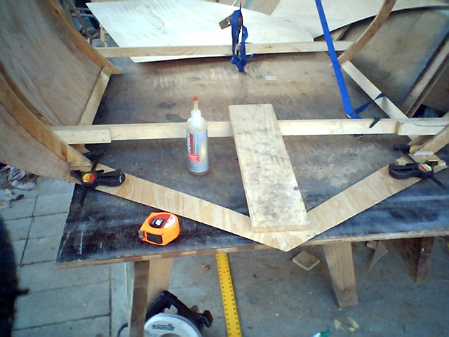

Built a cute little harbor freight trailer. Good thing it is only 40" wide, with the bottom of the sides curving in, it just fits.
The body i got the lower front nose piece in..
Now i know how long the nose will be at the bottom.

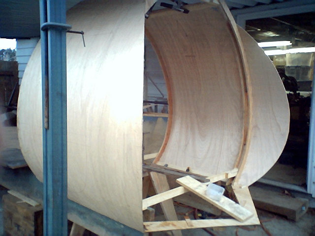

Build progress.
Put the second door area skin on. This time i only put it on once. Made sure the bottom was lined up with the bottom of the frame work, and the front was lined up with yesterdays lower nose piece, then stapled. Note you should draw the staple here line that represents where the spar will be before putting it up.
