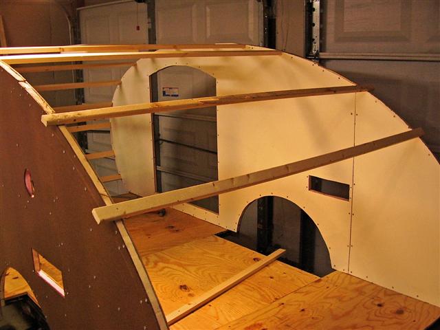

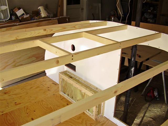

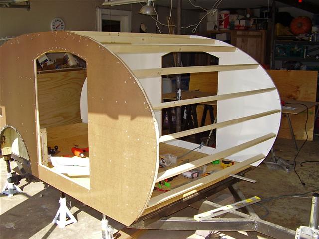

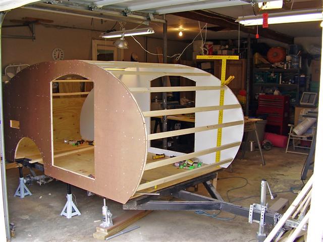

I added spars to the roof.
After placing a piece of masonite across the spars, I found that they bowed inward a little. Tomorrow, I want to turn the spars vertically. This should take care of the bowing.

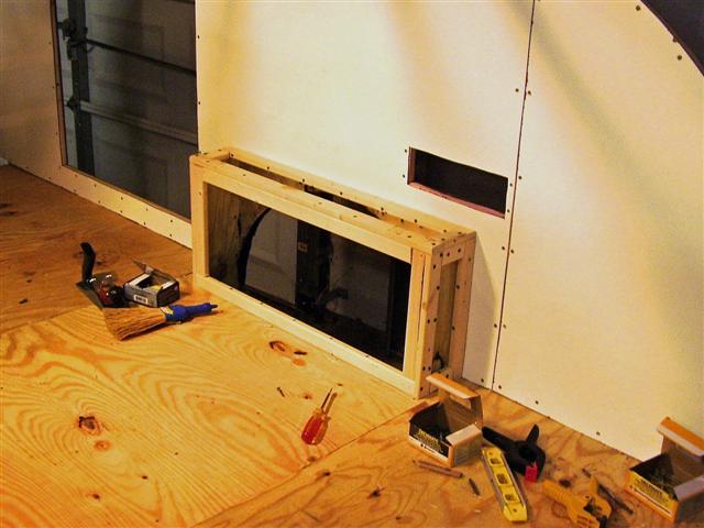

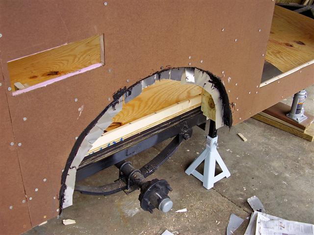

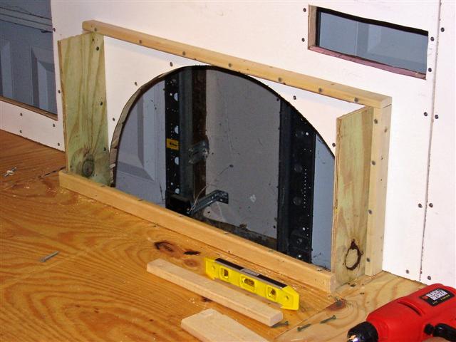

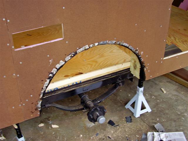

Then I started on the wheel wells by building the frame:
To protect the masonite wall, I decided to cover with flashing. I put down some roof coating over the masonite then covered with the aluminum flashing:
Then I folded the aluminum over the edges and tacked it up.

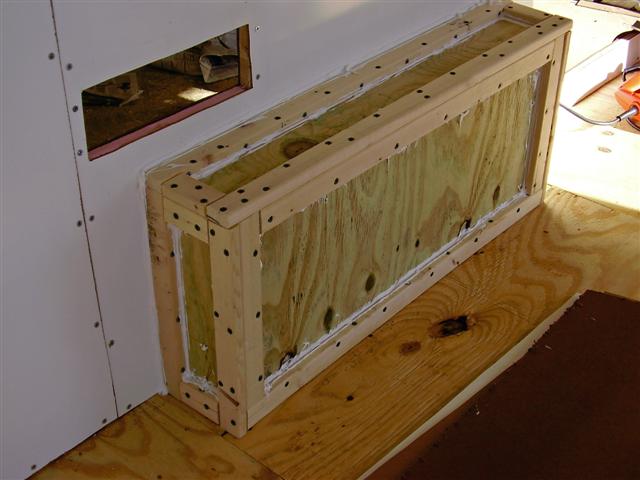

Edges tacked up:

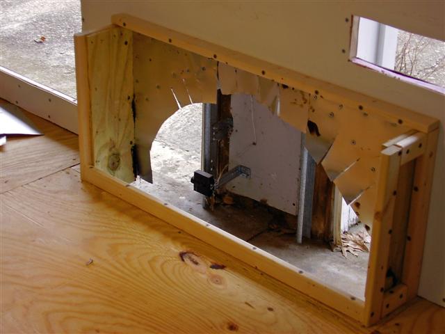

Today I finished framing up the exterior (outside) part of the wheel wells. I used treated plywood for the exterior which will be covered with roofing compound.
Then I put sealant along the the interior of the framing.

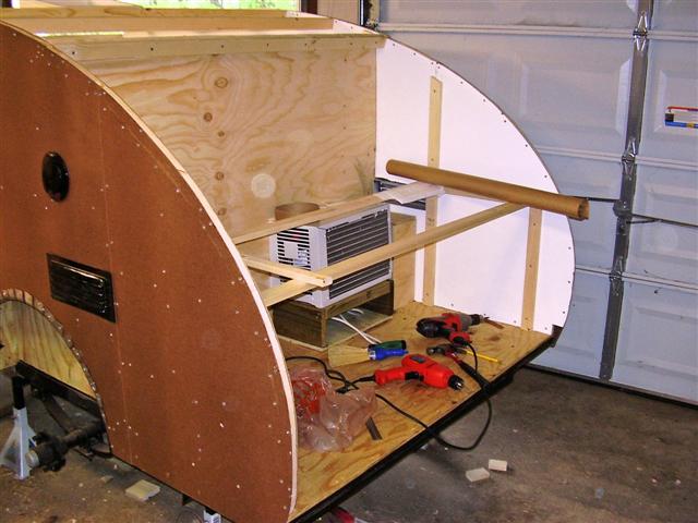

I picked up this air conditioner at Wal-Mart yesterday. It was $98.

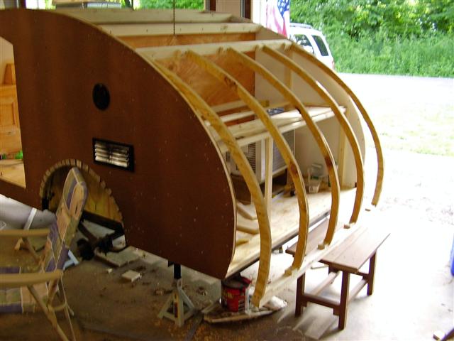

I did reposition the roof spars to vertical:

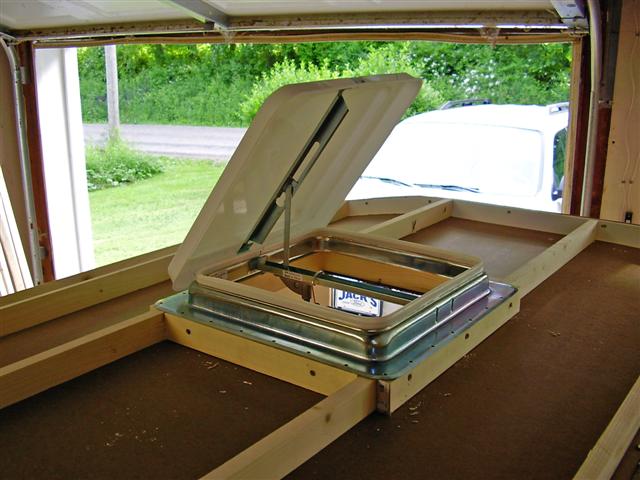

Made the frame for the roof vent:

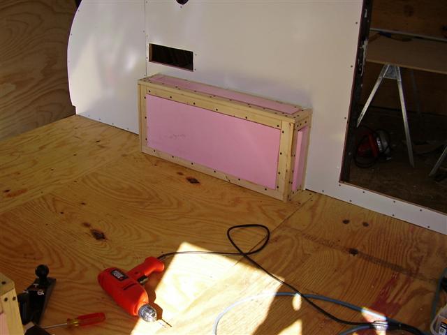

Then I insulated the wheel wells:
I started playing around with the miter cut settings on my table saw. I want to get the finished side of the wheel wells done next. Then cut out the bulkhead for the back wall.

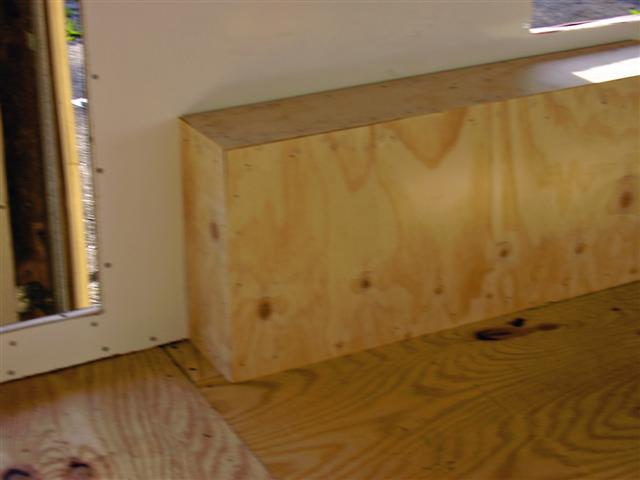

Today I got the wheel wells finished off:

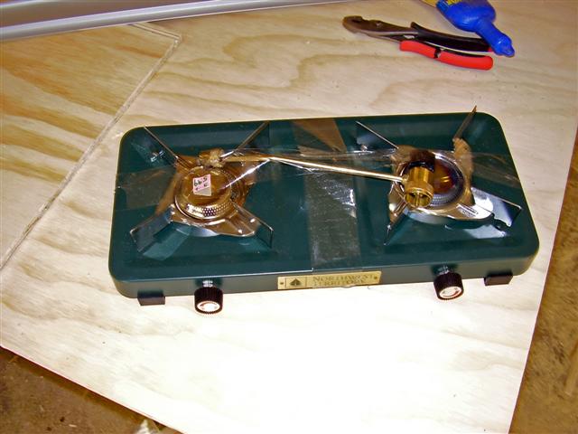

My brother dropped off a campstove that he found at a thrift store for $5.99.

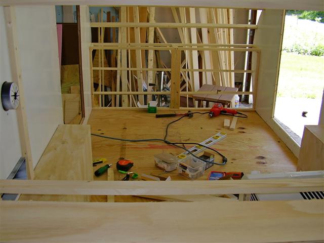

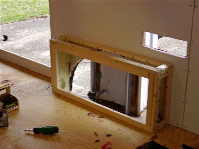

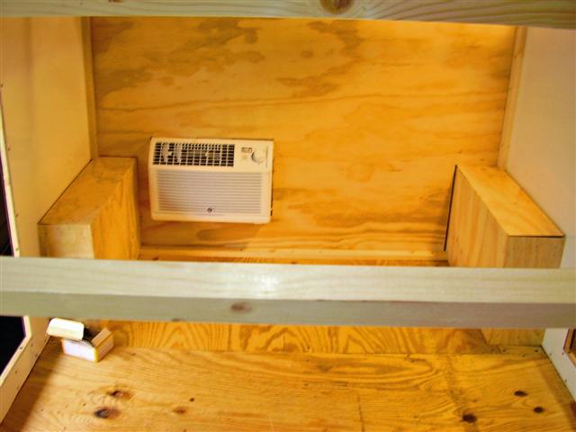

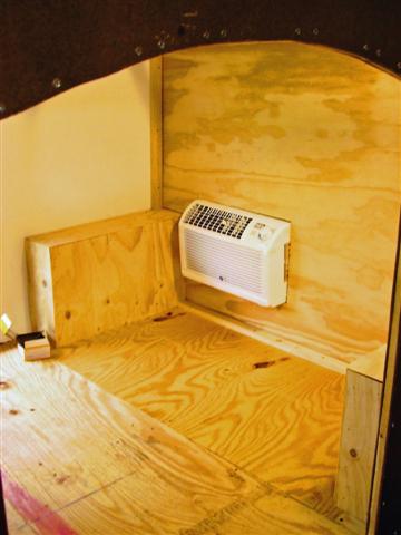

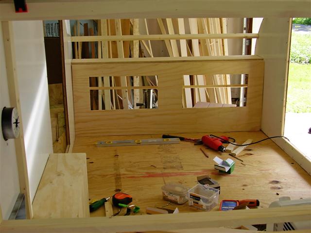

This weekend my brother came over and helped me get the back wall cut and placed. We also cut the hole out for the air conditioner. I still need to attach the wall with screws. Not sure if I will need to take it back out yet to cut any more holes.
Next we made a bracket to hold the air conditioner and built out the counter frame.

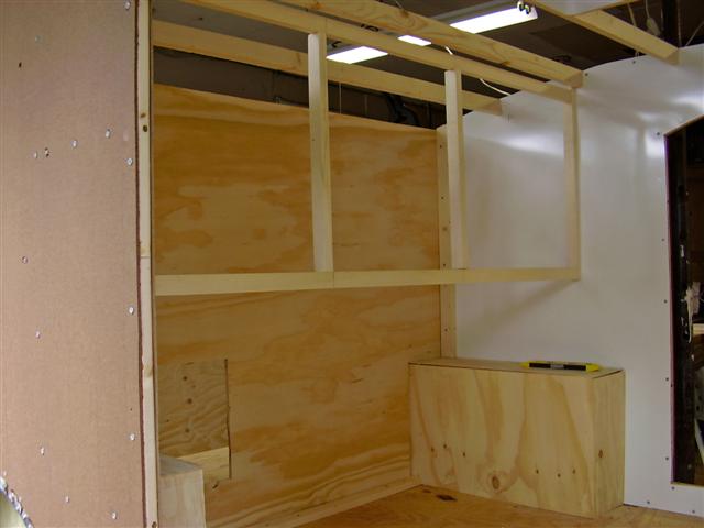

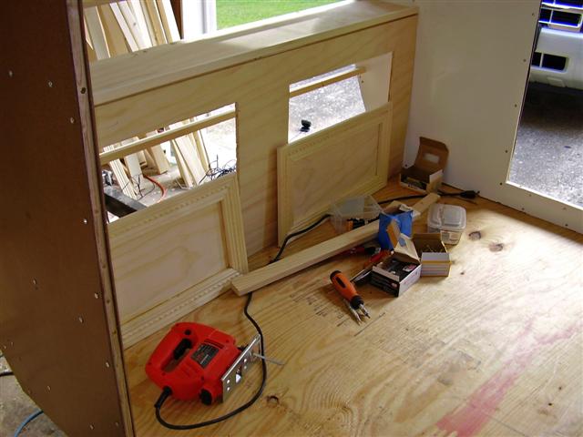

It's been awhile sice I posted pics. I framed out the front cupboard.
Then I cut out the cupboard front.

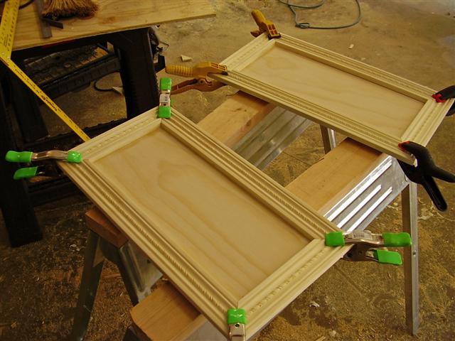

Then I made the doors.
I still need to attach everything.
Then I started framing the back cupboard.

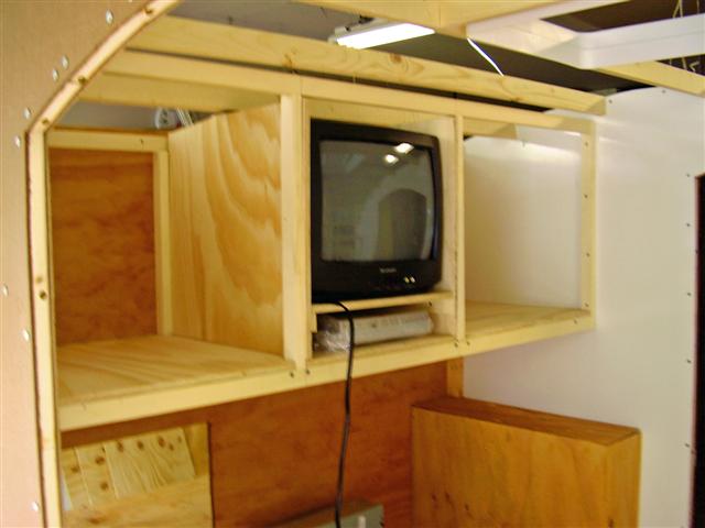

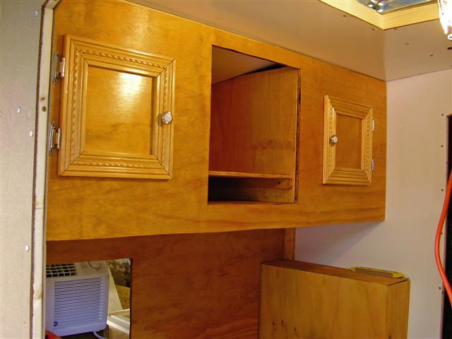

Got the rest of the back cabin cabinet framed and cut out. Then put in the tv and DVD player to test for fit. It fits perfectly!! :thumbsup:
Then I cut out the cabinet face, then coated all the cabinet pieces with oak gloss polyurethane.

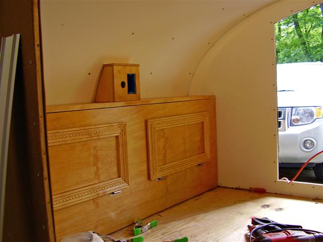

I got the back cabin cabinet doors/front/ and sides polyurethaned and installed.

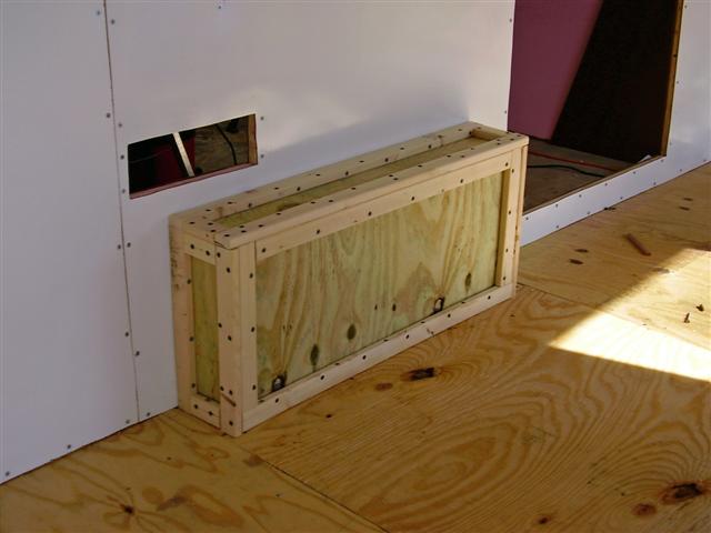

I also did the same for the front cabin cabinets. I had to build a box to accomodate the AC and DC power outlets for the front of the cabin. I still need to attach the top and outlet box once I run the wire.

When checking the vent for fit, I realized that the predrilled holes for the vent flashing where farther out than my wood frame. So I had to extend the frame out a little.
