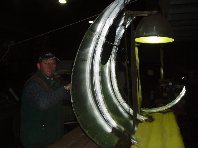

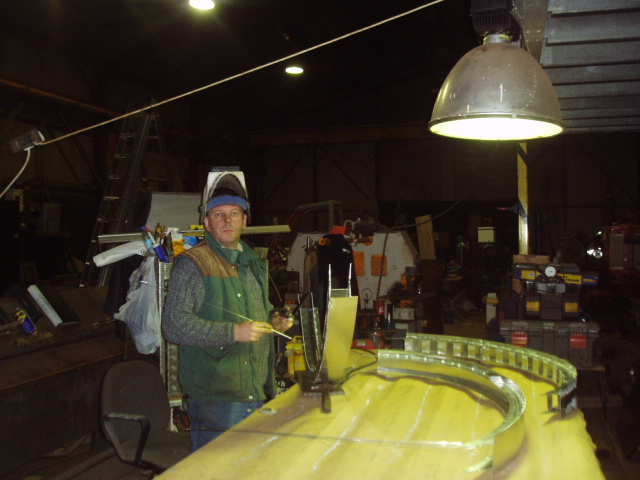

Andrew,
its 125mm sheet with 2 x 50mm curved ribs & a series of 50x70mm long inner pieces to fix the inner lineing to.
will post a different view to make it all a bit clearer.
takes bloody ages to fabricate for something which will be hidden from view.
hay-ho.
head in a bucket for a bit more soon.
when its done, will be dragging to the NE for a jar with you.
im paying.

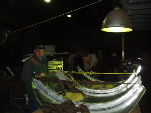

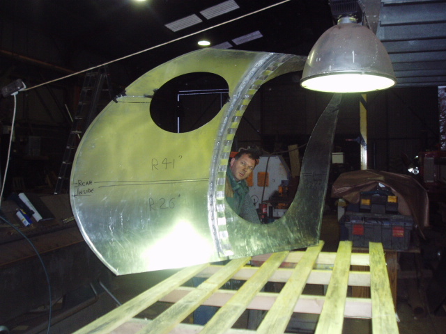

Postby dandan » Mon Dec 08, 2008 4:07 pm
got 4 hours on it today.
it takes a while to weld the struts up.
may try to mig them instead of tig.
couldnt resist a quick clamp-up of the non-door side to see the profile.
will use stainless blind rivets to secure the outer skin to the struts.
may rivet a strip behind the welded joint to give it a bit more strength too. :) :) :)
on it again tomorrow. will post more pics at the end of play.
as allways your comments are welcome.
best rgds dan. :thumbsup:

Postby dandan » Tue Dec 09, 2008 12:55 pm

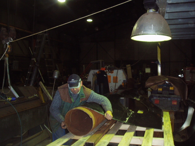

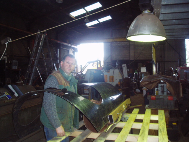

Hello All.
4 hours today.
decided to profile the body panels. it will aid in assembling.
"how do you do that ?" i hear you cry.
with a big bit of tube & 15 stone of un-flexed blubber, thats how. :lol:
i dont mind over-bending the radius, it easily comes back.
riveted the strut in the door side.
then started the non door side.
may be on it tomorrow if my mate who is supposed to be doing my
garden lets me down again.
now its tome for a Hardy & Hansons Old Trip.
best rgds Dan.

roswell build

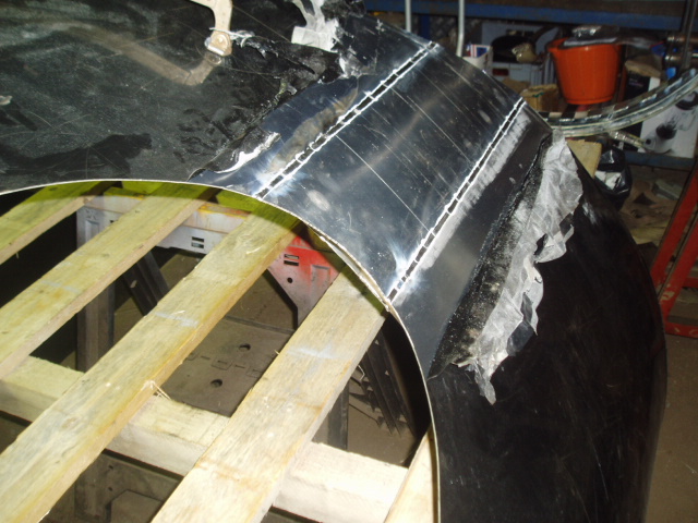

Postby dandan » Thu Dec 11, 2008 9:06 pm
3 hours today.
mostly repair work, i damaged part of the sheet & had to replace it. :cry:
then got on with drilling for the 2 struts on the non door side.
made a start on riveting them on.
the roof is next. this will be fabricated in sections to avoid material wastage.
then i may start to tack the panels together.
thats when it becomes alot more interesting !
still need the material for the 2 front panels, door, base & fenders.
collecting it next weds hopefully.
best rgds dan.
