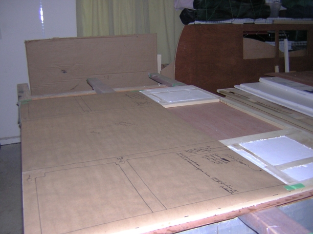

Hi, Trailer fans! :) Here is my progress report and a couple pics for August:
Presently, I’m skinning the walls. Gluing in 100 degree weather can be difficult; but, I am wiping down the frames with a wet cloth before I apply the Titebond III glue. That seems to help a lot. You can see the trailer's back wall on the bench in the foreground and the already skinned driver side wall, leaning against the shelving, in the background to the right. That’s not the final finish. The walls look dark because they have the first coat of CPES on them, to help protect them.
I trace the ‘ribs’ of each wall before I attach the final ‘skin’ and make notations for the part that the paper doesn’t cover. This will make it easier to find the boards and screws after they are hidden by the plywood. You’ll notice that some of the boards have cut-outs in them. That’s because, when I was building the frames, I over-built and am paying for it now. I weigh each framed piece and calculate approximately how much it will weigh when finished. Then, I check my original estimates. If I’m over, (which I usually am) I do a little ‘plastic surgery’ where I can, to trim off unneeded excess and try to keep the weight down as close as possible to my original, slightly flawed estimates.

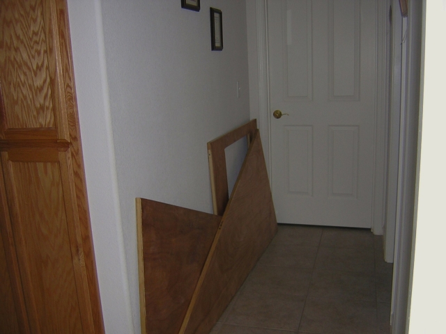

I’m running out of room in the garage; so, the folding walls have been moved inside, to the hallway.

If you think the hall is a kick, you should see the guest room closet! :lol: (Oh, Oh! I'm telling secrets that you might use to persuade your wife with! She isn't going to be happy with me!) I should tell you that I have an 'L' shaped hallway; so, company in the front part of the house can't see my 'storage area'.

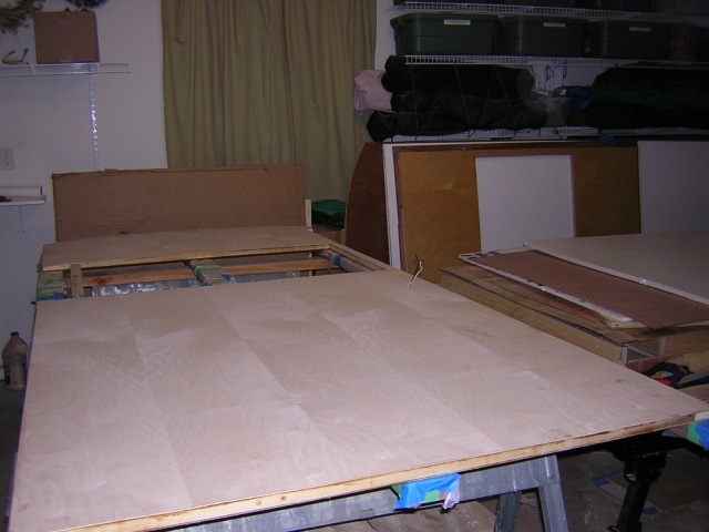

Since I have limited space to work in, I have been buying 2 or 3 pieces of plywood at a time. But, the company that I get my plywood from is running really low and they don't know when they will get more in. (Companies up here, at the north end of the valley, often wait to order until they have a full truck load…saves money.) I guess that gives me extra incentive to get my skinning done!
I just finished skinning the third wall tonight. Tomorrow, I'll clean up the edges. (I'm beginning to see why some folks on the forum complain about sanding and rasping!) As I skin a wall, I'm putting a coat of CPES on the outside and a couple coats of urethane on the inside to protect it from my bumbling self. It already saved me from accidentally messing up one wall. So, tomorrow, the wall in the foreground will also get a coat of urethane.
Since I still have one piece of plywood, I may skin the stationary ceiling this weekend. But, I need to cut out some weight on that piece first as it is 12 pounds :shock: over my estimate. I guess I really got carried away on that one! :roll: Then, Monday, I'll try to get some more plywood to finish the skinning of the rest.
The plan is for the walls and stationary ceiling to interlink when installed on the trailer deck. I was really careful with my measuring and cutting. Here's hoping that when I put them together, they fit!

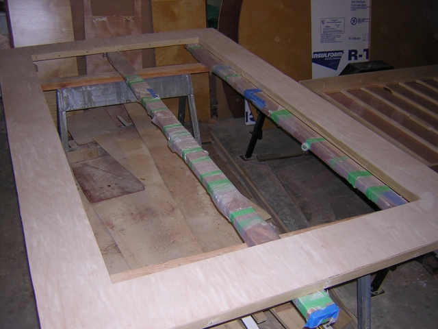

I got the stationary roof’s ceiling skinned and ready for a protective coat of urethane. I thought this might be a good picture to show for two reasons.
1)To give people a feel for the size and design of the roof. The part displayed is the stationary portion and will be about 46 inches high. The empty part in the middle will be a separate roof that lifts up to standing level in the front, slanting down like an attic bedroom in the back.
2)Because Aunti M will like seeing all the sawdust on the floor. There’s plenty of it! :lol:

Postby S. Heisley » Fri Sep 18, 2009 11:12 am
Thanks, Steve. I amazed myself on this one...except for one thing. I discovered I can't think upside down and I planned and cut everything backwards. So, the one awkward plywood joining that is slightly imperfect and was supposed to be hidden behind a cupboard is on the opposite side of the ceiling from where it's meant to be. :duh: Ah, well...Even there, it will be partially hidden by a light fixture. I guess no harm was done.
