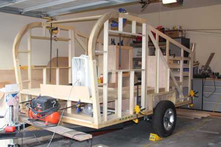

you got carpentry skills!!!
looking real good keep up the good work !
wlivesey wrote:
Do you think this thing is going to be strong enough???
YES! I didn't use that much framing, but of course, My trailer does have weight restrictions. It will be solid enough. FYI - Rayvillian (gary) Gave me some advise on building the hatch. Build it in place and temporarily screw it to the sides. That's what he did and I followed the advise. It was definitely easier and ensured that the hatch fit properly and tolerances were in check. Just gotta love the Aircomperssor mount (never seen one on a tear and the Box fan, but I also live in Texas and in the summer time its needed
aggie79 wrote:Bill,
You are movin' along. If I don't visit soon, you'll be done. Everything is looking incredible!

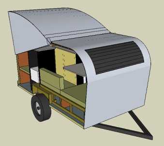

wlivesey wrote:Here is a curved lexan window on a boat. Very cool. It was done by a company called Maritime Plastics. No doubt it can be done... Can it be done by me? That's the question...
wlivesey wrote:I've been making some progress this week but nothing that really makes a great picture so I though I would post a few more pictures of what I'm building. As always, I look forward to your feedback...
I'm thinking of making a dinette instead of another cabinet and potti storage. Something like this... Thoughts? Suggestions?
