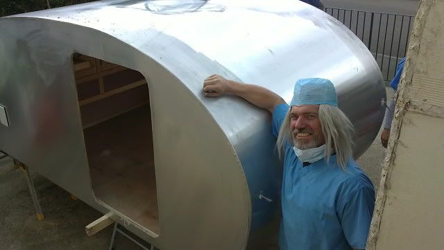

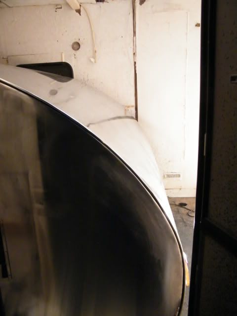

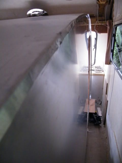

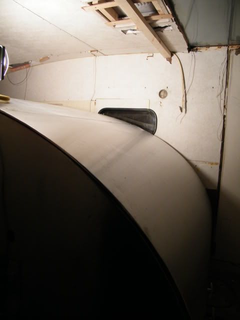

After taking Rosie shopping this morning :roll: I got stuck in to dressing the aluminium around the sides of the galley, sorting the roof sheet, dressing the sides around the bottom, and finally doing the hatch.
I jacked the trailer up and placed a bit of 2x1 under it . so the sheet would sit 1" below the trailer to allow for dressing. It covers the end grain of the ply, and some. The sides are cut flush with the roof, back as far as the hatch, then I've got a 12 mm up stand that allows of dressing over the ply side to close of the end grain.The sides have a bead of silkafex 221 sealant around all the edges, and any opening like the electric hook up box, and the fridge vent and exhaust.
It's not easy trying to take photos in such a limited space...in fact it's not that easy to work in said space either. :lol: :lol:
Here's the ali photos
The extra 12mm height by the galley wall will get dressed flat
It's nice to get a bit of sealant ouz out when it'd dressed

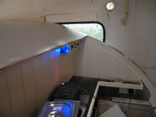

This is my working space :lol: :lol: I think I was lining up the roof sheet before dressing it into the galley

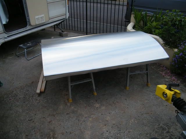

I dressed the hatch on a couple of stools on the drive as there wasn't enough room to do it in the workshop
It fit's :)
This is how we're looking tonight
We're out tomorrow night , but I'm hoping to get it polished , and get the hinge and vents fitted during the week, ready for the 'birth on Friday :lol: :lol:

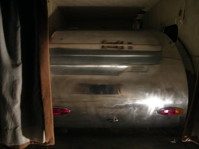

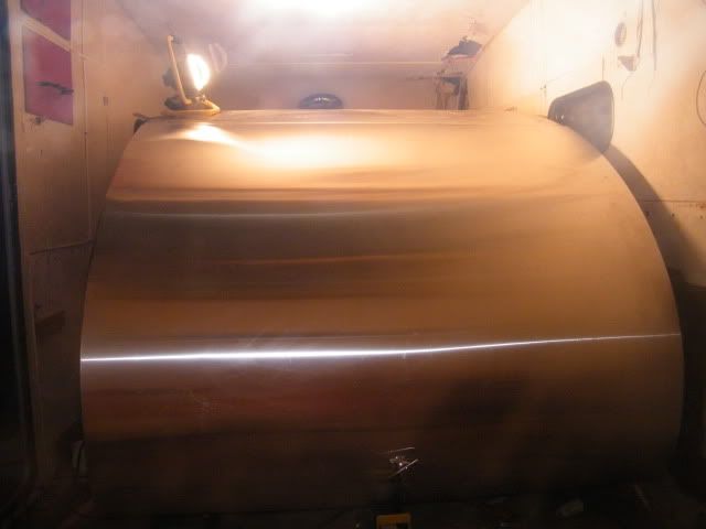

I've only got the trailer partly polished , but we've been at it again tonight , in preperation for tomorrows event :D :D

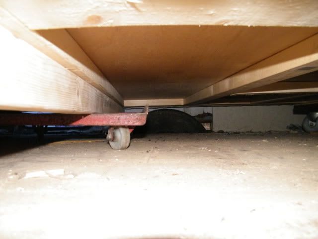

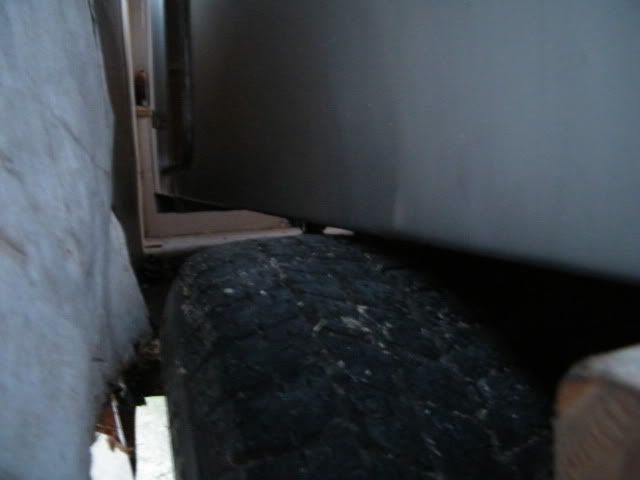

I don't know what I was worrying about with space to get the wheels on :? Theres at least 1/4" clearance on the wheel :lol: :lol:

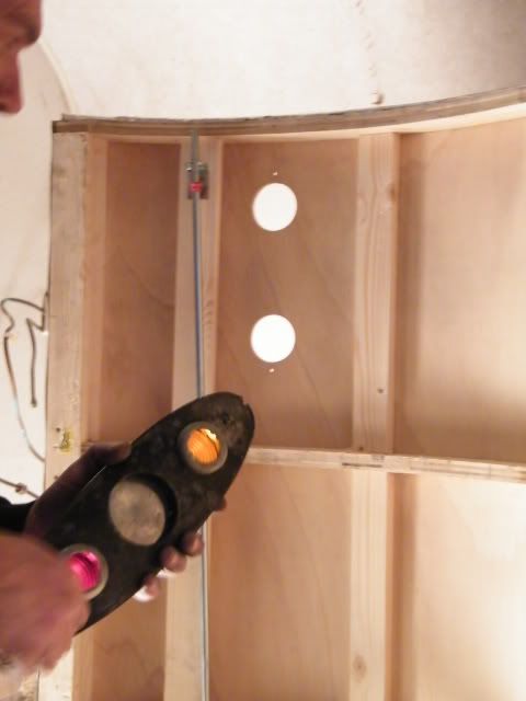

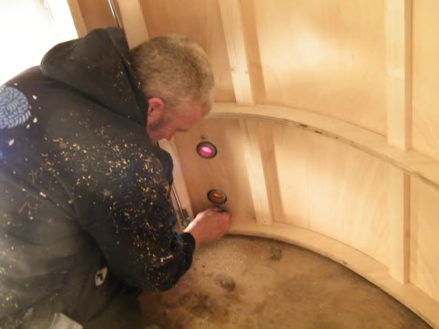

I thought I'd mount the road lights as a last job in the workshop. They were marked out on the ply, and small holes drilled before the aluminium was put on. Rosie was out helping clear everything away , and caught me in action

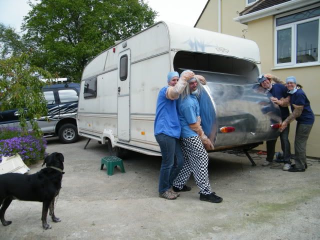

Postby jackdaw » Sat May 15, 2010 2:21 am
Had a great day with the Birthing. Mr and Mrs Furryflaps were at here to help with midwifery :lol: :lol:
As you can see ..... it's a little trailer...well what else would you expect :?
The women were at hand to mop our sweaty brows
Proud Dad :lol: :lol:
Proud uncle Flaps
A bit of clearing up to do in the morning
