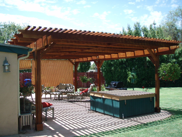

The pergolas- :hammer:
The first one is huge- 20x30 with doubled 2x12 beams- freestanding- and it survived our Easter earthquake. :thumbsup:
The second is my back yard, messy as it is, it is 15x30 and has a funny story or two concerning construction- I’ll buy any one a drink if they remind me to tell the story around the campfire. This offer is only valid in person, while supplies last. :beer: or if you prefer :wine:

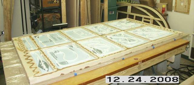

I too had bought a HF tongue jack and found it to be combersome, heavy and most of all noisy. Also my tongue weight is like 15 pounds. I just lift my camper off the ball and shove it into place. Then Andrew commented on something for use in such a light trailer - a simple piece of rectangular aluminum tubing with holes drilled in it at intervals. This goes through a short section of slightly larger tubing with one hole in it. Then you just lift the tongue to the proper height and put a pin in the proper hole. I'm fabbing one right now.
I also seem to recall (maybe in the original Ultralight thread) that Andrew said that continous crosswise members are better in the floor for some reason. So that's what I did:
1/4" luan top and bottom, 1.5" framing members ripped from wider framing lumber, thickened epoxy adhesive and staples, and ultimately fiberglass and epoxy top and bottom. No frame at all. This floor is flat to within 1/16".
