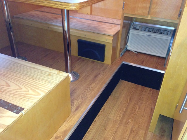

More sporadic construction. Finished the flooring using stick-on tile floor planks. The sides of the dropped down floor box have been finished with panels of thin plywood covered with black indoor outdoor carpet.
Next up is work to seal the shower area with epoxy and then paint it.

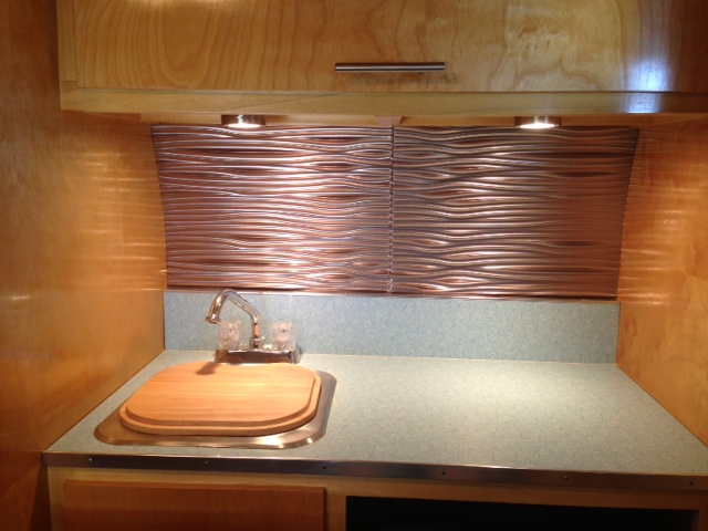

I installed the backsplash a while back but never uploaded the photo. Here it is.
Jerry

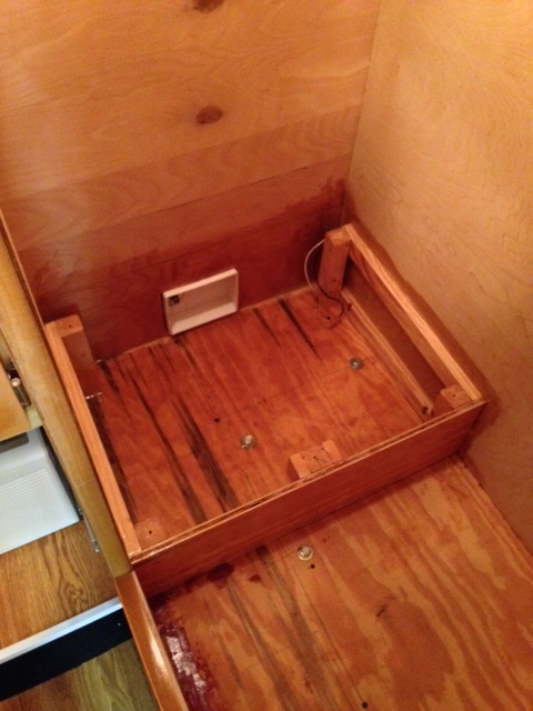

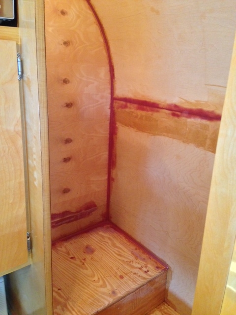

Thanks all. Got a little more work done. Concentrating on the bathroom area now. Removed the toilet, and the ledge it was sitting on. Sealed the area with three coats of epoxy. Water should never get down there, but if it does, it won't rot. There is also an access door from the outside to this small storage area, visible in this picture.
That done, I reinstalled the board, sealing it with epoxy, and began filleting all the corners with epoxy as well.
The floor drain I ordered should arrive this week and I will build the shower pan. Pics to follow for that project.

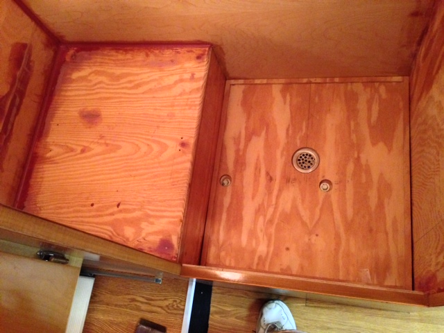

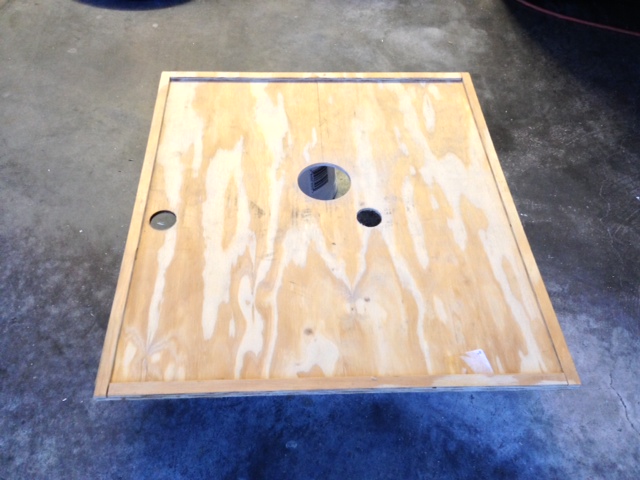

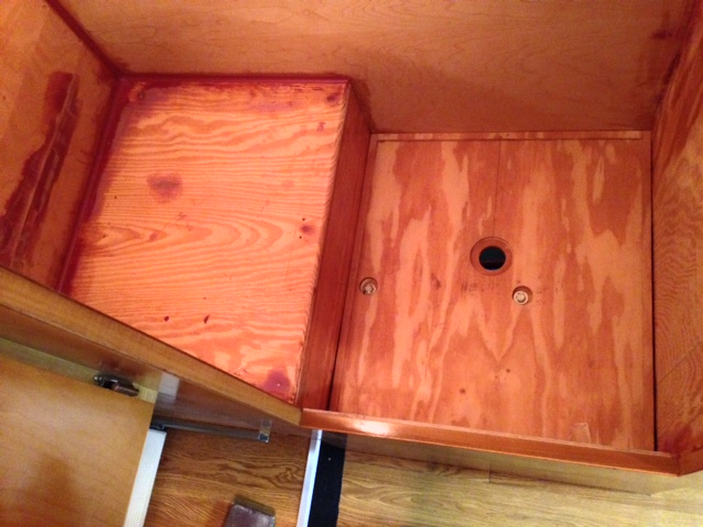

This is what I came up with for the floor drain. Here's the shower pan. The two smaller holes are to clear existing bolts and will be filled with epoxy. Epoxy with West Systems 407 filler will also be used to fill in the pan, from the lip that surrounds it tapering down to the drain hole.
This shows the pan installed over the existing floor. The drain actually bolts into the floor, not the drain pan. Epoxy will also fill the gap between the pan and the wall.
As you can see here, the drain is just below the drain pan, so water should flow down and out. That's the plan anyway!
