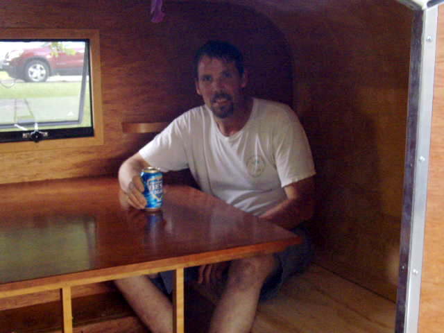

Postby justafew » Tue Apr 27, 2010 4:27 pm

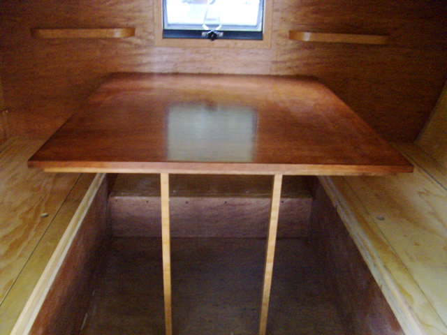

Thanks for posting so many pictures...it really helps! I am especially interested in examples of tables in the cabins and how folks are installing them so thanks for your descriptions!

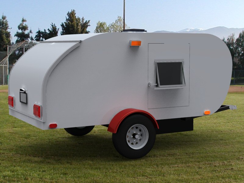

Postby rwelp » Thu Apr 29, 2010 11:04 pm
Here is the 3d rendering Mike sent me of the tear I am building.

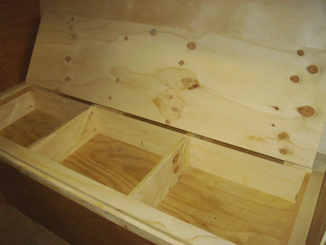

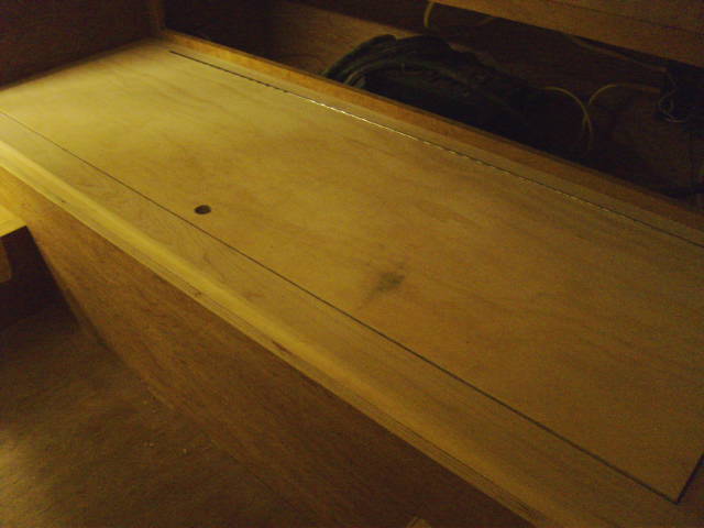

Postby rwelp » Sun May 09, 2010 12:12 am
Finally got around to getting pics of my finished bench seating in my tear. Lids are hinged with piano hinges and have 5 3/4" of storage beneath.
I also put on the first layer of roof skin. I plan on putting on a second layer of ply along with epoxy and possibly fiberglass cloth, prior to painting with marine polyurethane paint.

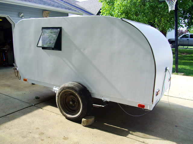

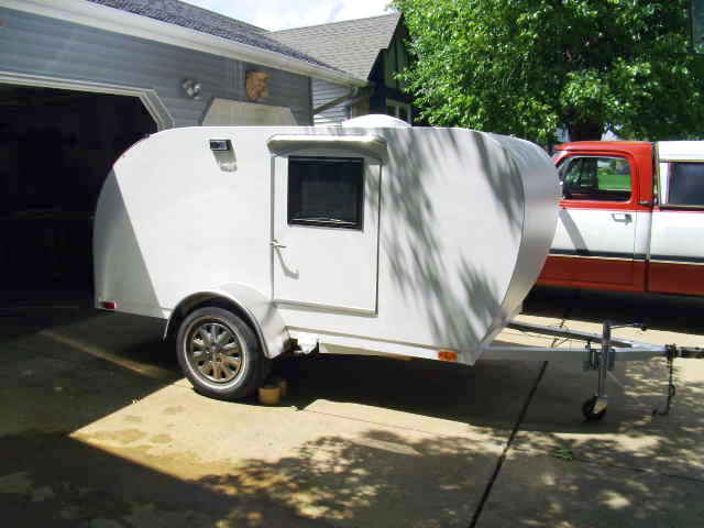

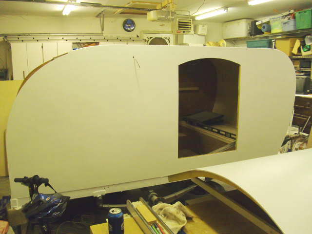

Postby rwelp » Tue May 25, 2010 9:51 pm
Well, here she is with 2 coats of epoxy, 2 coats of bonding primer, and 1 coat of paint(2 more coats to follow). I decided not to use marine paint because of the high gloss. I chose a satin exterior paint from Sherwin Williams instead. I am happy with how it looks so far. I am not going to make my deadline of this Memorial Day weekend(surprise, surprise), but it will be done(campable) within a week. 8) :thumbsup:
The hatch:
The door:
Rob Welp

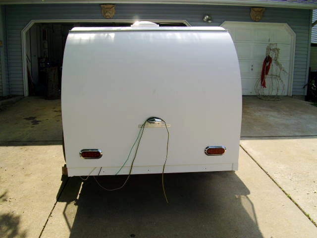

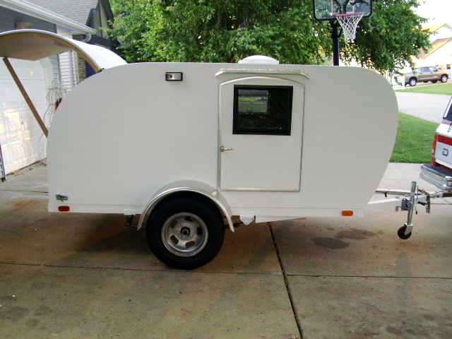

Postby rwelp » Wed Jun 02, 2010 6:55 am
Almost done now. Still need to get the fenders on and finish the wiring for the trailer lights(marker and turn signals). The interior electric, both 110 and 12 volt is done. Fantastic fan is in and working. Still a lot of little things to do, I have to finish the table and build the tongue box, but it is almost campable.:applause: ;)

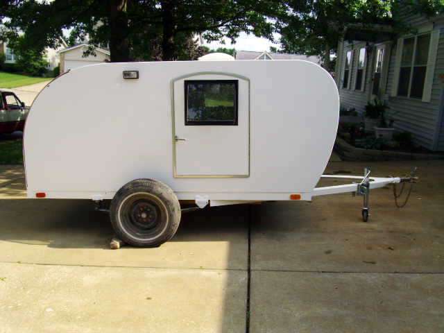

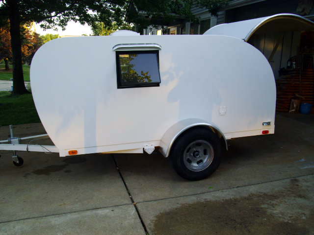

Postby rwelp » Tue Jun 15, 2010 7:18 am
Got the fenders on and added some wheel covers. But I discovered that the axle was not built to any standard. It only has a 5/8" spindle and homemade spindle lock nut. There was some slop in the wheel bearings because of this and I could not tighten the nut any further to eliminate it. I found a local trailer dealer who is having a custom axle made for me for $160. It will be made to fit my trailer, so I will be able to put it on without any problems. I will have it by 6/25/10. In the mean time I will finish installing the hatch trim and latches, and build the tongue box. I also picked up some aluminum wheels that I will put on when the new axle comes in.

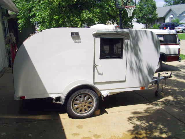

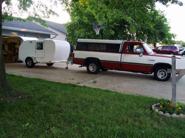

Postby rwelp » Thu Jul 01, 2010 1:12 pm
Still unsure of the final name, but it's campable. Maiden voyage will be this weekend(4th of July) It's been 5 months since the start of the actual build. The new axle is on, along with different wheels and tires. The toungue box still has to be built, but that will be down the road a little yet. 8) :)
