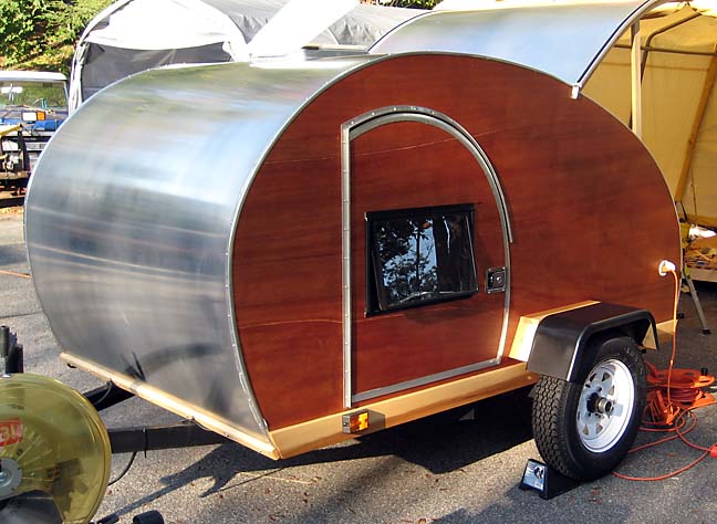

I am thinking about changing my door profile. I Think my Ultralight side profile should have a different door, but I would like your opinions. I can still change it to anything I want so If you have an opinion on the best looking door for what I think is a great side profile, please chime in. My side will not have the outside framing like the Mike's original design, I'm just using the side profile shape. Any and all suggestions, opinions are welcome, along with CAD drawings :lol:
Here's the original door, looks good with the outside framing:
This is my new door design:
This is just the template against the inside paneling, the actual door will be cut from the paneling and the rest of the sandwich.
Also, I like this door on Tom's exquisite "Silver Beatle" but I am not sure it's right for a 5X8 with rounded front.
Thanks,

Postby S. Heisley » Sat Feb 04, 2012 7:01 pm
Larry, with your planned design, I like your demonstrated template door he best. Your teardrop looks like it's going to be beautiful. :thumbsup:

Postby Shadow Catcher » Sat Feb 04, 2012 9:05 pm
I will second Sharon. The new profile flows.
Postby Larry C » Sun Feb 05, 2012 10:39 am
I may have made a critical error? I want to use Grants 12X18 crank out windows. The radius I have in my new door design may make it so the window is too low? Does anyone know the actual outside dimensions of the 12X18 window? I may have to redesign the profile to be more like this:
Thoughts please...

Postby Juneaudave » Sun Feb 05, 2012 11:24 am
Looking good Larry! Don't cheat yourself on door width and height. I quick ran out to measure the windows on my trailer and realized that they are the larger ones from Grant (24 x 15) with 25 1/2 by 16 1/2 out to out... so you are picking up an additional 1 1/2 for the frame.
My trailer is a big larger than the norm and my doors are 32" wide...for what it is worth. How wide are you looking for your doors? I can't tell by the pics...

Postby aggie79 » Sun Feb 05, 2012 1:37 pm
Larry,
I like your new profile for the door. It goes well with your overall teardrop profile.
A side benefit of not having corners on the latch side of the door is that the radii will allow a single piece of trim on the door edge and/or the jam. (It was a bear fitting the trim on my doors.)
I have Grant's 18" x 15" windows. The mounting flange is 3/4" - I measured - so the o/o dimensions are 19-1/2" x 16-1/2".

Postby jonw » Sun Feb 05, 2012 3:04 pm
Hi Larry -
I did something similar to what (I think) you're thinking.
I used a double radius to make the door shorter and wider yet still conform to the overall design. The door width at the bottom is the same as Mike's design. I wanted more wall above the door to control flex without needing to build in a header above the door.

Postby Larry C » Sun Feb 05, 2012 3:07 pm
Juneaudave wrote:Looking good Larry! Don't cheat yourself on door width and height. I quick ran out to measure the windows on my trailer and realized that they are the larger ones from Grant (24 x 15) with 25 1/2 by 16 1/2 out to out... so you are picking up an additional 1 1/2 for the frame.
:thinking: :thinking:
Dave,
The doors are 39-1/2" X 28" Wide. I think that should be big enough, but I will probably have to reduce the radius.
Larry

Postby Larry C » Sun Feb 05, 2012 3:21 pm
aggie79 wrote:Larry,
I like your new profile for the door. I goes well with your overall teardrop profile.
Take care,
Tom,
I guess I should have read the size correctly, 15 x 18, not 12 x 18. The actual flange size being 19.5 x 16.5 is definitely going to change things if I want this window. Actually I won't be using door trim. I am using Steve Fredrick's flush door method.

Postby Larry C » Sun Feb 05, 2012 3:35 pm
jonw wrote:Hi Larry -
Jon,
I do like what you did with your door, especially the continuous curve, but what I am trying to avoid is my window being in the center of the door rather than closer to the top. I know that many people feel that lower is actually better because it allows better air movement closer to your head. However, to my eye, it looks better higher up. I will layout a similar profile to yours with less top radius, but with the same bottom radius to see how it looks. How wide is your door now?
