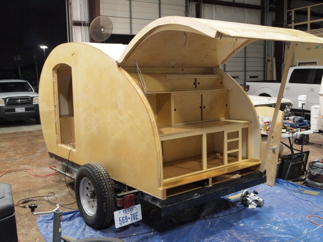

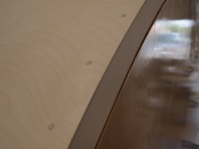

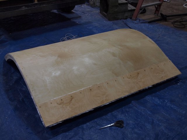

We started out the day by flush cutting the overhang on the hatch.
The we drilled out the screw holes and plugged them with poplar dowels.

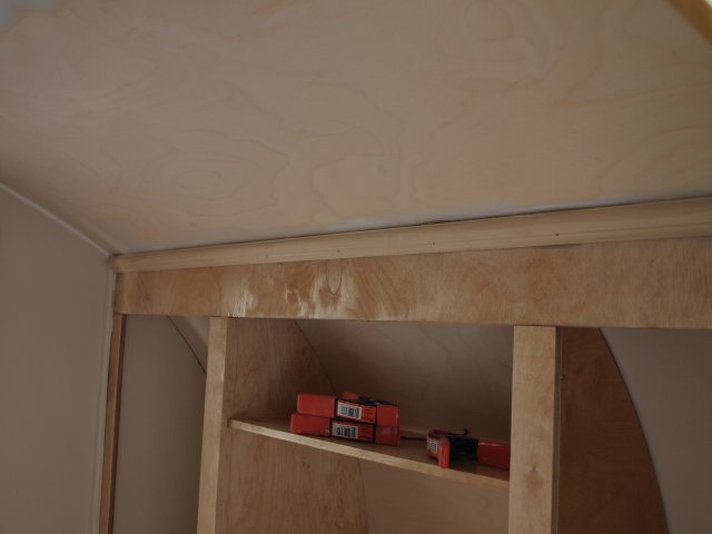

We installed some interior trim.
Then we added another piece to the bottom of the hatch to extend it and then fiberglassed and epoxied it.
The roof edged where it meets up with the sidewall still had quite a few areas with air bubbles in it so we sanded off the top edge.
We installed one of the door latches.
Then we sanded down the whole thing and applied another coat of epoxy.

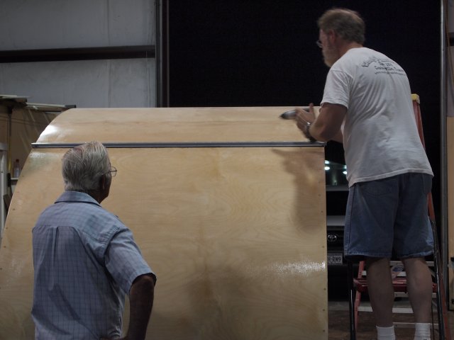

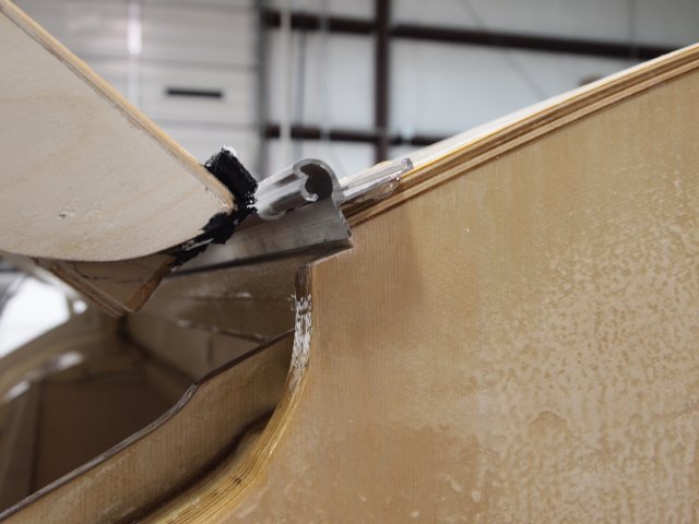

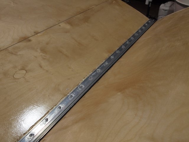

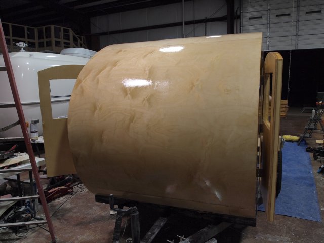

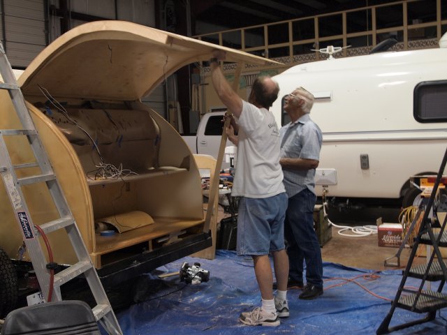

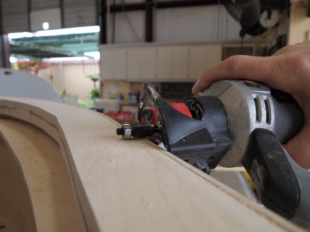

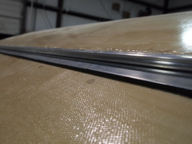

Then we sanded down and epoxied the hatch again, and after it dried we started working on the hurricane hinge. We cut it to where there is a 3/8" overhang on each side and mounted the hatch side first. On this side, we used the butyl tape we purchased from the RV parts store. Then we test fitted the hatch with hinge to the body, the gap for the hinge was too small causing the hatch not to sit down like it should. After studying the situation, I got out the bar clamps
and strapped a board to the roof and using a 1/2" router bit, I routed off approx 1/2" off the rear edge of the roof.
Now the hatch fit much better, but since we had put two 1/8" pieces on the roof and only one on the hatch, we decided that using silicone on the top hinge piece would let us screw it down tighter than the butyl tape and give us a better alignment of the hatch.
Of course the next step was to open and prop the hatch.
And then to stand back and admire our hard work.

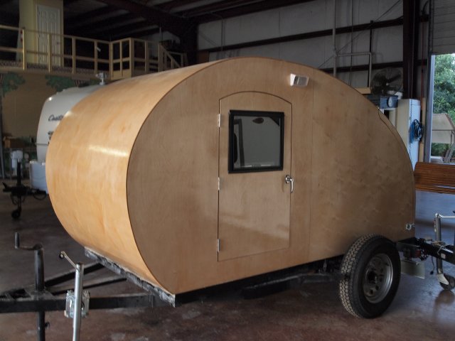

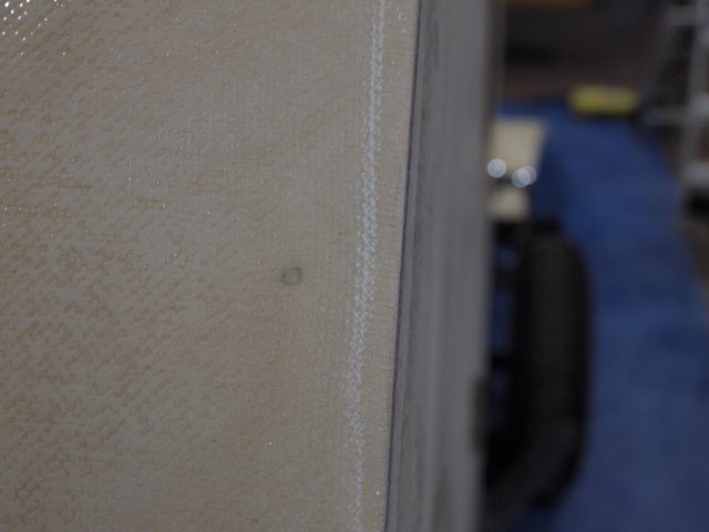

Postby Alan and Lianna » Mon Jun 14, 2010 12:51 am
Today we started out by epoxying the door frames with the fill it epoxy to smooth out some the edges.

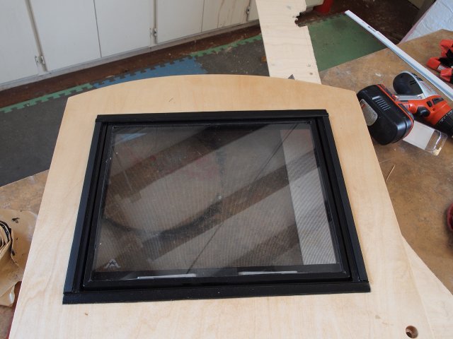

While that was drying, we installed the windows into the doors sealing it with the black butyl tape.

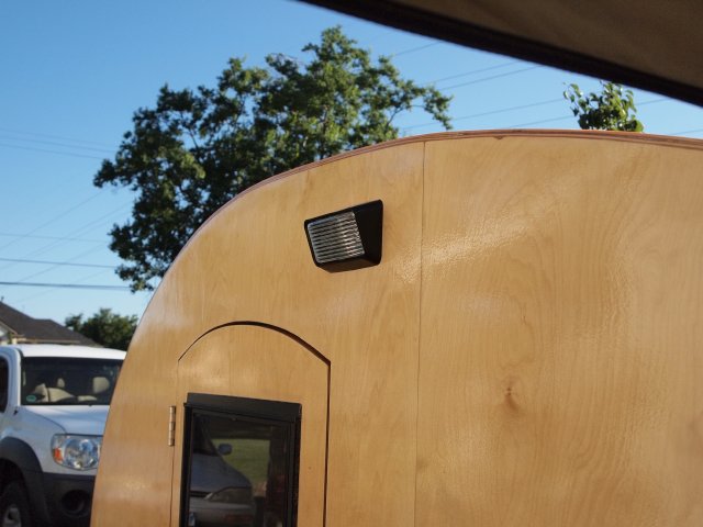

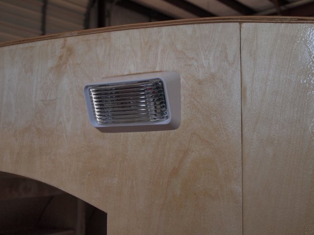

We installed the exterior lights, sealing it with silicone.
We cut a piece of red oak and mounted the hatch handle.

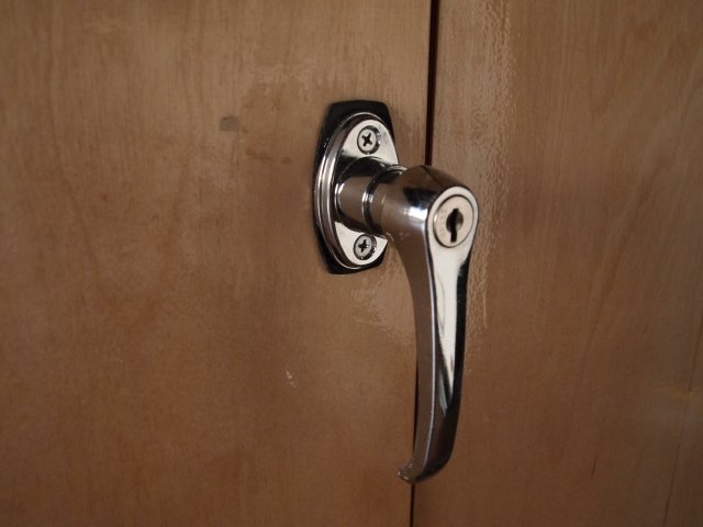

We installed the hatch latches.
We installed the door handles, they are still tight to turn and may need some more work, but they are functional and hold the doors tight against the rubber door seals we installed.
We rehung the doors.

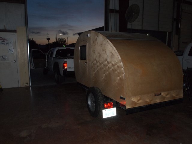

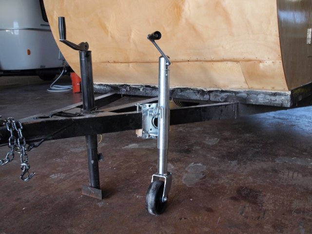

We installed this swivel jack, well actually 2 days ago, because the original jack has a foot welded onto it.

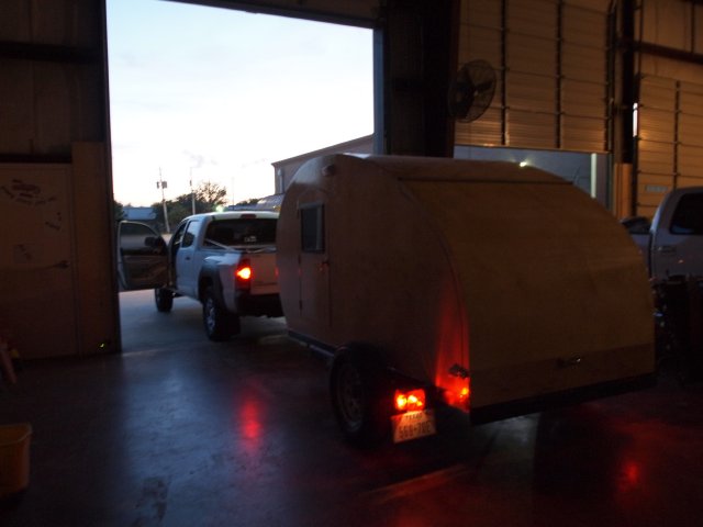

We cranked it up and hitched it up for the first time.
Ready to roll into the sunset...
Well actually it was a little after sunset, but we did drive it approx 10 miles to show it off to some family and friends.

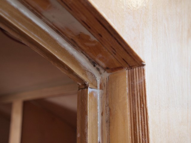

Postby Alan and Lianna » Mon Jun 14, 2010 12:31 pm
Alan and Lianna,
I bet your family and friends were impressed. Your build is something to be very proud of.
I'm trying to figure out my doors. If you get a chance could you take some pictures showing your inner door seals and strike plate, please?
Thanks, Tom

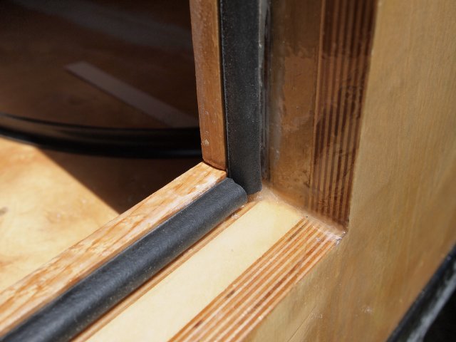

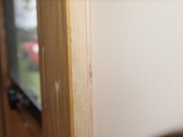

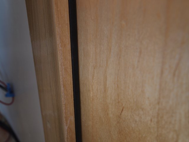

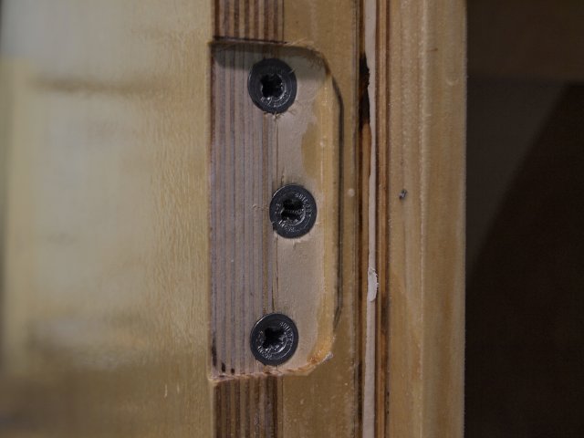

Thanks Tom, yes everyone has been impressed so far, as for the details of the door. The inner door frame is a 1/2 x3 with a 1/8 x 2 1/2 inch spacer to create space for the seal.
We then covered this with a door seal.
When you close the door the seal compresses like this, it is pretty tight at this time.

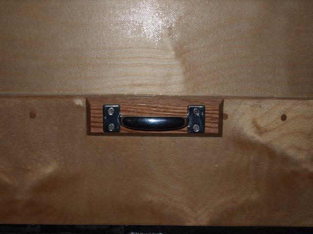

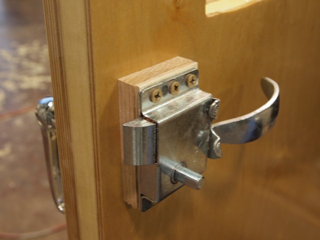

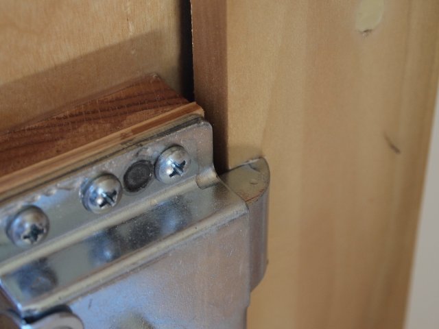

And here is the latch detail, it is mounted on a spacer that is the same thickness as the door frame. There is no strike plate at this time, I will add one later.
I may add another 1/8th inch spacer under the latch before I install a latch plate.

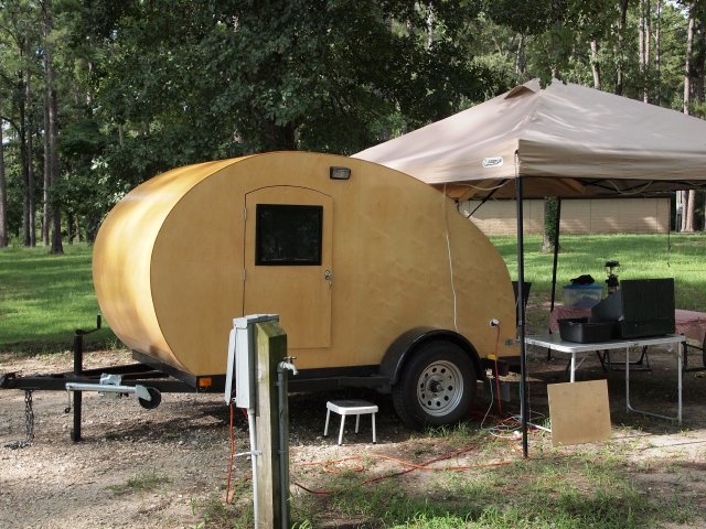

Postby Alan and Lianna » Mon Jul 12, 2010 10:22 pm
After getting the teardrop home, we found the exterior lights in black, so we changed them out.

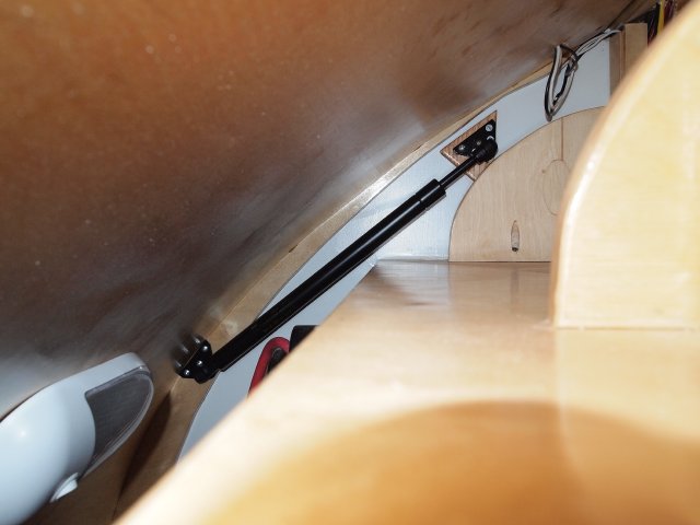

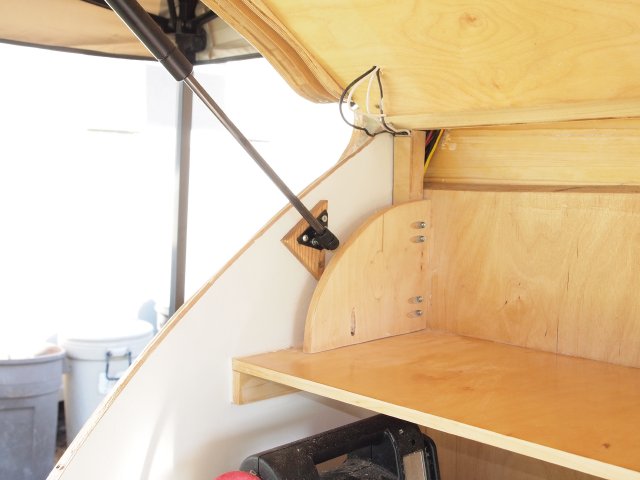

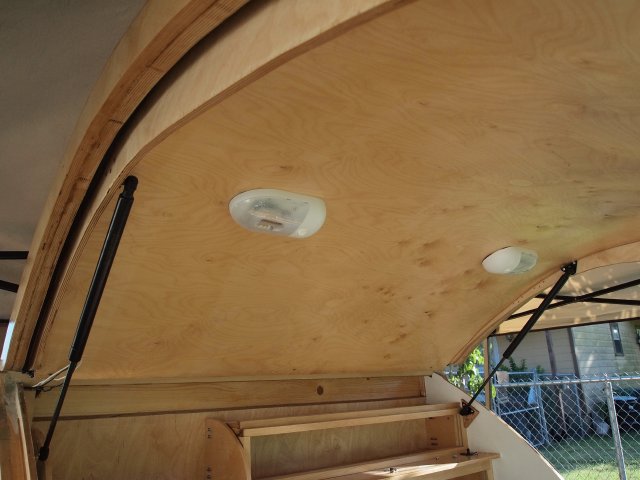

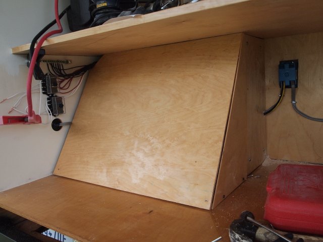

We installed the hatch struts
We installed some LED hatch lights

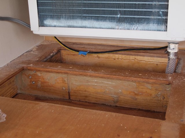

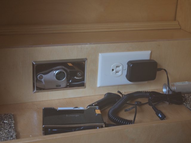

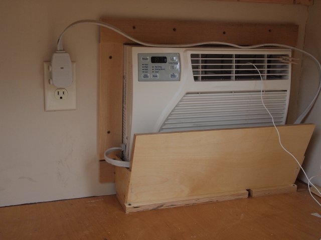

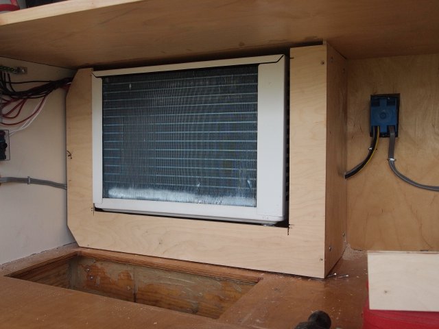

We installed the AC and rear outlets

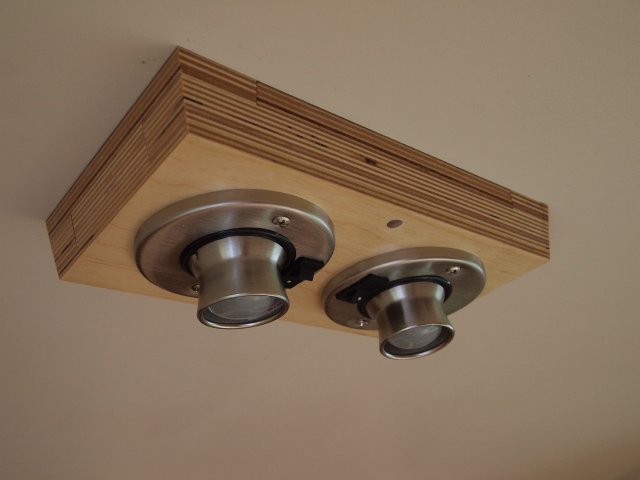

We installed some interior lights

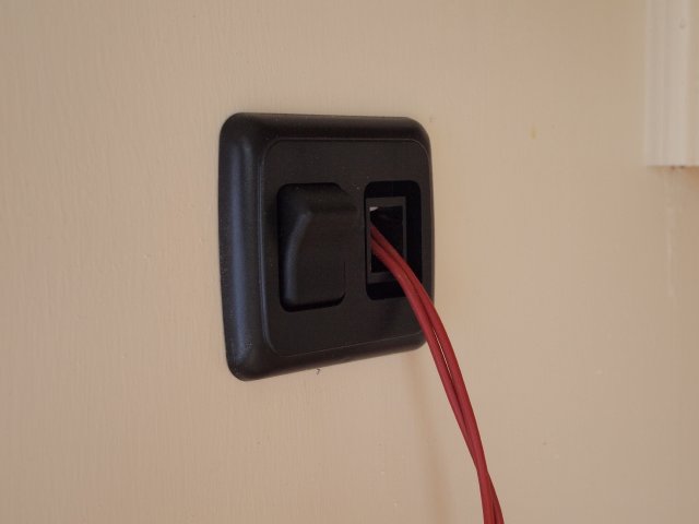

We installed the lighting switches, the exterior switch was missing here because we received the wrong ones, but have since been installed but failed to get a good picture.
Lianna pulled the sewing machine out of mothballs and in no time we had curtains.

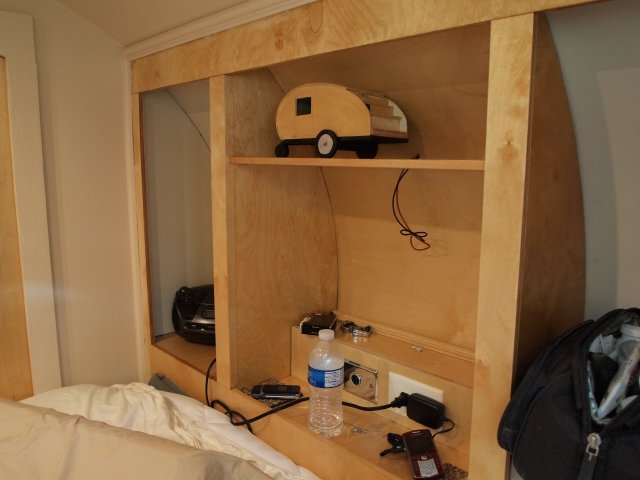

We installed outlets at the front cabinets
Installed the shore power inlet

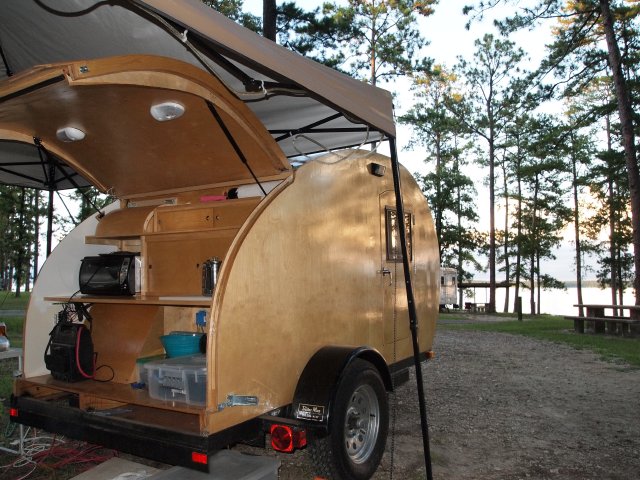

Applied several coats of polyurethane to the interior and galley, another coat of epoxy on the exterior, welded the fenders back on, finished up most of the wiring, sanded and painted the trailer, installed some led marker lights, threw in some bedding and supplies and went camping...
We camped July 5-9 at Powell Park on Lake Sam Rayburn, we slept really good, the camper towed with no problems, and the camper drew a lot of attention everywhere we stopped. We can't wait to finish up the drawers and cabinets and go camping again, of course if it is good weather they may have to wait..

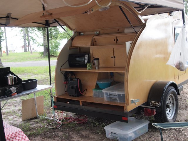

Postby Alan and Lianna » Wed Aug 11, 2010 5:03 pm

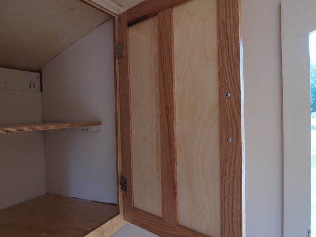

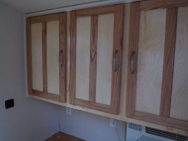

We, have been busy lately putting multiple coats of varnish on the exterior, so that looks the same. This last weekend we broke down and purchased a router table and wood to work on the cabinet doors. We framed them in red oak with birch panels and hung them today.
The Rear Cabinets
And the front
We're going camping again this weekend, so this time everything should not end up in a pile in the middle of the bed by the time we get there...
