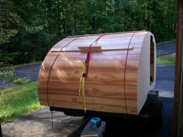

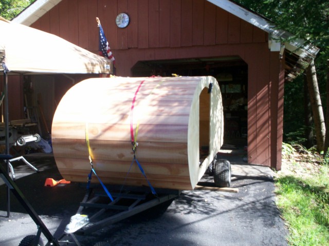

Postby sschevel » Sat Aug 28, 2010 12:32 pm
Well I did pre-bend the roof with some straps and then 2 days later I realized that I bent them the wrong way so I had to re-bend. Delays let them stay bent for over a week and when it came time to get them on, they went on very easy. Easy enough that I did them by myself..........

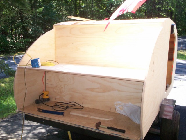

Then I cut the galley lid off and started work on the galley and doors. I would like it done well at least ready for camp in 3 weeks or so......cross fingers.

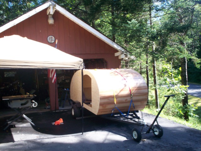

Outside;

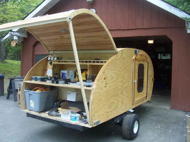

Open galley;

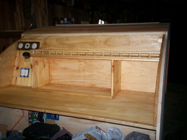

Galley done minus 2 small drawers;

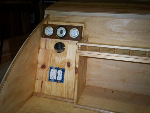

Galley power;

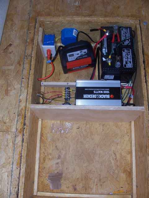

The box came after I had the floor down but before sealing the floor. Since the box has the battery, shore power connector, inverter for "off shore" power and a small area that I plan to use for power cords, the only reason to get into the box is to switch between shore or no shore and get out the shore power cord.

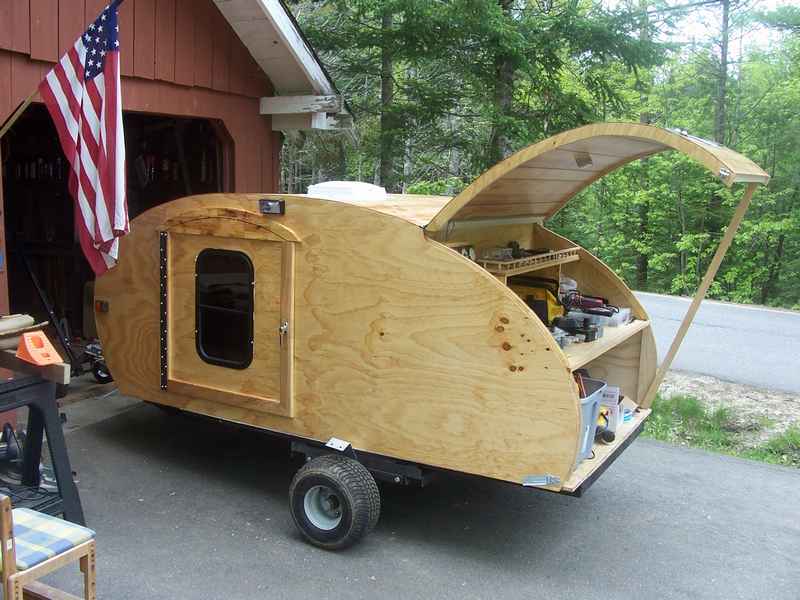

Postby sschevel » Sat May 28, 2011 10:27 pm
Well things are coming along. Doors with windows on, galley hatch on, lights in/on/done.

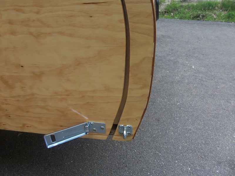

I have discovered that my hatch has sprung slightly and I was not confident about using a single latch in the center of the hatch so I have put a pair of these latches on.
Then there is my drop box with battery, charger, inverter, and wiring hub for the trailer.

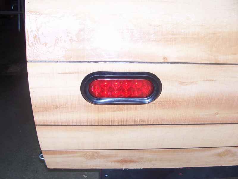

LED tail lights
Course the details take some time and it is likely that a teardrop is never really finished, but I think a few hours and we can give it a test run to a campsite!

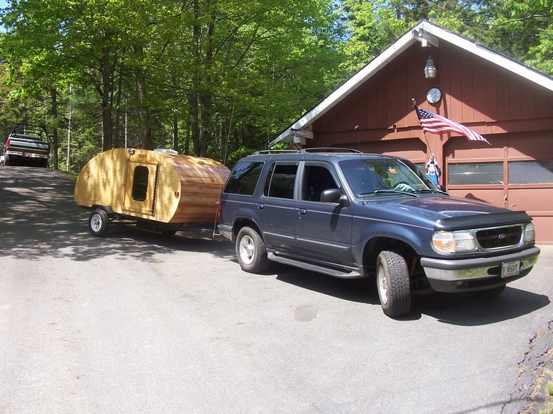

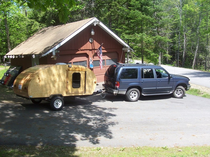

Road test completed
Postby sschevel » Wed Jun 01, 2011 6:57 am
First day on the road and every stop had someone asking questions, making comments, and surprised at what I had behind the truck.
