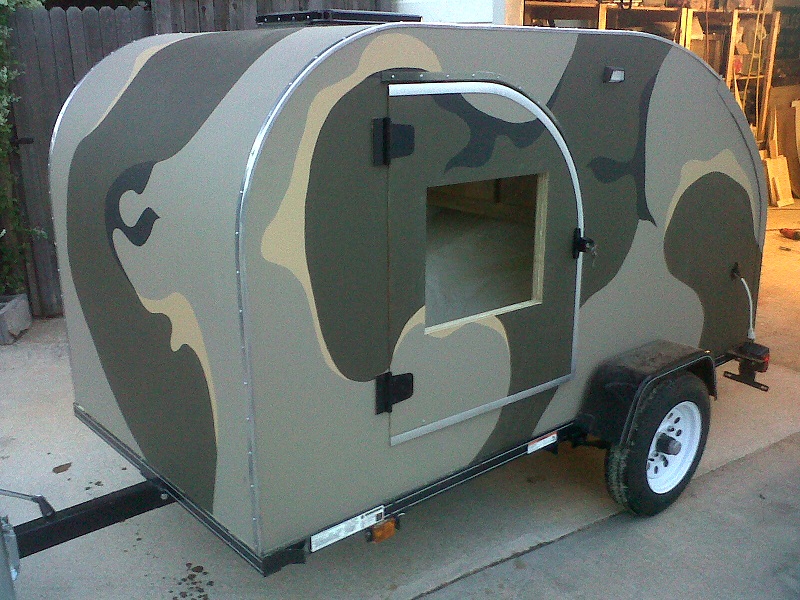

Thanks, I really appreciate the comments. I saw a couple of build logs with the running totals and I found it helpful. Thus far I'm still within budget and there have been no big problems. I'm still waiting for my last batch of parts to arrive from Lil Bear and I'll finish up.
Azmo, I understand your thoughts. Building is fun but using it is even better! If I could get one close to what I want for the build cost I would have done it in a second.

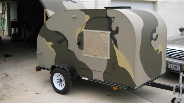

In the last couple of days I put in 2 hours enlarging the windows to the correct rough-in size for the windows from Lil Bear and I made the edges to cover the pie cuts on the side rails. I'll get them attached in the next couple of days.

All of the aluminum is done: T-molding on the doors, edge molding and drip caps. I also installed the door handles.
I'm still waiting on my windows and seals from Grant. The windows got backordered and should be here anytime.
I'm going to finish painting in the mean time.
I added windows, trim, latches (door and hatch), more screws, T and drip molding and the hurricane hinge to the totals.
RUNNING TOTALS: $2435.85 and 119 hours.

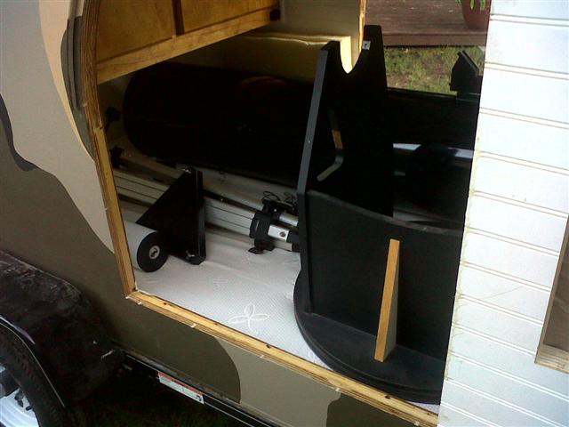

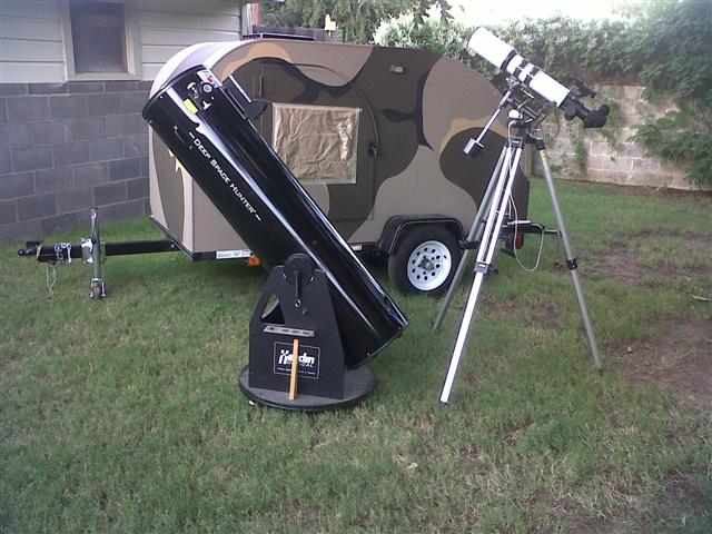

Here's a pic with the scopes set up for use. One is a 12" Newtonian/Dobsonian and the other is an 80mm refractor on an equatoral tripod mount. The rest of the gear fits in a small briefcase sized box and a backpack.
Here they are packed for travel. The big one will be in a zippered bag and they'll be padded with a furniture blanket.
By sheer luck the regular Benroy profile makes it possible to load all of this gear without any hassle and has the bonus of all your gear riding on a mattress!

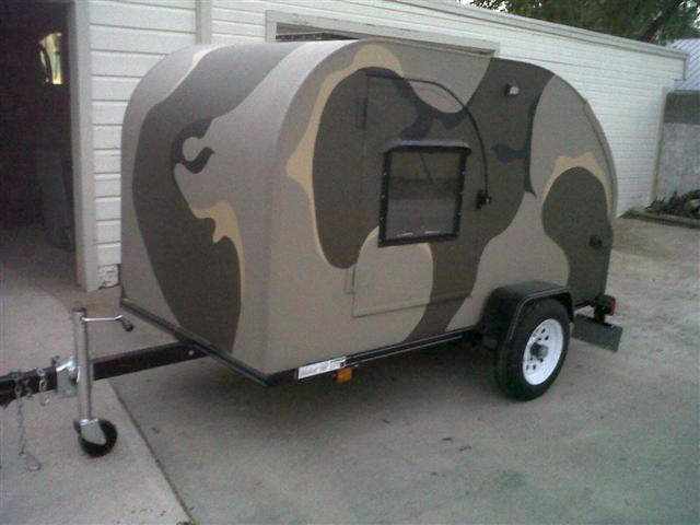

My neigbors were curious about the camoflage "thing" I built in my garage. I think they were more concerned when I parked the mortar tube telescope next to it.

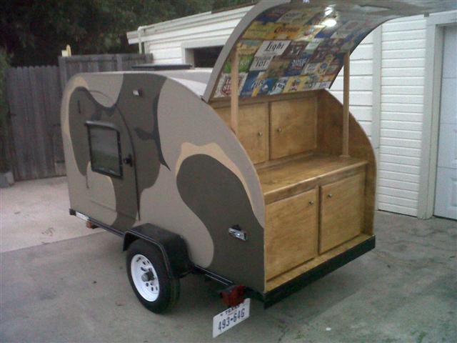

I bought hardware and metal to finish the back bumper, hatch latches and hatch supports. $24.50 and 4 hours.
It's now completely finished except for touch-up paint on the new stuff and my windows. I'm still waiting for Grant's supplier to make them. According to the last email they could show up any day now.
I'm going to cover the inside of the hatch now that I've put the supports in. I was undecided on how to do it, so I went non-committal with a minimalist setup until I come up with something better.
The cheesy stock license plate frame on the tail light isn't gonna cut it. It's too frail and close to the ground. I guess I'll need to come up with a lighted frame and run a wire to the hatch. Oh well, another day...

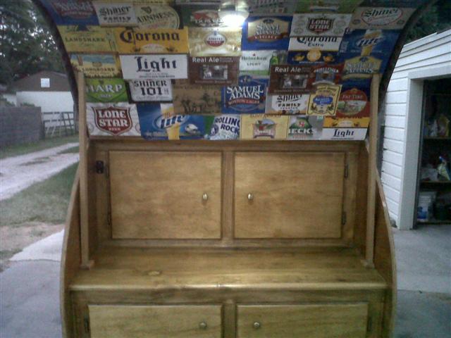

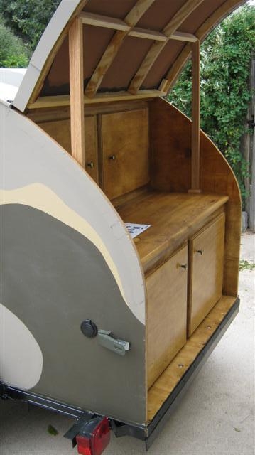

The "wallpaper" on the galley hatch isn't complete, despite saving labels for quite some time. I'm thinking about throwing a party and collecting donations! There are plenty of little things I'll work on here and there, like powder coating the wheels black, etc. I don't think something like this is ever truly finished but it's ready to go.

Postby DesertSkies » Fri Nov 19, 2010 11:56 am
Thanks, Sharon! The wallpaper took three attempts to get the adhesives right. The falling temperatures made the adhesive fail completely so I had to use wood glue backed with staples.

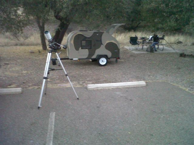

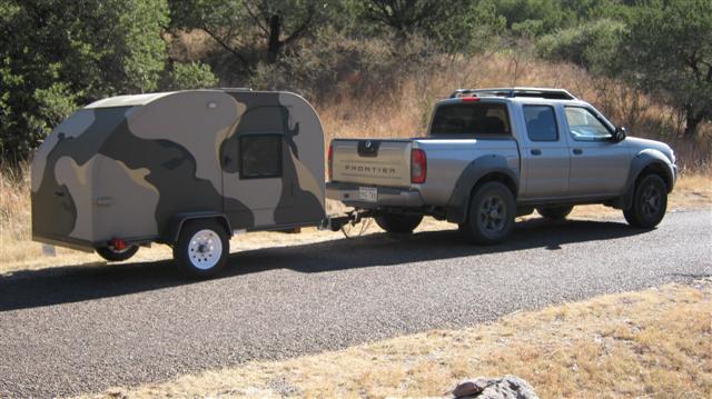

We took the new camper out for the first time last weekend. We made a trip to the state park in Ft. Davis, TX. All went well except for a few minor things.
The first thing to change is bedding. We're ditching the sleeping bags in favor of flannel sheets for cold weather. Second, the "pillows" I made out of scrap mattress material were not comfortable. They're out the window as well. We improvised curtians for the trip but the permanent ones are int he works.
I'm making a bottom hatch seal out of paintable garage door weatherstripping. Some road dust had worked its way in as did water when I washed it after the trip.
That's it for the negatives. Other than those few hitches it was perfect. It towed so well I forgot it was back there. We pre-heated it with a stove before going to bed and stayed comfortable. We're veteran campers so it took one trip to completely square away the galley. All we need for a weekend getaway is waiting for us!
Future projects include a forward battery box/spare rack and powder-coating the wheels black. The white is really annoying me!
We weren't far from McDonald Observatory and the entire area has pretty firm light polution rules so the skies were great!
