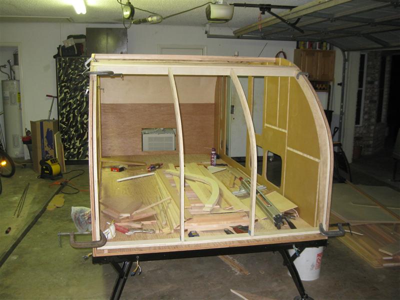

Here are a few pics over last couple months. Gluing up the sides, installing the ceiling, and assembly
Working on the test hatch

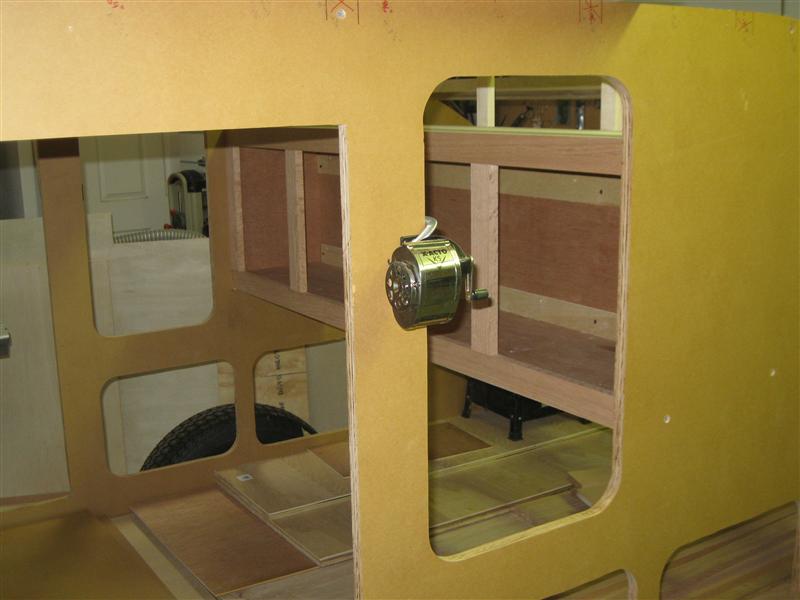

Postby Wolffarmer » Tue Jun 14, 2011 10:24 pm
Yes, leave the pencil sharpener. I bet a person could make it into a porch light.
:lol:

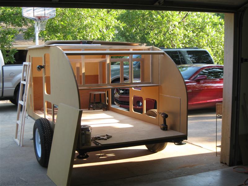

Well I’m back… It has been a roller coaster summer. My oldest son got married, middle son totaled out the expedition, and father-in-law passed away. If you smoke please quit, there is no better time than now, it’s not pretty when you’re forced to quit. Man it has been HOT!!! We are breaking records 70 days over 100 degrees, some days were up to 114. My teardrop is missing me.
I have been spending a lot of time working on controlling saw dust and looks like I have it under control. The Harbor Freight Dust Collector is Rocking! Still the best woodworking item I’ve purchased under $140. I have the pieces cut to convert it to a two stage but still researching going to 6â€
kevingb

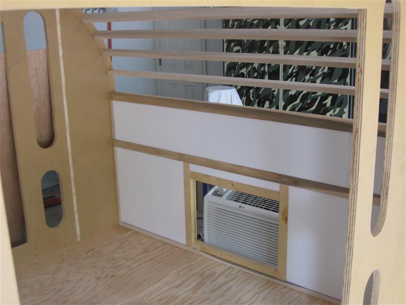

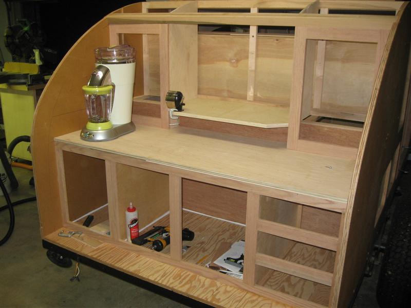

Postby kevingb » Mon Sep 19, 2011 10:41 am
Thanks Randy...
It fits like a glove.

Postby Ratkity » Mon Sep 19, 2011 11:51 am
Great work! That pencil sharpener sure does get around.. LOL
Hugs,
Ratkity
Ratkity
Posts: 1065
Postby aggie79 » Tue Sep 20, 2011 8:13 am
Kevin,
That margarita machine is a perfect fit! Are you going to match the colors for the exterior of your teardrop?
Of course I'm a little biased, but I like how you changed to the arched top doorway. I think it is one of those design elements that adds character.
How are you liking the cooler weather? The other night I was working outside and it felt a little chilly. When I checked the temperature, it was 82 degrees. I guess after the 100+ degrees weather we've been having, 82 is chilly - great building weather though.

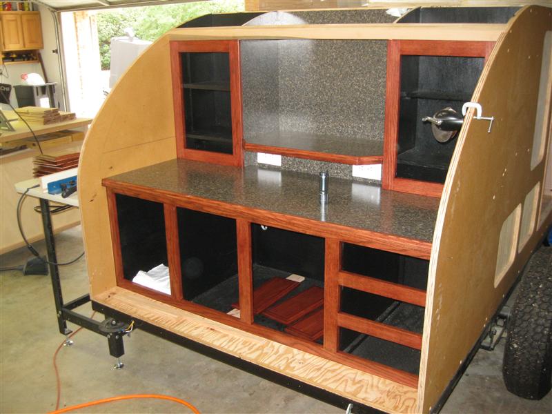

Postby kevingb » Wed Sep 21, 2011 12:01 am
Ratkity... after a few comments online and from friends, my daughter has turned the pencil sharpener into a where's Waldo deal. I keep telling her it's something you need to hide not a center piece. At least she is having fun and hanging with dad.
Tom... This is where I'm starting to get hate mail. We were/are/going/not going to paint instead of staining the wood. I started to assemble because of paint but now revisiting stain. I was messing around with transtint Monday and came up with a nice dark red mahogany. I don't know what to do.

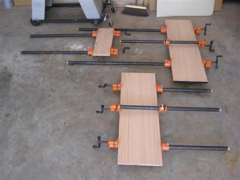

Postby kevingb » Wed Sep 28, 2011 4:28 pm
Thanks David...

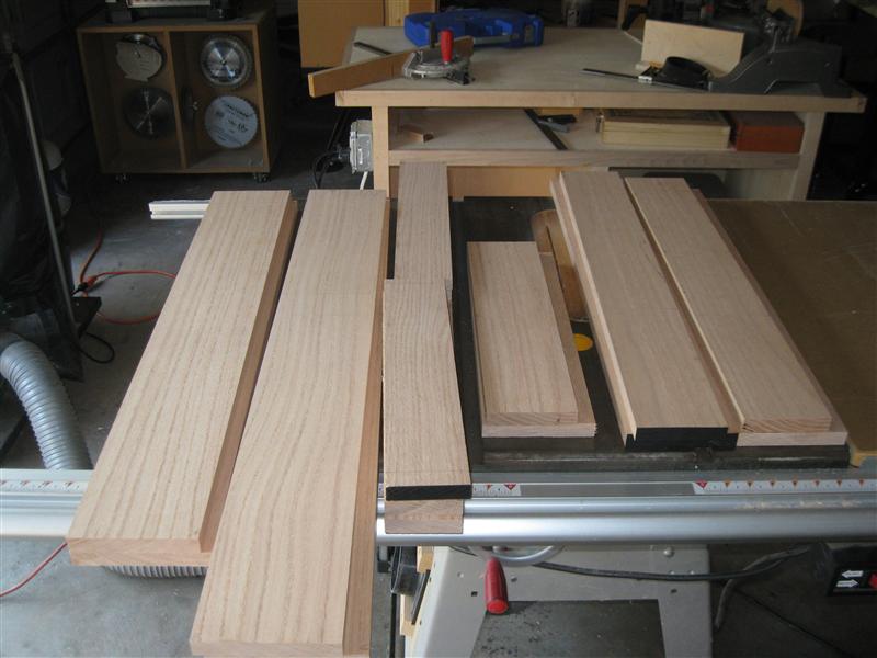

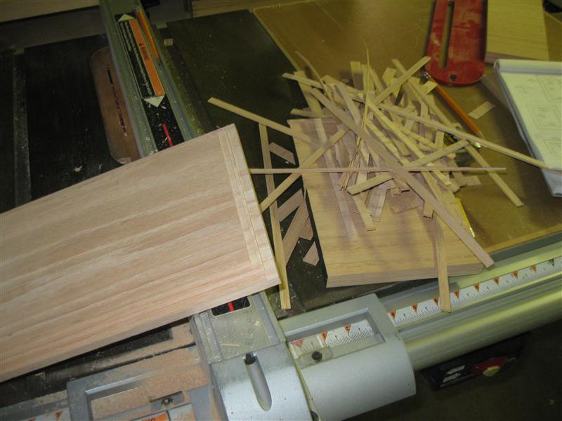

Working on my doors and drawers. I have really been dealing with burning on my cuts, time to sharpen. Little extra sanding after the routing that usually gets most of the burns once the doors are glued up.

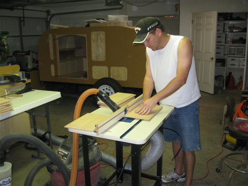

Now that the Rails and Stiles are machined, time to get the panels done. The bits I use were purchased from MLCS and have done hundreds of doors. They have been very reliable, just keep them clean and oiled. I usually just touch them up with Hone Knife before each use.
I have the wood cut for the panels, Although the pieces were wide enough to make a full panel, i went ahead and cut out to get a better grain pattern, plus this give me the opportunity to flip to prevent bowing in unstable environments.
Getting them glued up

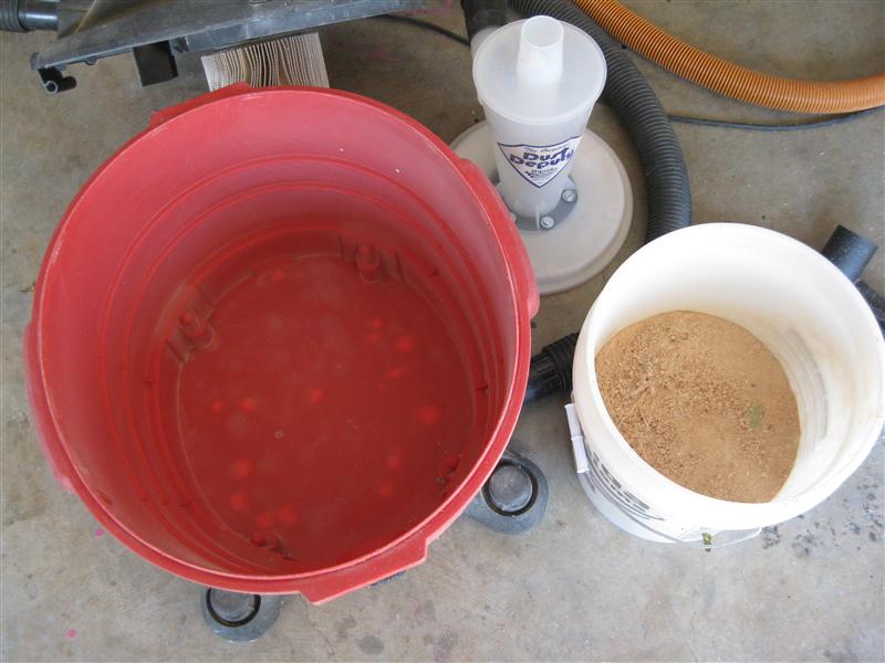

I was amazed how much dust the Dust Deputy removes. This was after all the cutting, routing, and sanding. They said 99% removal not 99.9999%. Just guessing didnt count each particle. lol

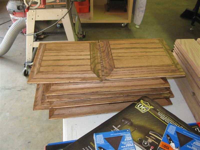

Picked out our stain. Using Dark Paste Wood Filler and General Finish Georgian Cherry Gel Stain. I spent a day working with transtint and just couldnt get it.

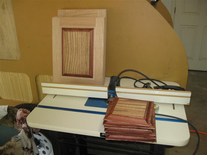

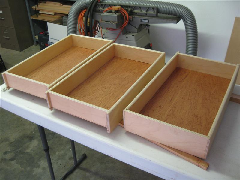

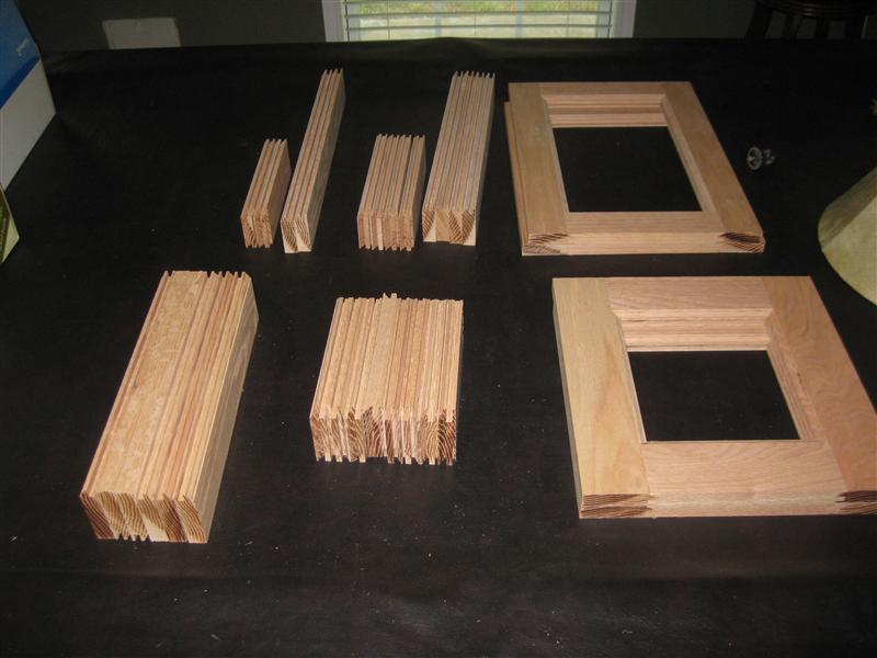

Postby kevingb » Mon Oct 10, 2011 11:05 am

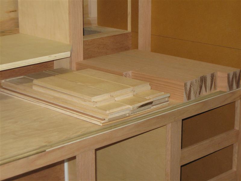

Starting to mill doors, Its a little extra work but like to cut away as much stock before milling panels... It pays off in the long run, look at all the stir sticks I have for the staining process.
Look Mom... No Dust... Its under control, need to work on static issues, although not that bad
Oak is ready available but I hate the Open Grain, to help with a smoother surface I use a dark paste grain filler
After the Grain Filler has dried and sanded
Door Assembly (11 doors) stain the edge before assembly prevents them unsightly panty lines when the wood expands. LOL. I have to mill the door edge before applying grain filler. Progress slowed down... YEAH RAIN!!!
I love watching the rain so moved to the drawer assembly, humidity doesnt effect drytime.
I have one more coat of stain before sealing on Galley...
