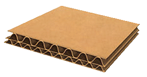

Here is a quick pic that I got off the Internet to show the differences between double wall and single wall cardboard.
Double wall (below)
Single wall (below)
Remember, you preferably want double wall. It is quite a bit stronger than single wall (and will keep the walls straighter).

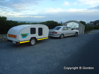

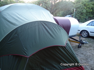

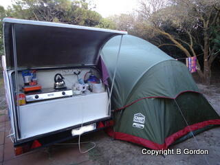

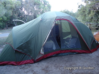

From another thread it seems that cardboard and fiberglass is discussed again. So I thought I would give you an update on the trailer.
Well, the trailer is holding up quite well. I have travelled more than 7000 km (about 4400 miles) with it in the last two years, and the fiberglass is still fine! After a good wash it still looks like new, although the hinges have started to rust. Luckily that is a quick fix.
Someone asked me about flex. Well, no part of the trailer flexes at all. And even though there are no spars in the trailer, it is strong enough that I could stand on it if I would have wanted.
Here is some of last year's (2011) photos. We travelled from Johannesburg to Cape Town in a roundabout trip.
