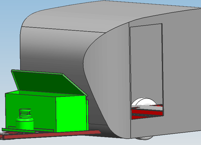

Cliff,
Yep, it would interfere with the drop down table I have built into the exterior wall. You can see that table in the print a few messages up... it's in red!
High Desert,
It affects the front storage first... it does effect the bed a little bit, but I suppose we could always turn around and put our feet down there. But if we start out with a 72" wide trailer, and a queen sized mattress is only 60", I'm betting we don't interfere with the bed at all.
Gary,
I am looking at a 72" wide design now... If I can see around the trailer, it'll certainly give me some much needed interior space. What do you think about the nose job?
Postby RAYVILLIAN » Sun Jan 09, 2011 2:22 pm
Mike On ours we went to a fullsize bed that is only 54" wide and ran it cross wise. The cabin is full width to the front of the cabin and the chisel nose is the tongue box. I think that is the way that the Ausi did it too but not sure.
Gary
111961Image
RAYVILLIAN
Posts: 1434
Images: 109
Location: Rayville MO
Postby mikeschn » Sun Jan 09, 2011 2:54 pm
For those of you who missed the question on the previous page, I have a situation.
If I round off the nose for aerodynamics, then I have to build a curved door. I don't really want to build a curved door. And moving the door is not an option.
Any ideas?

Postby mikeschn » Sun Jan 09, 2011 3:44 pm
I hear ya Bruce...
Okay, here it is... tongue box, plus maybe a tiny bit of the bed...

Postby mikeschn » Sun Jan 09, 2011 4:04 pm
Yep, that would be just like Arne's nose...
I can't see me doing the rocket nose!

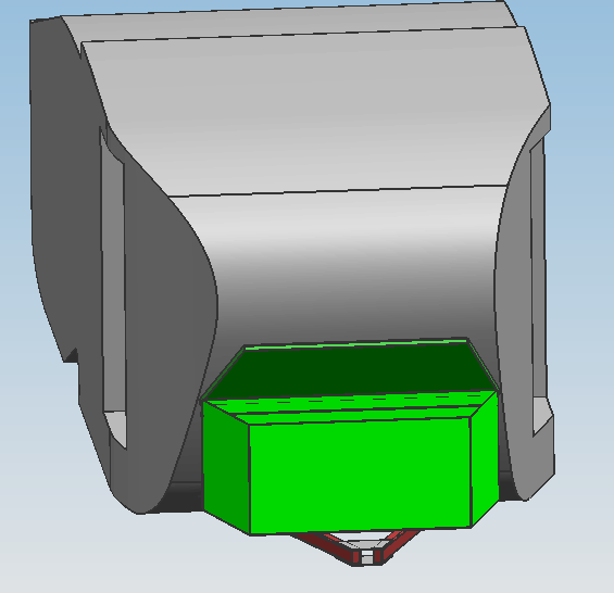

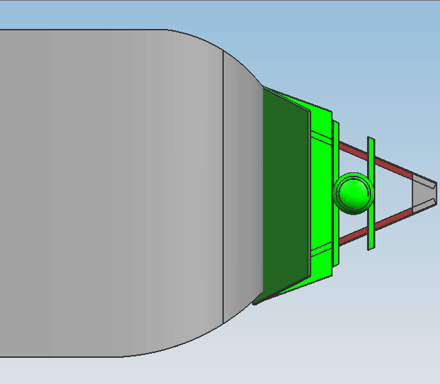

Postby starleen2 » Sun Jan 09, 2011 4:25 pm
Now for the remarks - Why would you spend so much time to making a front curve if you're just gonna put a Box in front of it? the bottom of the cure is just open space between it and the storage box. In the CAD drawing it looks much cleaner with out it. :thinking:
starleen2
5th Teardrop Club
Posts: 16272
Location: Pea Ridge ,AR
Postby mikeschn » Sun Jan 09, 2011 6:48 pm
The tongue box is an extension of the curve, or visa versa...
Mike...[/img]
