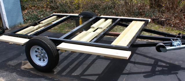

Postby Jim Edgerly » Wed Apr 20, 2011 7:48 am
This may not look like a lot of progress, however those of you that have followed my build know that I have been building my Shack in my basement over the winter, and that this is a sign of progress! My Shack is 5 feet wide, and my basement door is only 3 1/2 feet wide, which means building it using only screws so it can come totally apart to get it through the door and be reassembled with screws/glue in the driveway. I have reached the point of the build where it is time to start dismantling the Shack. The floor and two walls are now leaning against the basement wall, and I've got most of the internal pieces-parts stacked up and ready to be reinserted inside the Shack once the walls are up.The only thing left to do in the basement is to build some sliding doors for the forward clothes storage bump-out. That will be a "slide into place piece" so will not interfere with the rest of the reconstruction.
The weather in Massachusetts has not be very cooperative for working on the trailer (cold/rainy...typical NE spring). I'm getting a little done here and there, and it's getting close, but still a little more work before putting my Shack puzzle together on top of it.

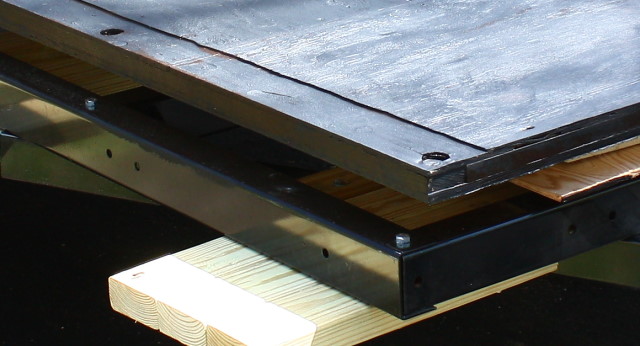

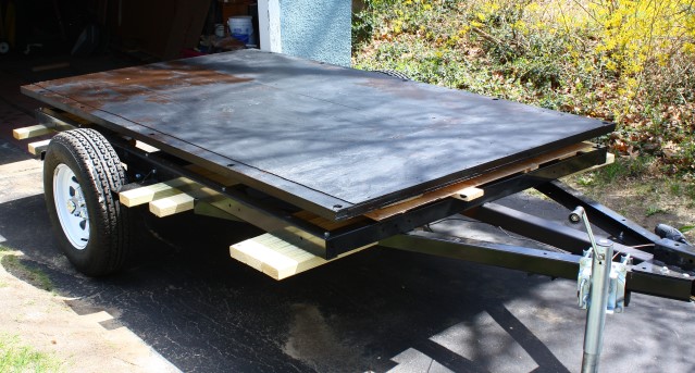

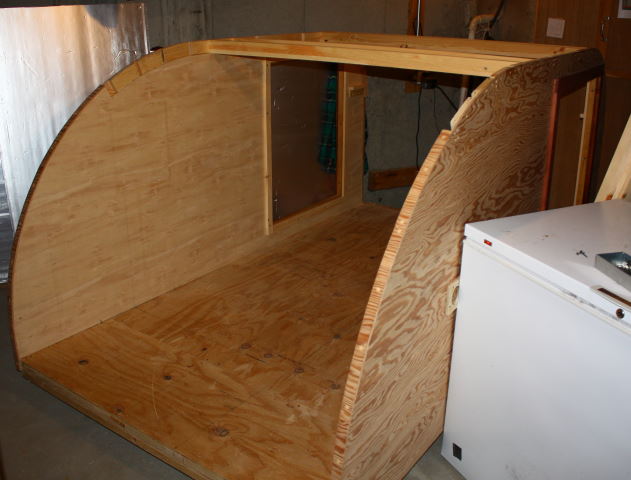

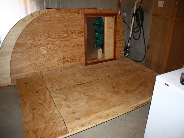

More progress to report. I have moved the floor out of the basement and into the garage. This last week I have been busy reassembling it, this time with plenty of glue and screws. You can see in the pictures below that I needed to make holes for the bolt heads to sit in once the floor is flipped over. I also needed to route off 1/16 inch along the sides because of the the C-channel frame. The edges needed to be reduced so the floor makes contact with the steel members across the width of the trailer.
I bought some "Black Beauty Fence Post Asphalt Fence Paint" to paint the bottom (recommended by more than one person somewhere in here). Says it's good to put on fence posts placed in direct contact with the ground. Well, after painting the bottom of the floor with a couple coats of this I have come to the conclusion that this is nothing more than slightly watered (oiled) down driveway sealer. It looks the same, it smells the same, it has the same consistency and stirs the same, it goes on brownish and dries black like driveway sealer...it even manages to get all over your hands and clothes the same way driveway sealer does. I put it on with a brush on the edges, and a roller on the flat. I've got 2 coats on already, and I have so much extra I will put on another coat or two before flipping the floor over and bolting it down. The only difference between this and driveway sealer is that this is a "specialty item" and therefor costs twice as much. My advice...if you want to go this route then buy driveway sealer for half the price!
The running boards are just sitting on the supports and will be shaped before bolting down.
I seriously had no idea it would be this much work when I started this project. It's been a lot of fun, but just lots more work than originally planned.

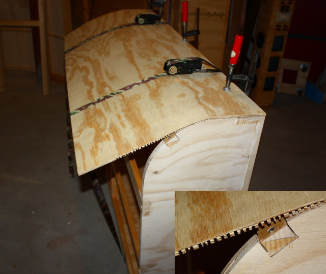

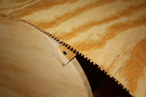

Time to skin the bump-out in plywood. Really tight radius here, about 7 inches. Trying to bend 1/4 inch plywood that tight without cutting kerfs would be impossible. Even cutting a lot of kerfs 2/3 of the way through I am worried about breaking the plywood so I am bending it a little bit at a time. I will go down tomorrow and tighten the straps a little bit more. If I don't seem to be making fast enough progress I will try wetting the plywood first, then tightening the straps.
As you may have guessed, still no word on the aluminum compensation. I got tired of waiting so I hammered out all the damage. It's just a matter of seeing if they will compensate me anything for the damage and my effort to fix their screw-up.

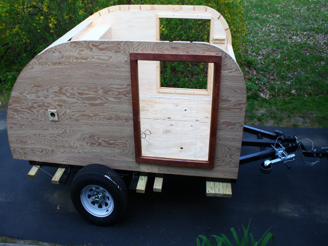

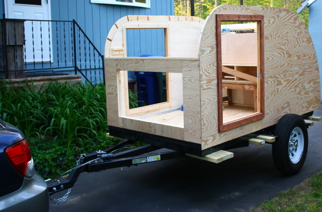

More progress is being made, though sporadic. I got a few pieces assembled last weekend. The weather has not been cooperating lately as it has been raining just about everyday I have a chance to work on the Shack (welcome to spring in NE). My garage is more crowded than my basement so work in there is near impossible. Yesterday I got so desperate to do something that I tried working in the garage. After a couple hours of the rain abating I dragged the lawn mower/bikes outside then dragged the Shack onto the driveway. Seriously, within 10 minutes it started to rain so everything got shoved back into the garage. Took lunch then worked on the Shack for a couple hours in the garage, while it was not raining. So, dragged the mower/bikes outside then the Shack. Again, it stated to rain within 10 minutes. So I looked skyward, said some choice words, and shoved everything back into the garage. The rain let up after 30 minutes or so, but I learned my lesson and did not drag the Shack back out. After a couple hours of lighter sky and no rain I determined the rain was done for the day, so AGAIN I dragged the mower/bikes outside then the Shack. Went back to the garage for my step ladder, and before I could unfold it by the camper...IT STARTED TO RAIN...seriously, within 60 seconds of bringing the Shack outside it started raining, after no rain for two hours! SHOVED everything back in the garage, closed the door, grabbed the dog and threw a rainy day movie into the DVR. Apparently, for some unknown reason, God did not want me working on the Shack yesterday. Will try again today.
