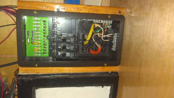

Sparks were flying today! Got the electrical hooked up and tested. So far nothing has exploded or burned down so I think that's a good sign.

I bought the same distribution panel, could you post a few more pictures of your AC installation. Inlet to panel?
Thanks :pictures:

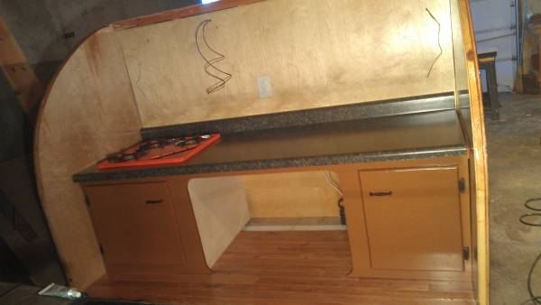

Got a little bit more done to the galley today.
Cabinet doors installed.

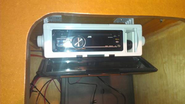

Stereo mounted.

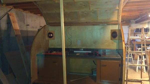

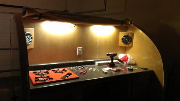

This past weekend we got a little more work done to the galley. Installed the speakers and hooked up the stereo.

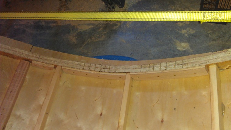

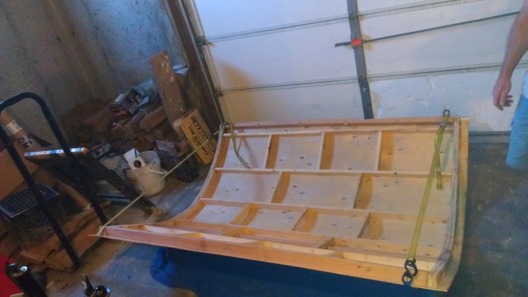

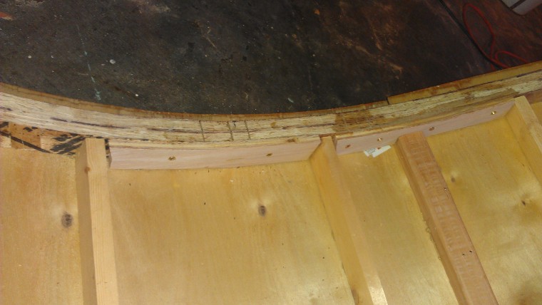

Our efforts to save the hatch from the dreaded spring back.
We made some cuts in the side ribs and strapped it to pull it back into shape.
Then glued and screwed some 1/2 plywood to the side ribs right where we made the cuts.
Hopefully it turns out. Tomorrow we'll see how it goes.

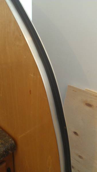

Well, after another long hiatus we got the hatch trimmed out and put on a seal. Tomorrow we drop off the camper at an upholstery shop to get the hatch covered with a boat cover type of material. We tried to salvage the original hatch and couldn't get it to work so we had to give up on it. Hopefully this method will work and we can get the camper finished this summer.

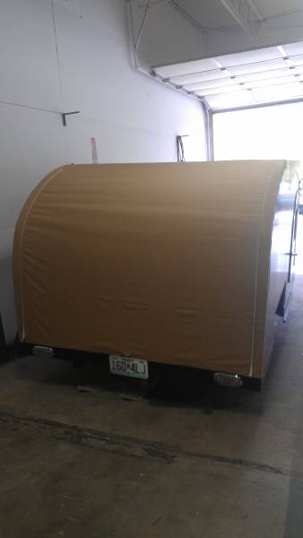

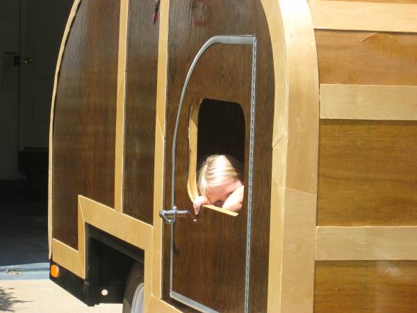

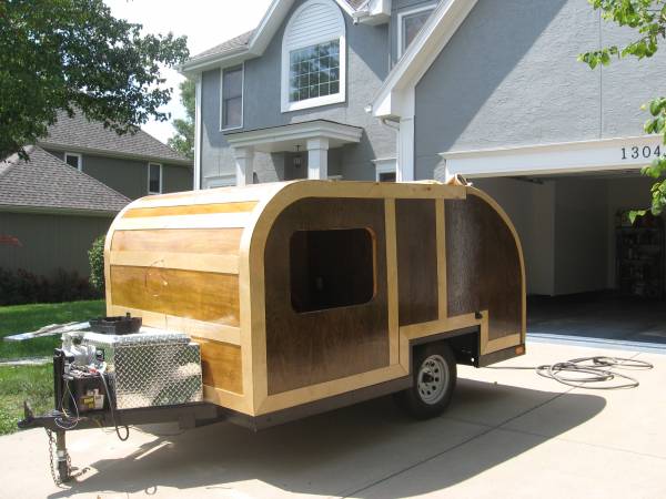

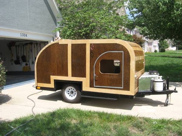

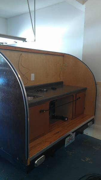

I finally got the hatch figured out. I had an upholstery shop in town wrap the back end in a boat covering.

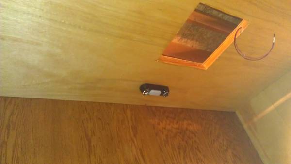

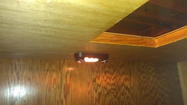

Hooked up the 2 LED light strips in the galley.

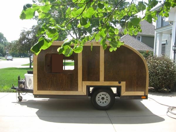

Driver side profile after trimming. I cut 1/4" birch plywood into 4" strips for the trim pieces and attached them with brads and thickened epoxy. Then I epoxied the trim to protect it from moisture.
The tongue box and battery box aren't attached...yet.
It's been quite a long journey, but it's almost over. The next steps are:
Polyurethane the exterior
Install windows
Install drip edge
Install fan
Install 2 exterior lights
Attach tongue box
Attach battery box
At that point it will be campable, but I can see how you might not ever feel like you're "done." There will always be something to do to make it better.
Should be ready to go the weekend after Labor Day!!
