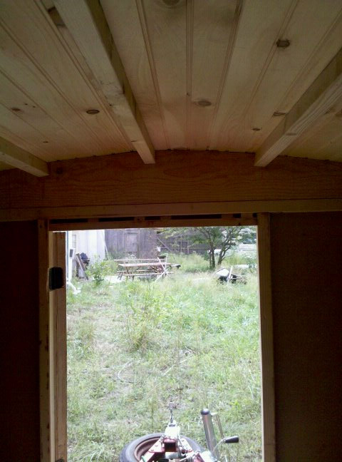

I decided to use 1x6 tongue and groove pine for the roof instead of plywood. Its just so much easier to do alone because each piece is so much lighter. I found a local lumberyard that had 10' lengths for $4.65 each. The roof went on pretty easily, although I wish I snapped a pic of it, 2 of the boards were an inch longer then the others so I was useing the front of the trailer to square it to try to keep it even and I looked at the backside and 2 of them stick out a little further then the rest by about an inch....next weekend I will cut them even.

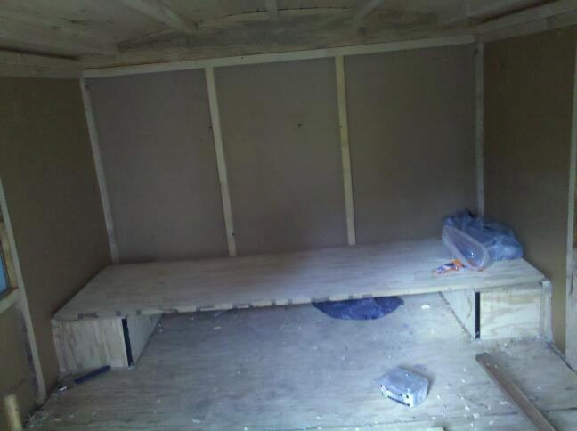

Image my bed platform is going to be wider then this but gives an idea of how the bed will look across the back. I have an idea to make the bed frame 3' wide with a 2nd piece of wood over it that will pull out another 18" to get my full 54" full sized mattress with storage underneath. Couch by day, bed by night.

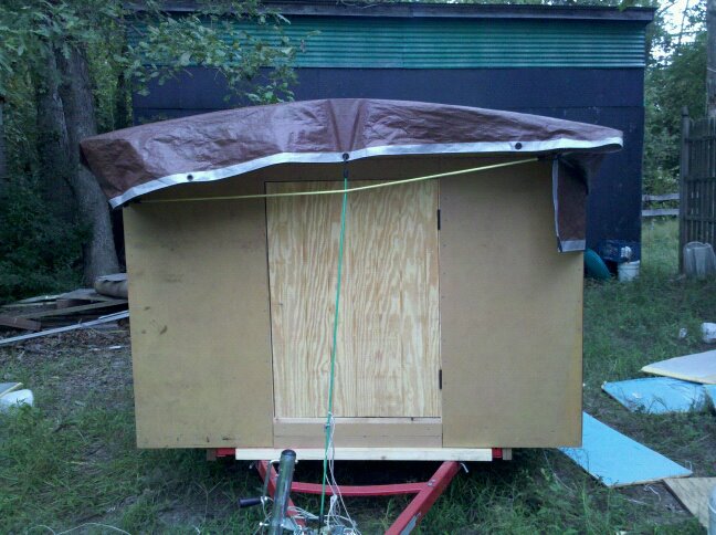

Image All covered for the rain.... bleh Image

You're moving along fast, as you did with the last one. Love the ceiling!
I look forward to more pictures and progress. :thumbsup: :applause:
Posts: 8871
Postby aggie79 » Mon Sep 12, 2011 8:41 am
Very nice Deryk!
I love the bead board plywood and the roof "beams". Looks great and is a very appropriate detail for a vardo.

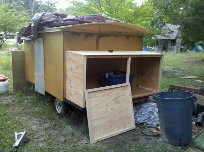

Well, never seem to get enough done lol. I started working on the Galley box, didnt make the shelves yet, but its 33" tall at the back, 31" at the front and 24" deep, 6 feet long. Should be able to hold enough kitchen stuff lol. I need to pick up the table I want and fit it in there before I start making shelves lol. Image The hinges are on, just need to get a slide bolt or 2 to keep them closed besides a lock.

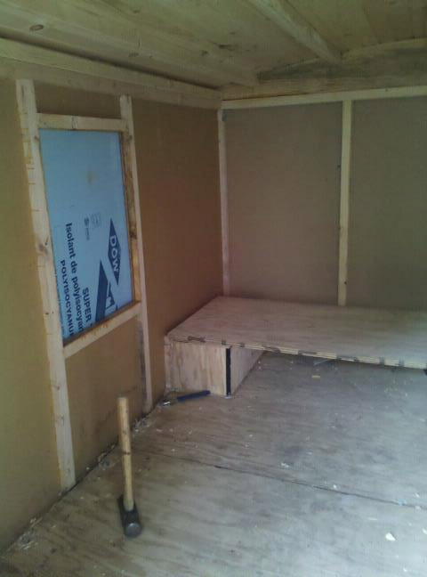

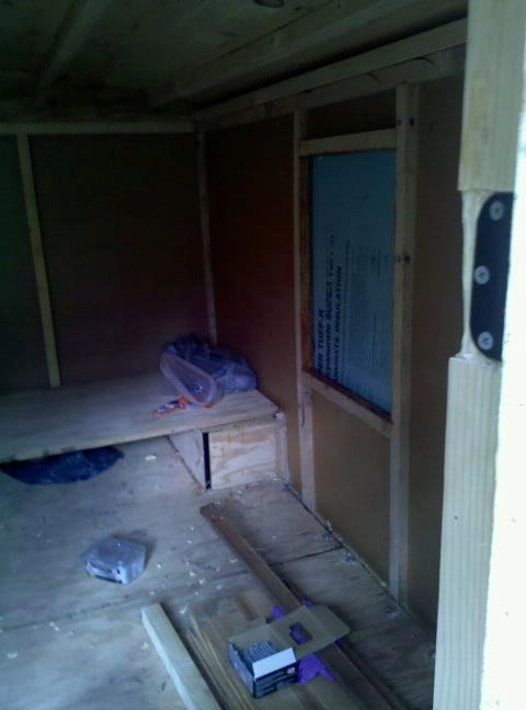

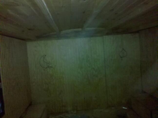

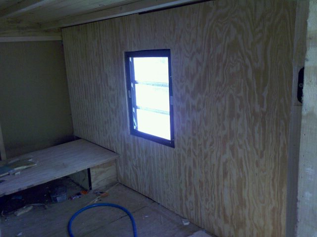

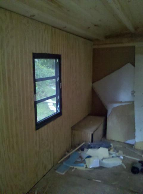

I started getting the inside done, I used ply bead board http://www.homedepot.com/Building-Mater ... ogId=10053 Cut them in half and put them over 1" of foam insulation and shot them in place. I was actually barely smart enough to remember to run wires for inside lights before I put the back panels in. Image Image Image
I think I need to redo the smaller back panel, was getting dark as I put it in and I see the seem where the panels join...if not could always cover it with trim. Still need to do the door side front wall, then trim out the inside, and varnish it. I got a gallon of spar varnish to do the inside and the underside of the outside roof. Then start building the bunk to go across the back wall. I need to take a run at some point to IKEA and check their damaged/used display stuff and look for a foam mattress.
Im thinking of makeing the bed be able to slide from say 3' to 4.5' so it could be like a couch if Im alone, or during the day, then pull out to the full 54" width. Im going to have some space under the bed for storeing clothes and the bed linen's when its folded like a couch.
