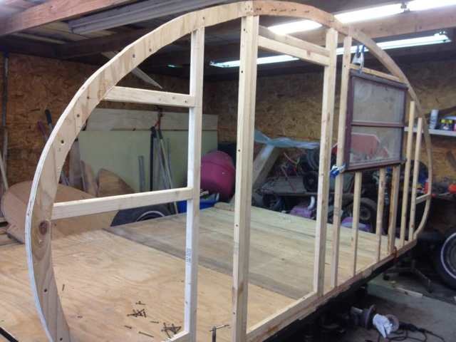

Postby Fishingtomatoseed » Wed Apr 25, 2012 8:14 pm

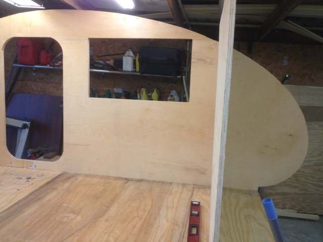

Thank you Tom.
I love working with kids on the project. They have a lot of fun helping build it.

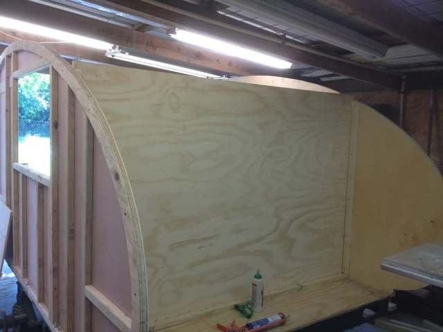

Well I have finished framing one wall and I had to stand it up to see what it would look like. I know it is on the wrong side but it looks good.

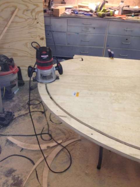

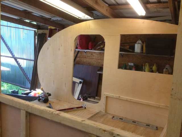

Postby Fishingtomatoseed » Wed May 02, 2012 7:27 pm
Got a little bit more done today. I have been gluing everything with the PL Premium construction adhesive and TB3. Using a bottom bearing 1/2" router bit to get it to shape. Used 1/4" bolts through the bottom of the wood frame and the metal tabs welded to the trailer. The other wall is weighted down and drying. Maybe tomorrow it will find its home.

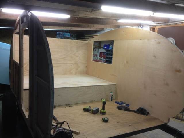

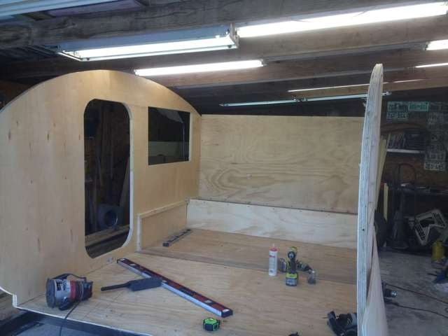

Postby Fishingtomatoseed » Sat May 05, 2012 8:39 pm

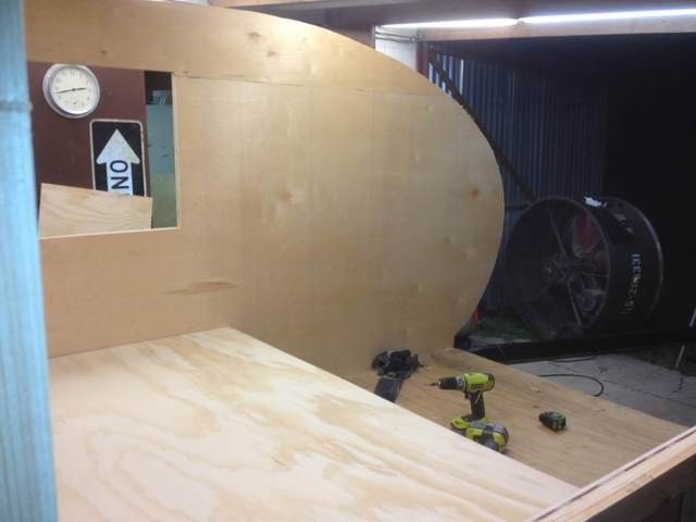

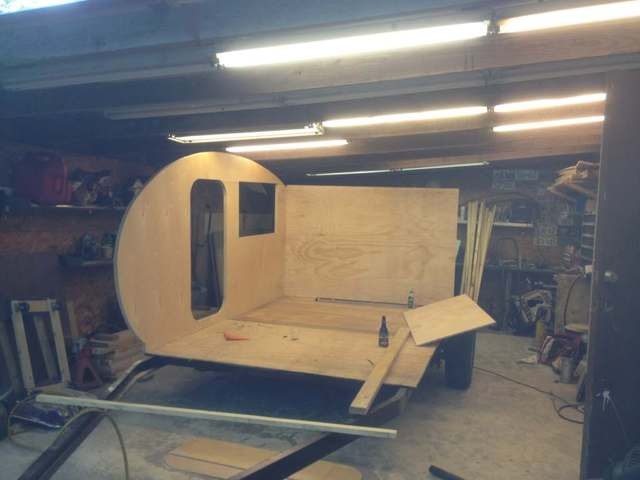

Did some more today. Got the other wall up and started on the full size bed. Had to take a brace off and that will remind you just how strong and tuff glueing things together is. It is amazing how strong that makes things. As you build things and attach them to the walls it is making the whole thing feel strong.

The 2+2 High Modified
Postby Fishingtomatoseed » Sat May 05, 2012 8:40 pm
More pics........

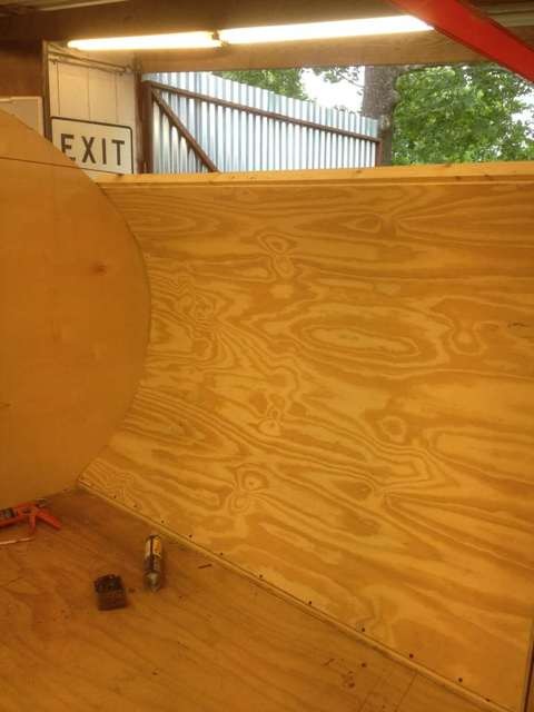

Postby Fishingtomatoseed » Sun May 06, 2012 6:05 pm

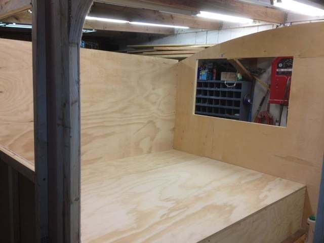

Little more done today. Went to church and then a potluck. Love spending time with friends. Dad and I got the first pice of ceiling on. Using 1/4 BC exterior plywood and it bends like a dream and of coarse PL Premium. Here are a few more pics.

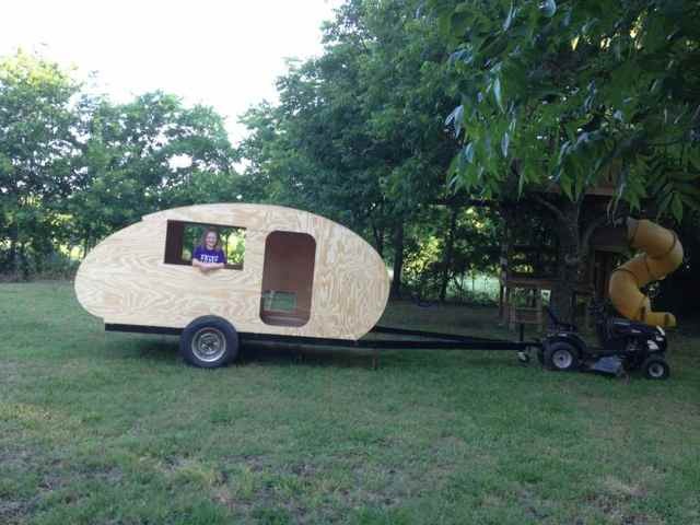

Postby Fishingtomatoseed » Sun May 20, 2012 7:05 am

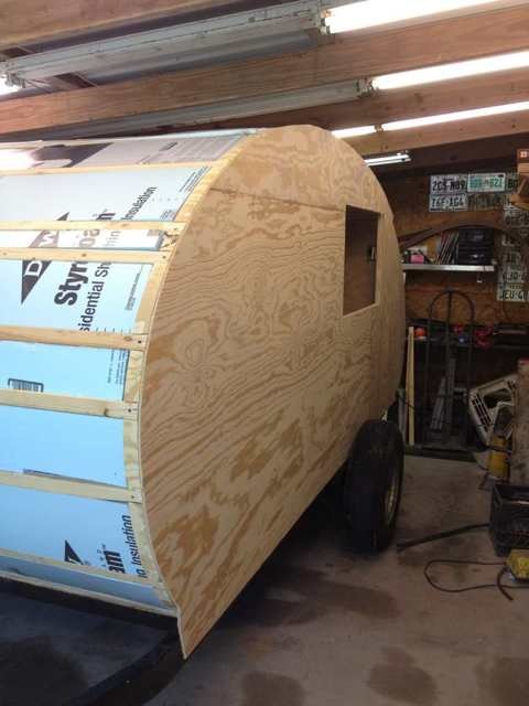

It's finally made it to the outside world. Not hidden away in the shop. Needed more head room today for its face lift of sides and hopefully the roof.
Fishingtomatoseed
Posts: 261
Images: 9
Joined: Sun Aug 21, 2011 4:47 pm
Location: North Texas

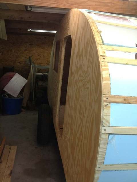

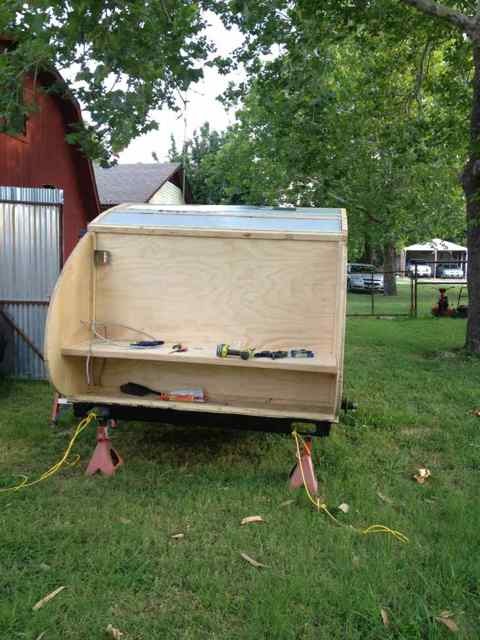

Postby Fishingtomatoseed » Sun May 20, 2012 3:46 pm
It didn't get it's roof. But the sides or on and I get to go get a new nail gun. The insides of my other gun came apart. Hopefully roof will get done during the week. All my goodies come in this next week also.

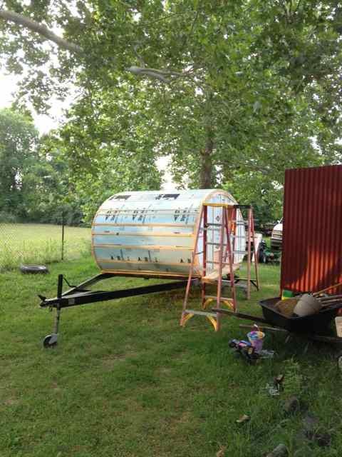

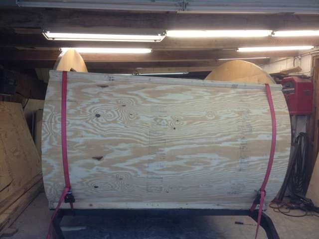

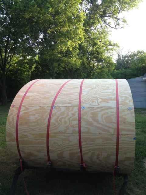

Postby Fishingtomatoseed » Wed May 23, 2012 7:32 pm
Well the roof plywood is on so it will be good and dry by the weekend. Now it is on to the hatch and door. The two things I have been dreading to do. Most of my goodies are here and the roofing material should be here tomorrow. Took it out for its first shake down trip in the back yard. Everything went good except ran out of gas in the tow vehicle. :lol: Hopefully get some more done this weekend.

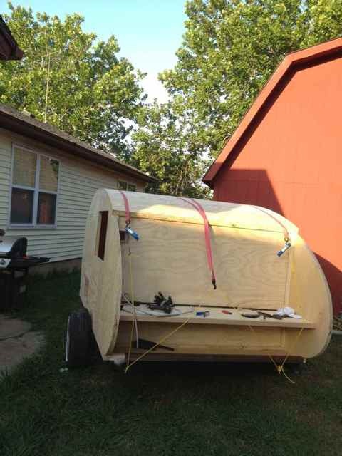

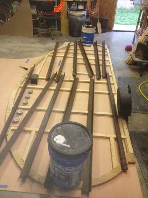

Postby Fishingtomatoseed » Thu May 24, 2012 9:10 pm

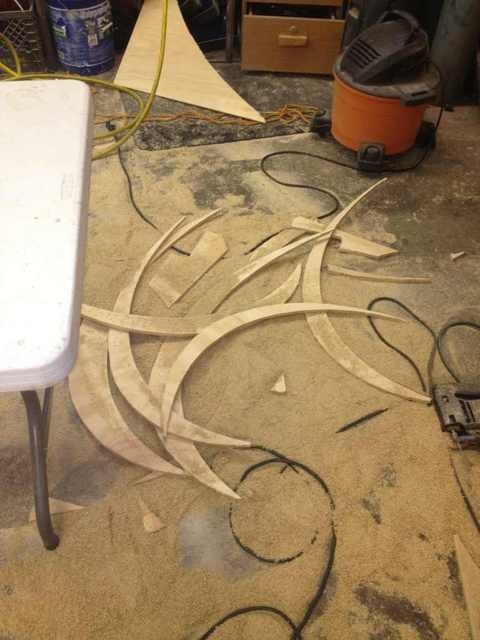

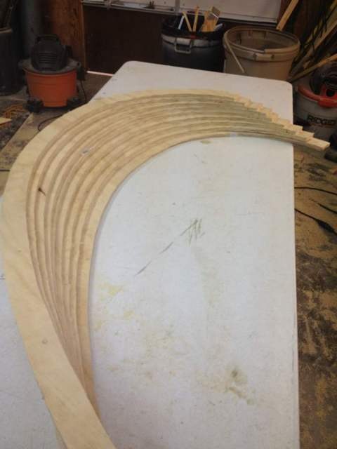

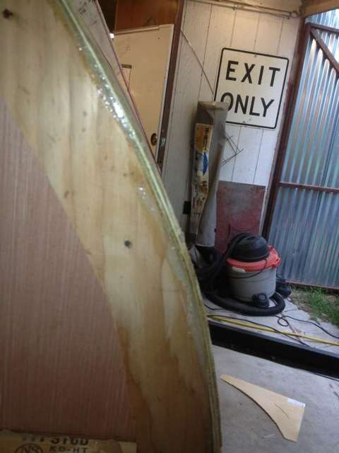

Got to work more on the trailer tonight. Took a 4x8 sheet of plywood and made a lot of sawdust and my hatch ribs.
Question to everyone. I am using the plastic hinge on this build. I was wondering what is the order to put things in. Roof ply, then hinge, then roofing material, then strip of metal for hinge reinforcement. Or does the hinge go on top of the roofing material?
For the ribs I took a templet of 1/4" hard board and marked it on to some cabinet grade 1/2" ply. Cut that out and smoothed out the cuts. Then used that to run the pattern bit around. Made 9 of them, doubled up on the ends then one every foot.
