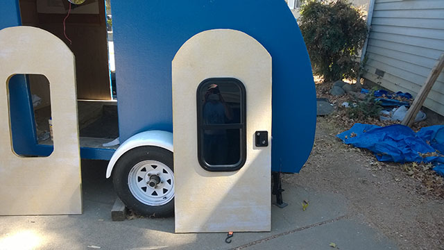

Spent my Labor Day weekend putting labor into the trailer :lol:
Was able to get my doors skinned with painters cloth. They came out smoother than the #12 duck I used for the cabin, but I think the duck will be stronger and last longer.
In the upper left, you can also see my first portal window installed.
A quick preview of what the doors will look like with vented windows and handles installed. Trim is on the way.
Finished framing and painting the lower section of the galley.
Added a swing out door that will hold a shelf for the camp stove.
